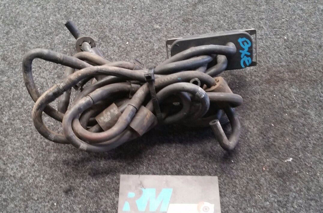

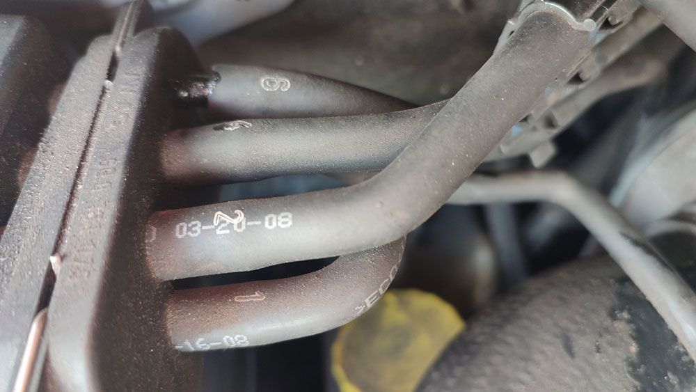

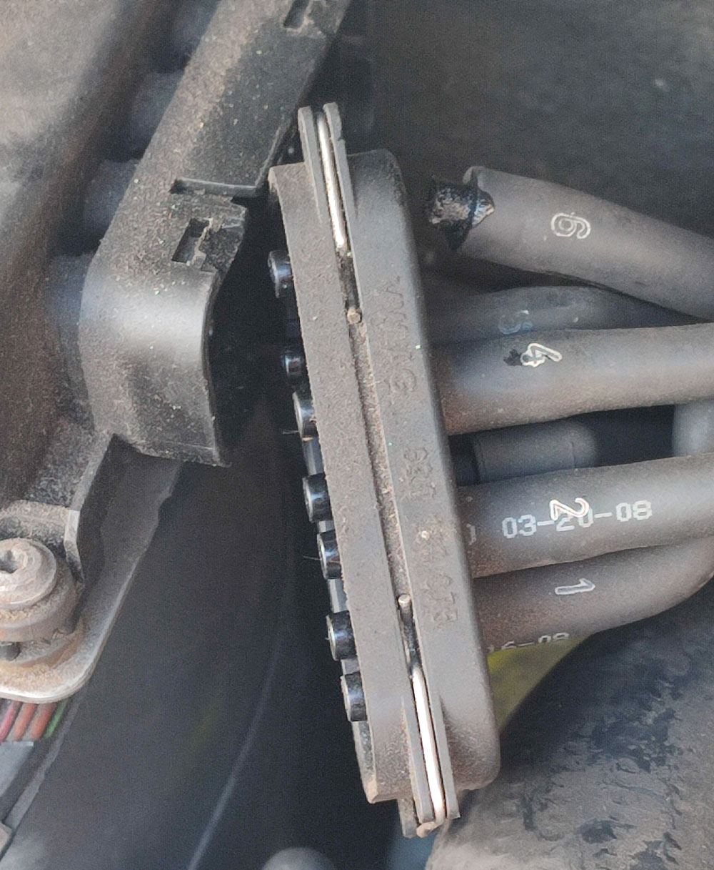

  4. Hi all, Recently my car has been going into limp mode under high load/revs at speed. This only started after a recent service. I returned it to the service garage who said an EGR fault code was showing. They claimed to have cleaned the EGR. After this it was ok for a day or two but the same issue reoccurred. Took it to another garage who couldn't find any faults. So I inspected t myself. This is what the solenoid vacuum block looked like See image 1 Hmmm, pipe 6 is not fully pressed in place. I touched this pipe and it broke the nipple off! See image 2 So I'm guessing some garage has done this. Anyways, I need to get it fixed. I have sourced a used part from Ebay - the cap with the 6 nipples and pipes already attached. Image 3. This part seems to be for a BXE engine but mine is a BSW. Not sure if this makes a difference. So I have 2 questions. 1. Is it ok to drive the car briefly with pipe 6 detached? 2. Is it easy to detach the pipes from the cap nipples? Assuming the part I have bought is correct, the easiest thing would be to pull the pipes off the existing cap and attach them to the replacement. But they look really well attached! I wouldn't want to damage them. Any advice appreciated. Jason
