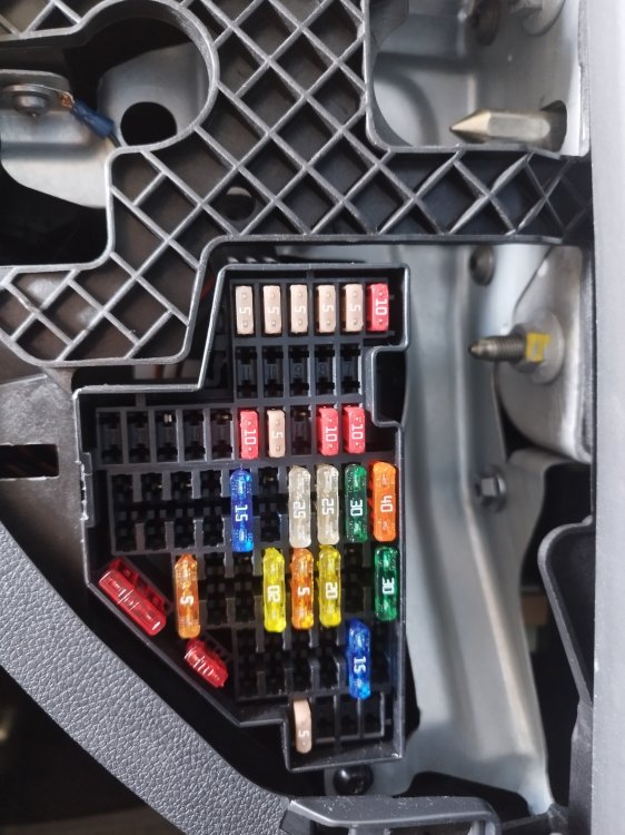

  5. Great, thanks for this. Nice to see fuse 39 actually listed! Where did you get it, if you don't mind me asking? Am I right in guessing that it's just a generic diagram for the later model MK2s? Where would I find info that is specific to my car?

  8. The battery is about 3 years old. Varta. Parasitic draw has always been an issue, though it took me a while to recognise it. When she bought the car it had a connector attached to the battery terminals - clearly a quick connector for a charger, but I failed to join the dots. We replaced the original battery soon after buying because it seemed weak. And if the car was left for a week or so it would be weak too. In the past month or so it's got to the point that it needs to be kept on charge overnight, and like I say it'll struggle to start with anything under 12.4v. So I'm 100% sure there is a parasitic draw - or at least was until I removed the alarm module. Good to know regarding the sleep thing - wasn't sure if it would go to sleep with a door open. Is there anywhere I can pick up a reference for the fuse layout on my car? I don't really trust it now, knowing the book is wrong.
  9. Spot on, that's great, thanks. Regarding the sleep...I haven't. Right now I'm just looking for anything that's drawing current with the car off/doing nothing. Fuse 39 is the only thing so far (other than alarm module, now removed). I think the next trick will be to rig up a remote fuse holder, so I can test it again with the car asleep, I think. And to investigate the instrument cluster and j527 superficially. I know the (starter) battery is goosed right now, but even with the alarm module out it's still dropping from 12.7 - 12.5v overnight...and just manages to start the car from 12.4v. The voltage drop is steady through the night, so whatever's drawing current is doing it constantly. Thanks a lot for the help so far!

  11. Pic of the fuse box as it stands;
  12. Hi all, Chasing parasitic draw on my partner's 2011 Octavia 1.4TSI. I've ruled out the alarm siren - removed it yesterday, and the battery had drizzled acid all over the PCB. Waiting to get a new one now. The draw still seems to exist, though maybe a bit better than before I took that out. I decided to measure voltage drop across the fuses. Found a couple at 0.2-0.3mV; normal safe range. And one fuse at 2.2mV (about 150mA of current, approximately). It's fuse #39, 5A (I've double checked the fuse numbering, as that's confusing). According to the card by the fuses, I should read the manual about fuse 39. According to the manual it is not assigned! So I guessed it wasn't supposed to be there at all and pulled it; the clocks went off (time reset etc). Now according to the manual, the fuse for the clocks should be #6. I pulled that one and it also causes the clocks to lose power. So how can I figure out what fuse 39 is up to?
