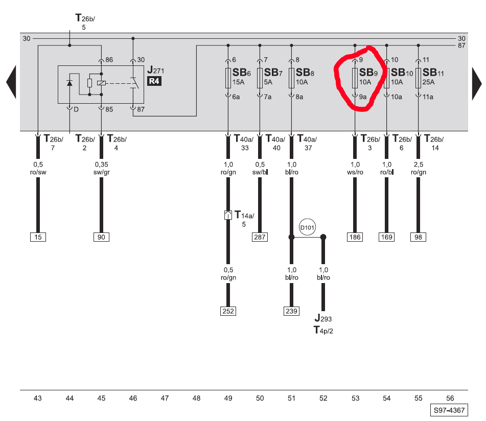

DonatasG
  1. No I have error P1072 NOx sensor heating
  2. Thank you. It was dead fuse. No controller receives power.
  3. I think I found it. Fuse SB9, am I correct?
  4. NOx controller does not receive 12V. 1. I cannot find fuse. Is it possible that only FL models has fuse for Oxygen and NOx controller? 2. Where is second end of ws/ro ? Cannot find any diagram... 😞
