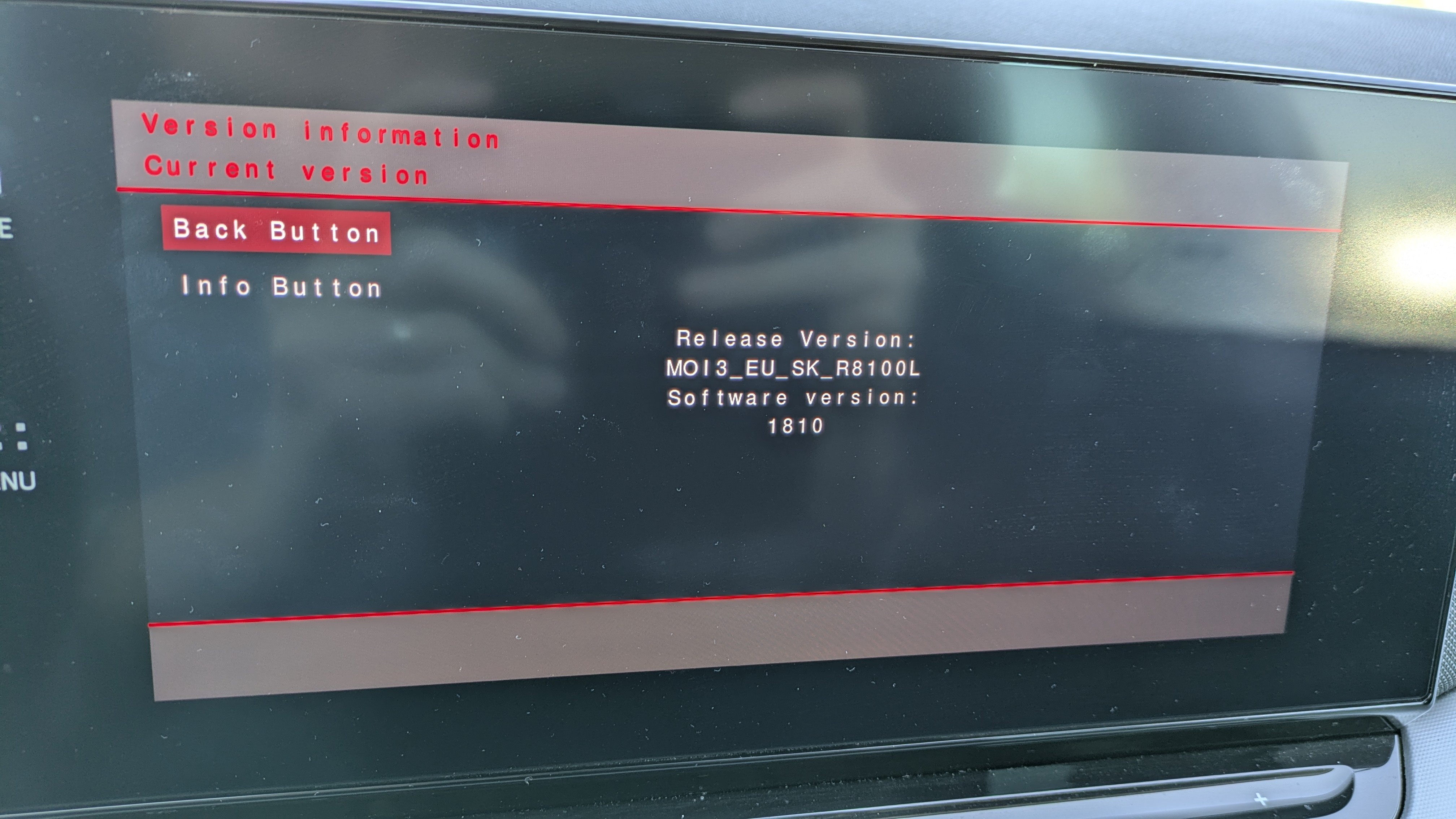

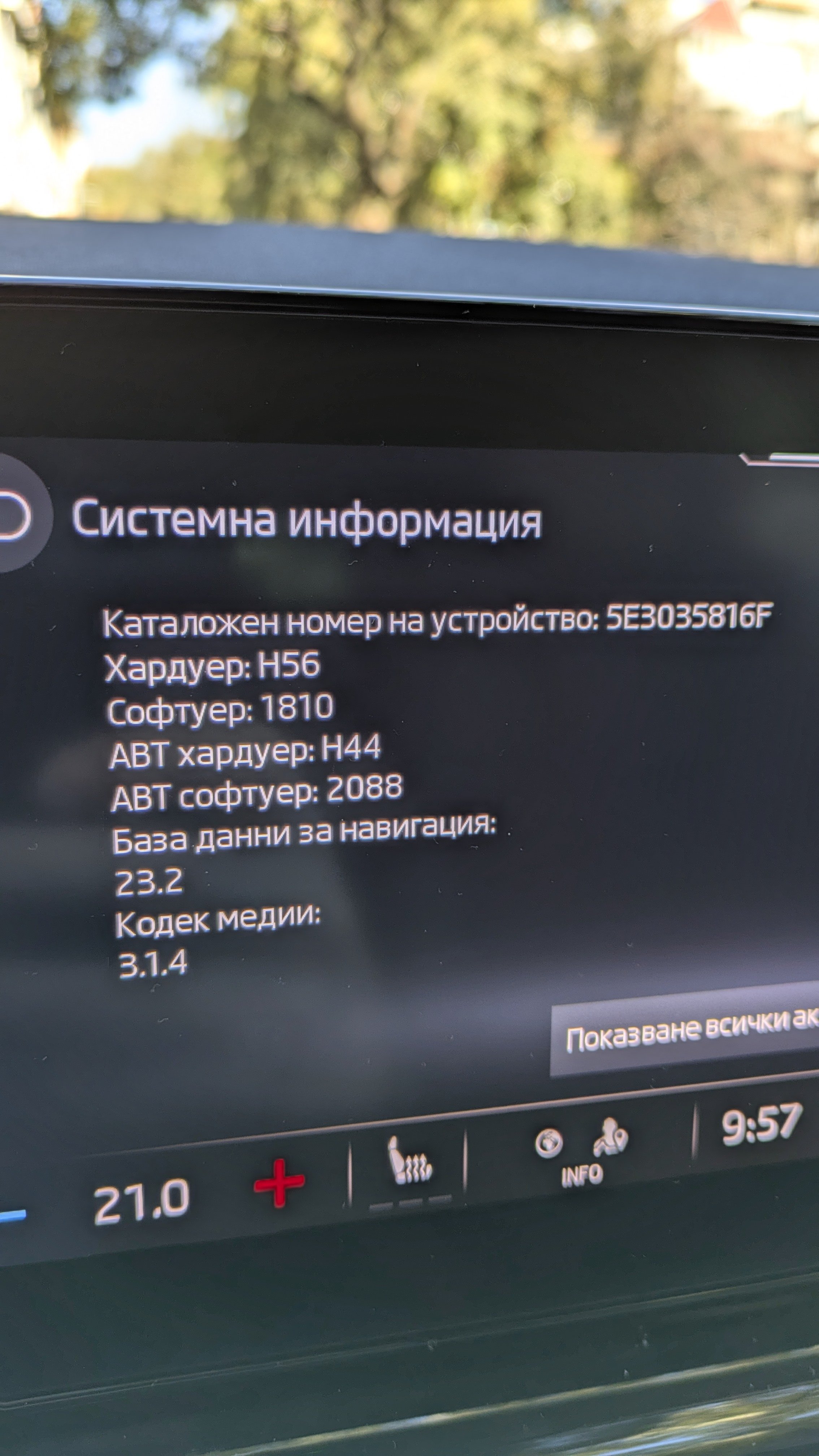

  1. Yeah, I was prepared to make the "Primary user" registration thing with the two keys, but that never started...
