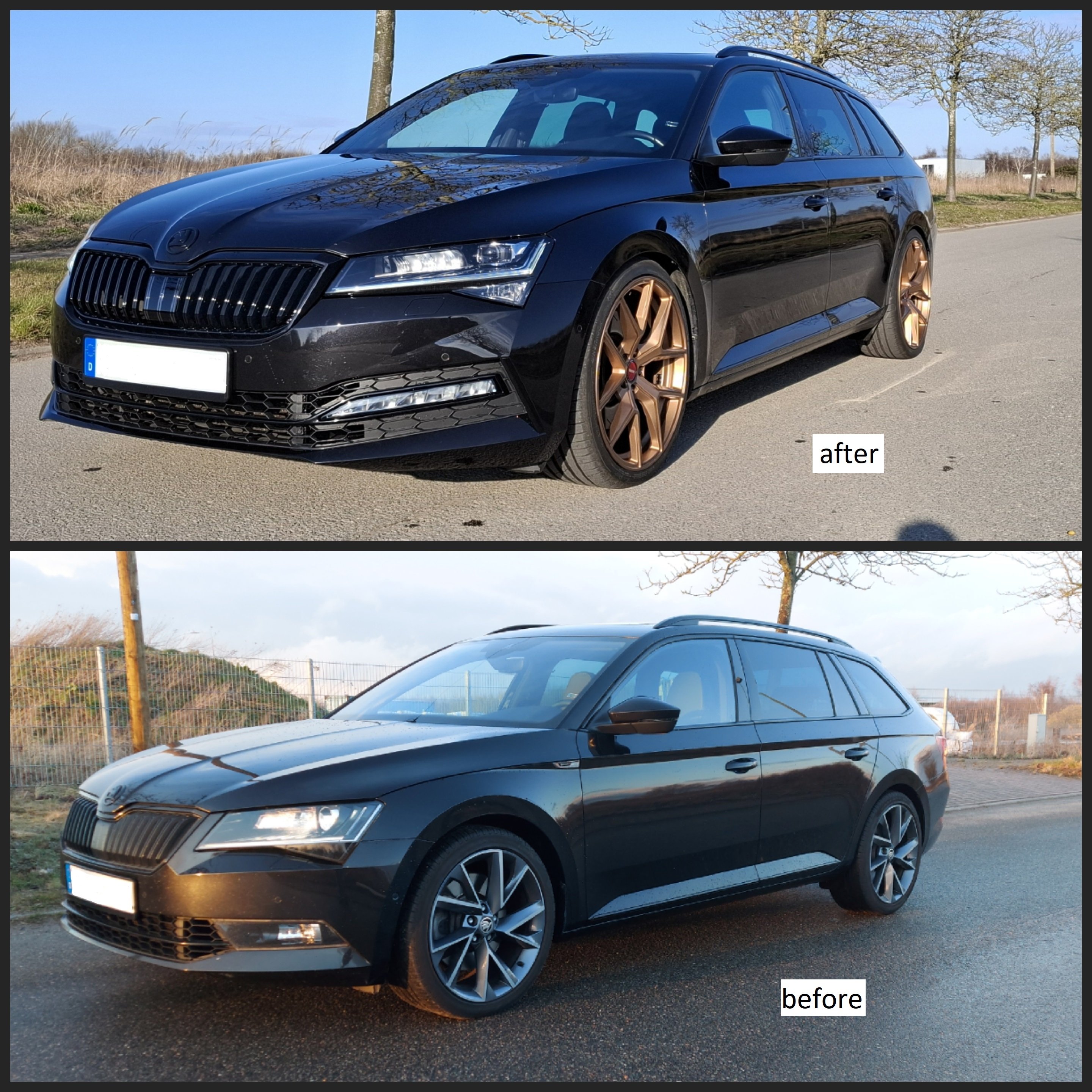

  2. No, the bonnet and fenders or wings are still the same. I only replaced the headlights, bumper and wheel archs. No further adjustments are necessary.
  3. I bought used headlights and a used bumper, trims and other small parts are all new and bought directly from Skoda. In total it was about 3500€.

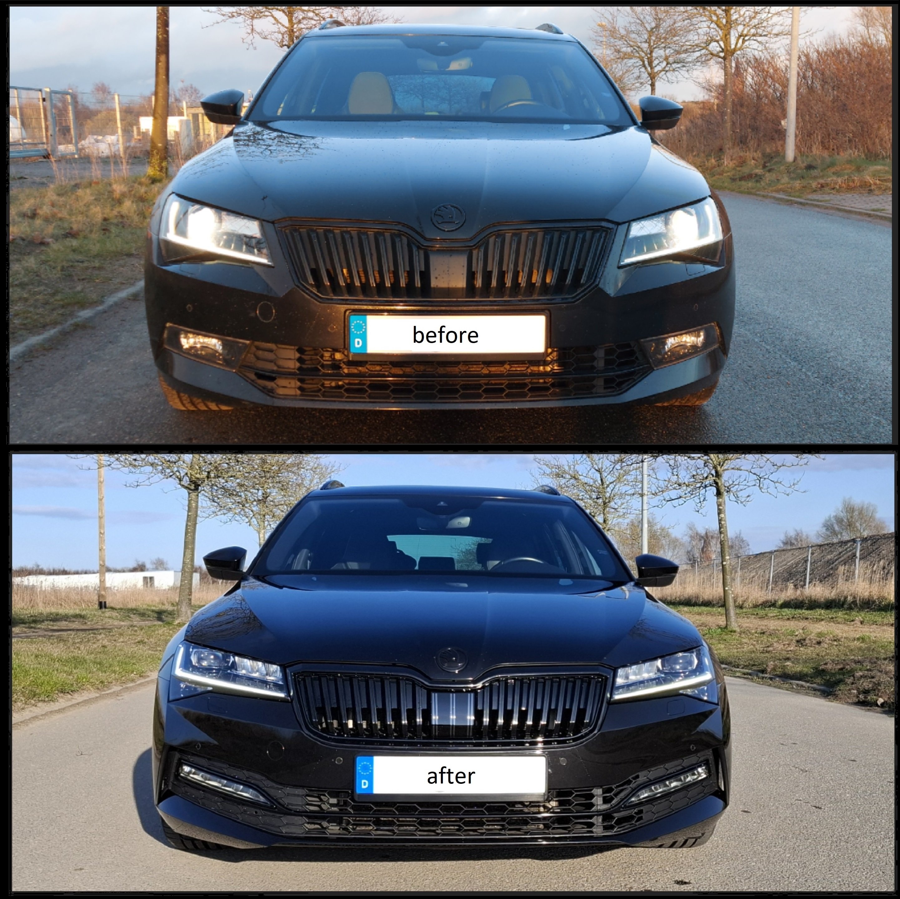

  4. Thank you @JR RS I also did the SLA retrofit according to your post. That was in 2023. The matrix retrofit resulted from a broken SLA headlight in 2024 and i like the facelift look 😃
  5. Hi guys, I converted the front of my Superb MK3 PreFacelift Sportline MY2017 to facelift MY2020 with LED matrix headlights and wanted to share my experiences. I have written a short guide for people who want to retrofit LED matrix headlights on a Prefacelift Skoda Superb. 1. Remove headlights and bumper 2. Headlights wiring the new headlights require a direct power supply from the fuse box (Pin 10 in the connector on the headlight), the old connector for the BiXenon headlights still fits and only needs to be adapted the existing pin 10 has to be removed, I put it in the free slot 8 so that the pin doesn't hang around uselessly Lay a new 2.5mm² cable from the fuse box to the headlights and insert it into pin 10 (a new pin is required) the left side is done quickly, here you only need about 50cm from the fuse box to the connector on the headlight right side is a bit more complex, I laid the cable behind the engine bay in the existing cable harness both are protected with 25A each I could not find the original pins from the fuse box, so I used universal fuse holders and connected them directly to the battery 3. Fog lights wiring the connectors (3D0973703) for the new LED fog lights is different and the old one must be replaced Pin 13 from the headlights becomes pin 3 on the fog lights, the old cables white/yellow becomes pin 1 left fog light, grey/green pin 1 right fog light and brown pin 2 left and right (ground) 4. install new headlights and bumper (Partlist for Sportline is attached -> all Trims black) 5. I have replaced 4B Multifunction Module from 3Q0907338 to 3Q0907338C, because I only have the data set for C Version the 4B can be found under the steering wheel. To access it, the knee airbag and the air duct must be removed (note: it is not necessary to unplug the knee airbag connector) 6. Once everything is assembled, you can start coding First activate D6 and D7 in 19 gateway, these are the control units of the new headlights I did this with VCDS -> connect to 19 -> select "installation list" -> check D6 and D7 -> save coding 7. Flash data set "superb_fcm_3q0907338c.zdc" with VCP to control unit 4B Multifunction Module (3Q0907338C) -> it is available in VCP Filemanager 8. Coding: 4B Multifunc. Module(3Q0907338C) Coding: 00000007090008F206003D13010000000000000000000000000000000000 - Byte 3 -> Hex 07 -> Bit0-1= 03 Verbau AFS,Light Control Plus Bit 2= 1 -> LED_Headlight,freigeschaltet - Byte 6 -> Hex 06 -> it is for headlight range adjustment - Byte 7 -> Hex F2 -> Bit 5= 1 Bit 7= 1 - Byte 9 -> Hex 00 - Byte 10 -> Hex 3D -> Bit 0= 1 Bit 1= 0 Bit 2= 1 Bit 3= 1 Bit 4= 1 Bit 5= 1 Bit 6= 0 mdf_activation,freigeschaltet Bit 7= 0 glw_activation,freigeschaltet - Byte 11 -> Hex 13 -> Bit 0= 1 Prädiktive Streckendaten,freigeschaltet Bit 1= 1 Kreuzungslicht mit Streckendaten,freigeschaltet Bit 4= 1 Matrix-head-lamp,freigeschaltet - Byte 12 -> Hex 01 -> Bit 0-2= 01 statisches Kurvenlicht,ECE R48 4B Adaptations IDE01996-SFT00041-Verbauliste Sollverbau-Lichtsteuerung links -> nein IDE01996-SFT00057-Verbauliste Sollverbau-Lichtsteuerung rechts -> nein IDE01996-SFT00214-Verbauliste Sollverbau-Lichtsteuerung links 2 -> ja IDE01996-SFT00215-Verbauliste Sollverbau-Lichtsteuerung rechts 2 -> ja IDE08418-Matrixscheinwerfer: Gesamtdimmung -> 100.8 % IDE13612-Matrixscheinwerfer: Lenkwinkel -> 9600.00 ° A5 Frt Sens. Drv. Assist (3QD980654) Coding: 020408020000040100222355C150A90098000E300080 - Byte 19 -> Hex 10 -> Bit 0-3= 00 FLA_Additional_High_Beam,no_Additional_High_Beam Bit 4-7= 30 FLA-Headinglight_type,LED_witch_variable_light_distribution - Byte 21 -> Hex 80 -> Bit 5-7= 80 AFS_coding_Light_Assist,Matrixbeam 09 Cent. Elect. (5Q0 937 084 CQ) Adaptations ENG141650-MAS13782-Fernlicht_assistent-Assistenzfahrlicht: Empfindlichkeit per BAP einstellbar -> vorhanden ENG141650-ENG141973-Fernlicht_assistent-Erweiterte_Fernlichtsteuerung -> AFS: FLA: Fernlicht (GLW:MDF) ENG141650-ENG116639-Fernlicht_assistent-Fernlichtassistent Reset -> aktiv ENG141650-ENG116637-Fernlicht_assistent-Menuesteuerung Fernlichtassistent -> vorhanden ENG141650-ENG116641-Fernlicht_assistent-Menuesteuerung Fernlichtassistent Werkseinstellung -> vorhanden ENG116936-ENG115873-Leuchte 0 BLK VL B36-Lasttyp 0 -> not activ ENG116937-ENG115892-Leuchte1BLK VRB20-Lasttyp 1 -> not activ ENG116938-ENG115910-Leuchte2SL VLB10-Lasttyp 2 -> not activ ENG116939-ENG115929-Leuchte3SL VRB21-Lasttyp 3 -> not activ ENG116940-ENG115948-Leuchte4TFL LB4-Lasttyp 4 -> not activ ENG116941-ENG115967-Leuchte5 TFL RB32-Lasttyp 5 -> not activ ENG116942-ENG115996-Leuchte6ABL LC5-Dimming Direction CD 6 -> maximize ENG116942-ENG116000-Leuchte6ABL LC5-Dimming Direction EF 6 -> maximize ENG116942-ENG116004-Leuchte6ABL LC5-Dimming Direction GH 6 -> maximize ENG116942-ENG115991-Leuchte6ABL LC5-Dimmwert AB 6 -> 127 ENG116942-ENG115995-Leuchte6ABL LC5-Dimmwert CD 6 -> 127 ENG116942-ENG115999-Leuchte6ABL LC5-Dimmwert EF 6 -> 0 ENG116942-ENG116003-Leuchte6ABL LC5-Dimmwert GH 6 -> 0 ENG116942-ENG115988-Leuchte6ABL LC5-Fehlerort mittleres Byte DTC-DFCC 6 -> 00 ENG116942-ENG116556-Leuchte6ABL LC5-Lampendefektbitposition 6 -> 00 ENG116942-ENG115986-Leuchte6ABL LC5-Lasttyp 6 -> 43 - allgemeine LED ENG116942-ENG115992-Leuchte6ABL LC5-Lichtansteuerung HD AB 6 -> Always ENG116942-ENG115989-Leuchte6ABL LC5-Lichtfunktion A 6 -> Versorgungsbedarf der LCM Module ENG116942-ENG115990-Leuchte6ABL LC5-Lichtfunktion B 6 -> not activ ENG116942-ENG115993-Leuchte6ABL LC5-Lichtfunktion C 6 -> Standlicht allgemein (Schlusslicht: Positionslicht: Begrenzungslicht) ENG116942-ENG115994-Leuchte6ABL LC5-Lichtfunktion D 6 -> Parklicht links (beidseitiges Parklicht aktiviert li & re) ENG116943-ENG116015-Leuchte7ABL RB1-Dimming Direction CD 7 -> maximize ENG116943-ENG116019-Leuchte7ABL RB1-Dimming Direction EF 7 -> maximize ENG116943-ENG116023-Leuchte7ABL RB1-Dimming Direction GH 7 -> maximize ENG116943-ENG116010-Leuchte7ABL RB1-Dimmwert AB 7 -> 127 ENG116943-ENG116014-Leuchte7ABL RB1-Dimmwert CD 7 -> 127 ENG116943-ENG116018-Leuchte7ABL RB1-Dimmwert EF 7 -> 0 ENG116943-ENG116022-Leuchte7ABL RB1-Dimmwert GH 7 -> 0 ENG116943-ENG116007-Leuchte7ABL RB1-Fehlerort mittleres Byte DTC-DFCC 7 -> 00 ENG116943-ENG116557-Leuchte7ABL RB1-Lampendefektbitposition 7 -> 00 ENG116943-ENG116005-Leuchte7ABL RB1-Lasttyp 7 -> 43 - allgemeine LED ENG116943-ENG116011-Leuchte7ABL RB1-Lichtansteuerung HD AB 7 -> Always ENG116943-ENG116008-Leuchte7ABL RB1-Lichtfunktion A 7 -> Versorgungsbedarf der LCM Module ENG116943-ENG116009-Leuchte7ABL RB1-Lichtfunktion B 7 -> not activ ENG116943-ENG116012-Leuchte7ABL RB1-Lichtfunktion C 7 -> Standlicht allgemein (Schlusslicht: Positionslicht: Begrenzungslicht) ENG116943-ENG116013-Leuchte7ABL RB1-Lichtfunktion D 7 -> Parklicht rechts ENG116948-ENG116110-Leuchte12NL LB45-Dimming Direction CD 12 -> maximize ENG116948-ENG116114-Leuchte12NL LB45-Dimming Direction EF 12 -> maximize ENG116948-ENG116118-Leuchte12NL LB45-Dimming Direction GH 12 -> maximize ENG116948-ENG116105-Leuchte12NL LB45-Dimmwert AB 12 -> 100 ENG116948-ENG116109-Leuchte12NL LB45-Dimmwert CD 12 -> 0 ENG116948-ENG116113-Leuchte12NL LB45-Dimmwert EF 12 -> 0 ENG116948-ENG116117-Leuchte12NL LB45-Dimmwert GH 12 -> 0 ENG116948-ENG116102-Leuchte12NL LB45-Fehlerort mittleres Byte DTC-DFCC 12 -> 00 ENG116948-ENG116562-Leuchte12NL LB45-Lampendefektbitposition 12 -> 00 ENG116948-ENG116100-Leuchte12NL LB45-Lasttyp 12 -> 4 - LED Tagfahrlichtmodul Signal ENG116948-ENG116106-Leuchte12NL LB45-Lichtansteuerung HD AB 12 -> Always ENG116948-ENG116103-Leuchte12NL LB45-Lichtfunktion A 12 -> Nebellicht links ENG116948-ENG116104-Leuchte12NL LB45-Lichtfunktion B 12 -> Abbiegelicht links ENG116949-ENG116129-Leuchte13NL RB5-Dimming Direction CD 13 -> maximize ENG116949-ENG116133-Leuchte13NL RB5-Dimming Direction EF 13 -> maximize ENG116949-ENG116137-Leuchte13NL RB5-Dimming Direction GH 13 -> maximize ENG116949-ENG116124-Leuchte13NL RB5-Dimmwert AB 13 -> 100 ENG116949-ENG116128-Leuchte13NL RB5-Dimmwert CD 13 -> 0 ENG116949-ENG116132-Leuchte13NL RB5-Dimmwert EF 13 -> 0 ENG116949-ENG116136-Leuchte13NL RB5-Dimmwert GH 13 -> 0 ENG116949-ENG116121-Leuchte13NL RB5-Fehlerort mittleres Byte DTC-DFCC 13 -> 00 ENG116949-ENG116563-Leuchte13NL RB5-Lampendefektbitposition 13 -> 00 ENG116949-ENG116119-Leuchte13NL RB5-Lasttyp 13 -> 4 - LED Tagfahrlichtmodul Signal ENG116949-ENG116125-Leuchte13NL RB5-Lichtansteuerung HD AB 13 -> Always ENG116949-ENG116122-Leuchte13NL RB5-Lichtfunktion A 13 -> Nebellicht rechts ENG116949-ENG116123-Leuchte13NL RB5-Lichtfunktion B 13 -> Abbiegelicht rechts ENG116952-ENG116186-Leuchte16BLK SLB35BLK SL KC9-Dimming Direction CD 16 -> maximize ENG116952-ENG116190-Leuchte16BLK SLB35BLK SL KC9-Dimming Direction EF 16 -> maximize ENG116952-ENG116194-Leuchte16BLK SLB35BLK SL KC9-Dimming Direction GH 16 -> maximize ENG116952-ENG116181-Leuchte16BLK SLB35BLK SL KC9-Dimmwert AB 16 -> 127 ENG116952-ENG116185-Leuchte16BLK SLB35BLK SL KC9-Dimmwert CD 16 -> 0 ENG116952-ENG116189-Leuchte16BLK SLB35BLK SL KC9-Dimmwert EF 16 -> 0 ENG116952-ENG116193-Leuchte16BLK SLB35BLK SL KC9-Dimmwert GH 16 -> 0 ENG116952-ENG116178-Leuchte16BLK SLB35BLK SL KC9-Fehlerort mittleres Byte DTC-DFCC 16 -> 00 ENG116952-ENG116567-Leuchte16BLK SLB35BLK SL KC9-Lampendefektbitposition 16 -> 00 ENG116952-ENG116176-Leuchte16BLK SLB35BLK SL KC9-Lasttyp 16 -> 1 - LED Tagfahrlichtmodul Versorgung ENG116952-ENG116182-Leuchte16BLK SLB35BLK SL KC9-Lichtansteuerung HD AB 16 -> Always ENG116952-ENG116179-Leuchte16BLK SLB35BLK SL KC9-Lichtfunktion A 16 -> Nebellicht links ENG116952-ENG116180-Leuchte16BLK SLB35BLK SL KC9-Lichtfunktion B 16 -> Abbiegelicht links ENG116953-ENG116205-Leuchte17TFL R BLK SRB3TFL R BLK SR KC3-Dimming Direction CD 17 -> maximize ENG116953-ENG116209-Leuchte17TFL R BLK SRB3TFL R BLK SR KC3-Dimming Direction EF 17 -> maximize ENG116953-ENG116213-Leuchte17TFL R BLK SRB3TFL R BLK SR KC3-Dimming Direction GH 17 -> maximize ENG116953-ENG116200-Leuchte17TFL R BLK SRB3TFL R BLK SR KC3-Dimmwert AB 17 -> 127 ENG116953-ENG116204-Leuchte17TFL R BLK SRB3TFL R BLK SR KC3-Dimmwert CD 17 -> 0 ENG116953-ENG116208-Leuchte17TFL R BLK SRB3TFL R BLK SR KC3-Dimmwert EF 17 -> 0 ENG116953-ENG116212-Leuchte17TFL R BLK SRB3TFL R BLK SR KC3-Dimmwert GH 17 -> 0 ENG116953-ENG116197-Leuchte17TFL R BLK SRB3TFL R BLK SR KC3-Fehlerort mittleres Byte DTC-DFCC 17 -> 00 ENG116953-ENG116568-Leuchte17TFL R BLK SRB3TFL R BLK SR KC3-Lampendefektbitposition 17 -> 00 ENG116953-ENG116195-Leuchte17TFL R BLK SRB3TFL R BLK SR KC3-Lasttyp 17 -> 1 - LED Tagfahrlichtmodul Versorgung ENG116953-ENG116201-Leuchte17TFL R BLK SRB3TFL R BLK SR KC3-Lichtansteuerung HD AB 17 -> Always ENG116953-ENG116198-Leuchte17TFL R BLK SRB3TFL R BLK SR KC3-Lichtfunktion A 17 -> Nebellicht rechts ENG116953-ENG116569-Leuchte17TFL R BLK SRB3TFL R BLK SR KC3-Lichtfunktion B 17 -> Abbiegelicht rechts 9. After coding, the basic setting of the headlights and matrix high beam must be made i used VCP for this-> - switch on low beam - connect to 4B - go to basic settings - go to "basic headlamp setting" and press start, adjust the headlamps to the correct height, then press stop - now go to "Acknowledge basic setting" press start, wait a moment then press stop - switch to Position "0" or "parking light" (low beam must be off) - go to "matrix light, calibration" -> set "calibrate" for left and right - now a reference light can be seen - it must be measured with headlight adjusting unit VAS621001 or Maha MLT3000 Matrix high beam calibration mode -> note the angles - Stop calibration and go to "Offset calculation matrix light" -> set "cablibrate offset" for both headlights - Keep vertical at 0, enter angles for horizontal -> press start, wait a moment and press stop - delete fault codes - finished For the Headlight washer cylinder you need a 10mm connector (1J0955665E), a short piece of 10mm hose and a pipe connector 10mm/6mm to connect it to the old washerhose. Everything works very well and the matrix light is really great, i love it
