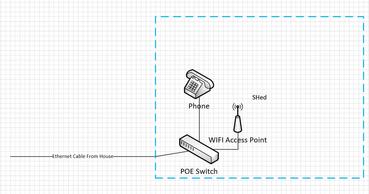

  1. If i were setting up another home office i would be looking ot do something like the below So Ethernet cable from house to switch Switch then has the Wireless Access point and phone plugged in you can then if needed plug anything else in, like a laptop or desktop with out using the Wifi if you wanted to a cable connection will normally be a much faster and reliable connection to Wifi a switch like this you want to make sure its a gigabit switch these days as they have a higher transfer speed for the connection https://www.amazon.co.uk/NETGEAR-Ethernet-Unmanaged-Internet-Splitter/dp/B07PYSNSDD/ref=sr_1_1?keywords=gigabit+switch&qid=1676592064&refinements=p_89%3ANETGEAR&rnid=1632651031&s=computers&sprefix=giga%2Caps%2C93&sr=1-1 Wireless access point like this https://www.amazon.co.uk/NETGEAR-EX6410-100UKS-AC1900-Wi-Fi-Extender/dp/B07NY41HW1/ref=sr_1_26?keywords=wireless+access+point&qid=1676592163&refinements=p_89%3ANETGEAR&rnid=1632651031&s=computers&sprefix=wirless+%2Ccomputers%2C78&sr=1-26 How fast is your Broadband in the house as depending on the wifi point you use in the shed it could give you a reduced speed that's the only thing to really watch out for. Plenty of other options to the ones above but if you living on video calls etc id pay a bit more to have a better connection in the shed:) my brackground is in IT and telecoms as a FYI
