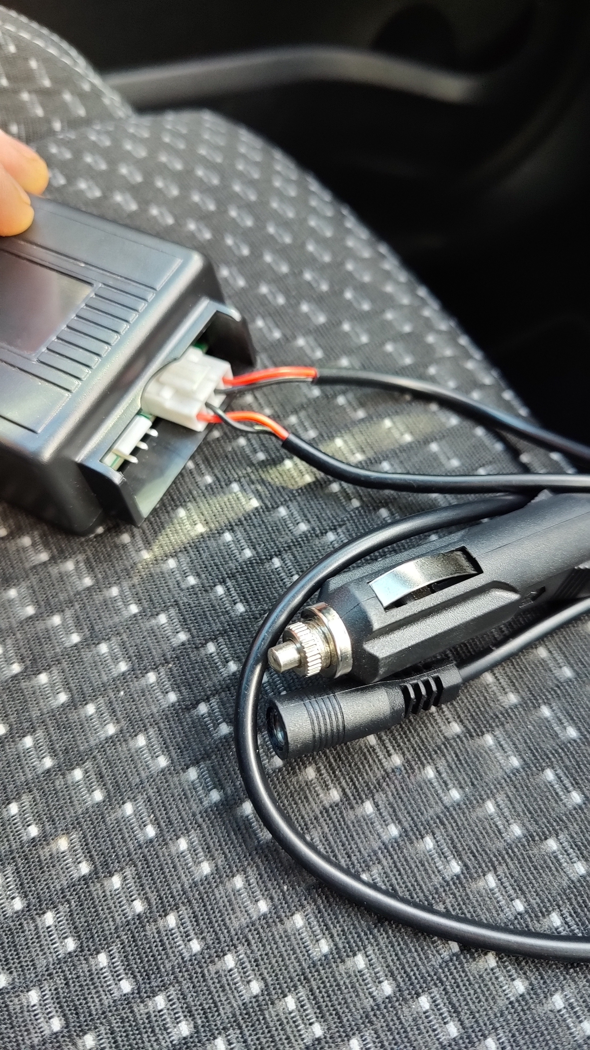

  18. I'll have to take a look and see what's been done. Thanks for your help, I take it this device is no good without the remote?

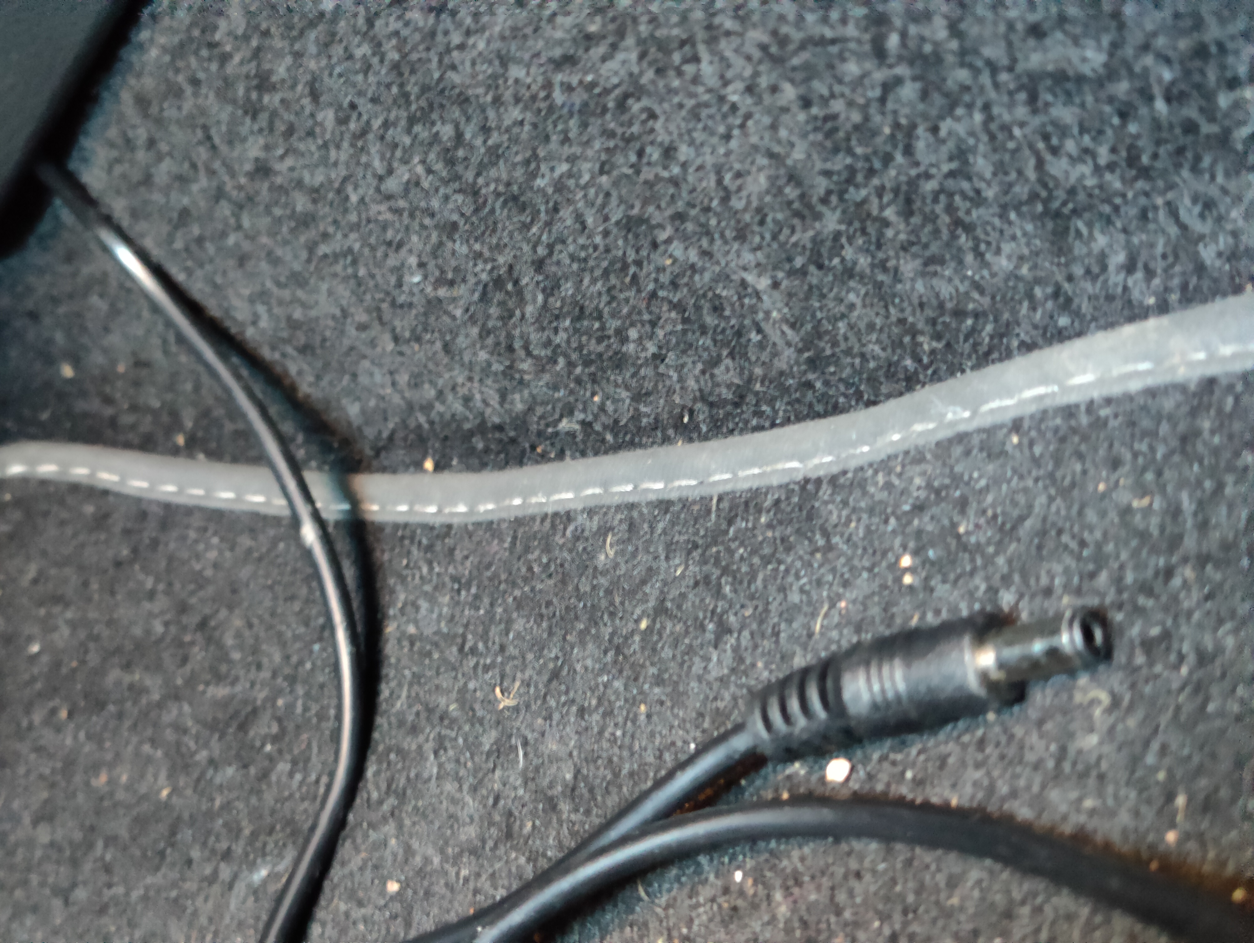

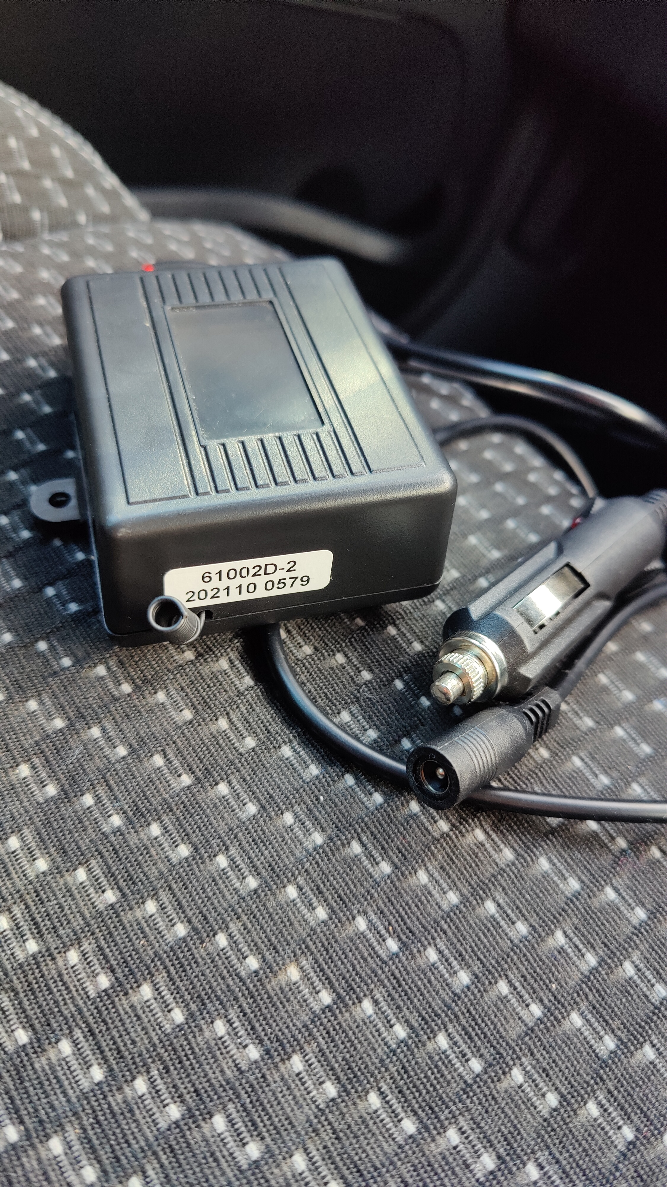

  19. I found this little item in the seat storage in my Fabia, I've only had car for a month or so. It has a the lighter adapter for power and a female jack socket I also found a cable sticking out of the center console which plugs into this part I have no idea what it is or does. When connected nothing happens or appears on dash or radio. Enclose some pics
