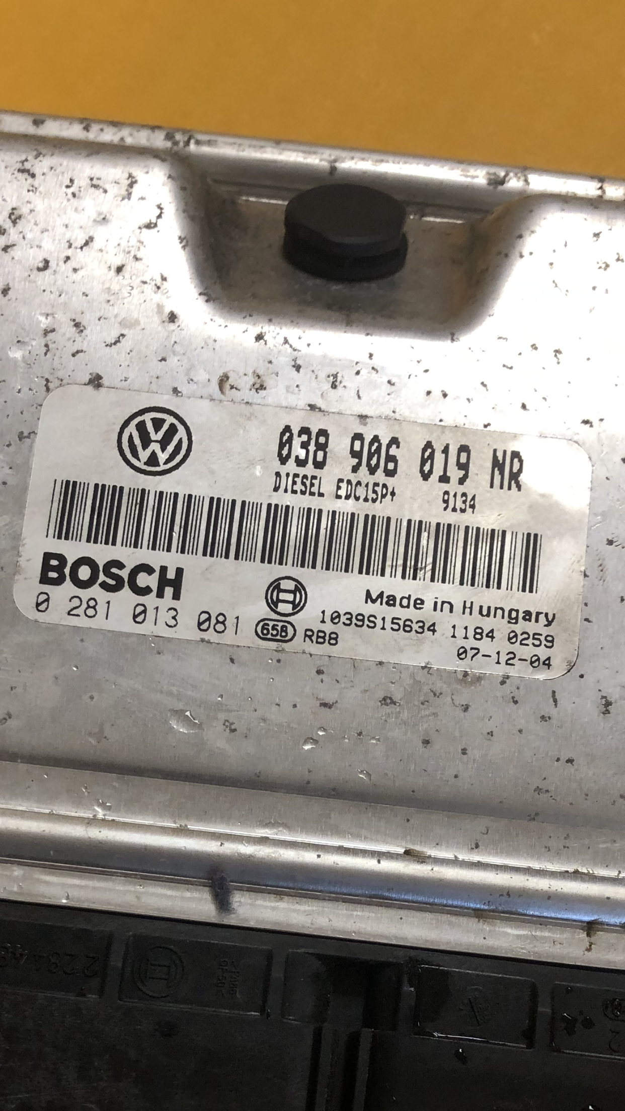

  4. garage has also drawn a blank so far but not a main dealer they are a reputable local garage attached is a pic of ECU for part number cross check. ECU testing did say that "Due to the variant within your software on your ECU, we have had to send your unit to our other department for further investigation" i dont know if thats common but thought it was worth sharing.
  5. Oh ECU has been out and down to ECU-testing in derby and has come back with "NO FAULT FOUND" a bit frustrating. i believe the PD injectors have solenoids on them that basically act as fuel shut off valves but i cant see that they have all suddenly failed. any idea of what else can be tested?
