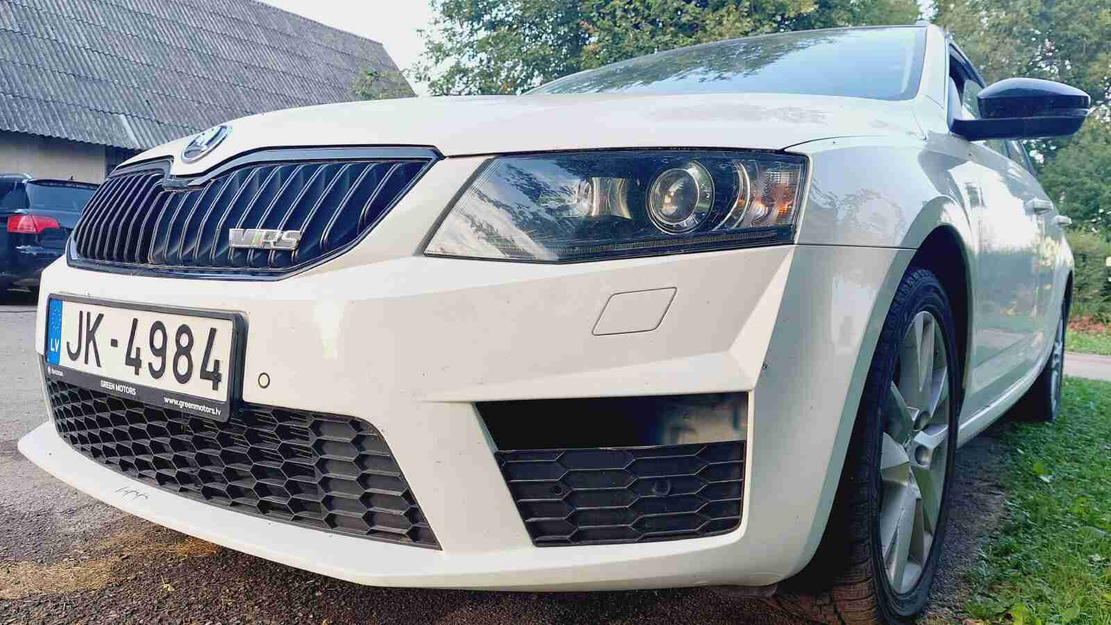

  2. WonderLee changed their profile photo
