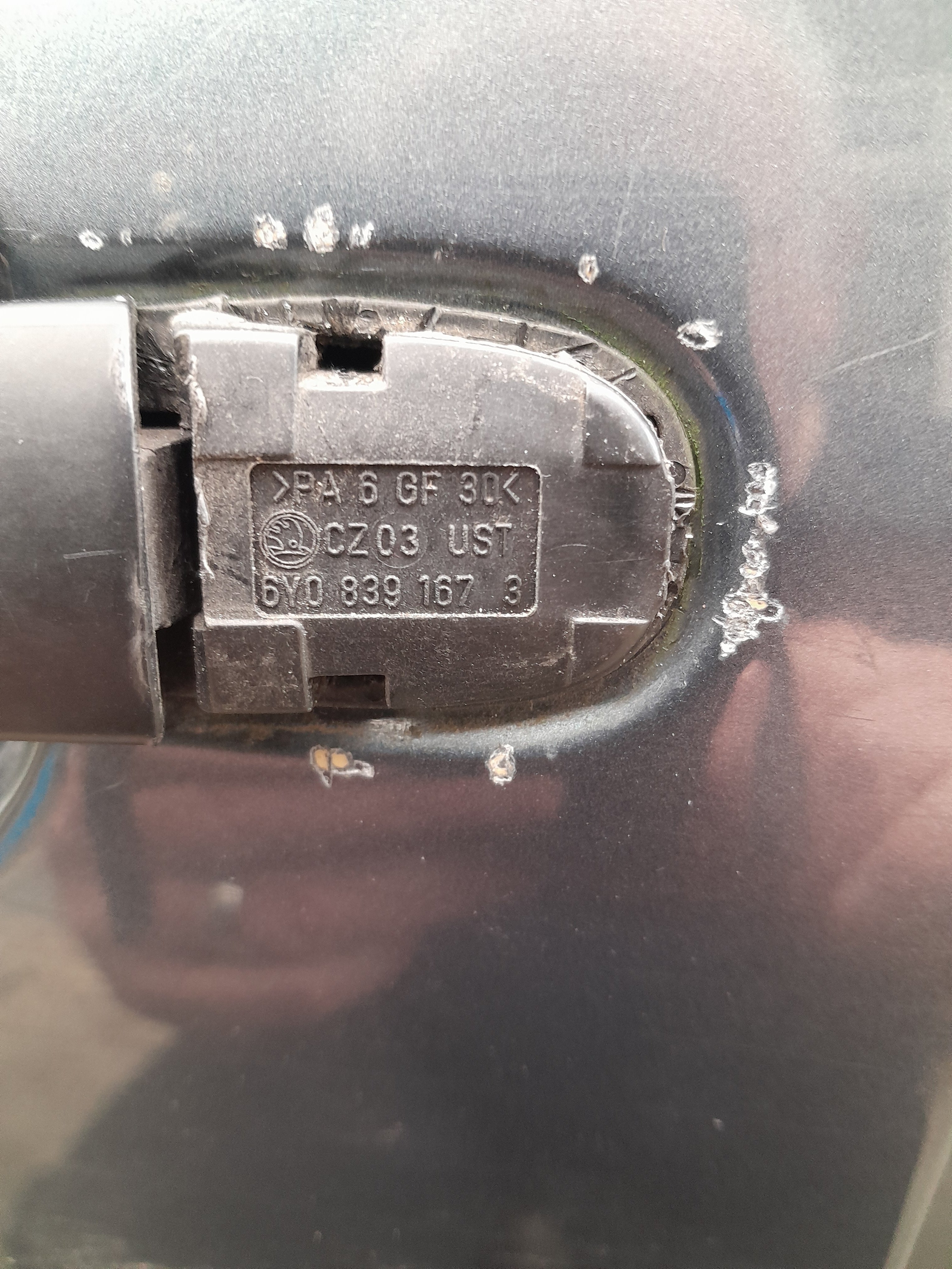

  9. Hi all. 77years old and still get caught out and cursing the job. Can someone please tell me how to remove the part of the front passenger side door in my image of the handle so I can release the cable and remove the lock. As you can see I have already damaged and butchered the surrounding paintwork. I am at a loss. The lock is hanging in the door but I can't remove or hope to refix the cable from that end. Surely this part must come out. There are no screws to remove in either of the two small holes used for a key locking door handle. Very grateful for advice please. Cliff
