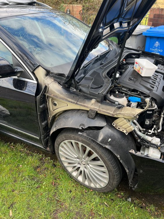

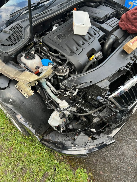

  1. Just a quick update, firstly many thanks for the useful information and links, these contributions have helped tremendously. I've been busy with other things, putting this project briefly 'on hold', but didn't want anyone following my original post to be left in-limbo wondering how things have progressed. I stripped the 'remodelled' items off the car, noting part numbers where legible, the damage wasn't as extensive as first thought when the debris was removed! I set everything aside in two groups, 're-usable' and 'for replacement'. UK suppliers were unable (or unwilling) to supply the 'extension' section of body that supports the wing and located the upper 'X' member, it was tricky to remove but carefully drilling-out the spot welds liberated the mangled item, replacement is on its way from Europe and will be plug welded in place. The adjoining section was easily straightened (thanks to some applied hydraulics) Other parts are all ordered and winging their way to Cheshire as I type. As work progresses I'll post again with some supporting photographs.

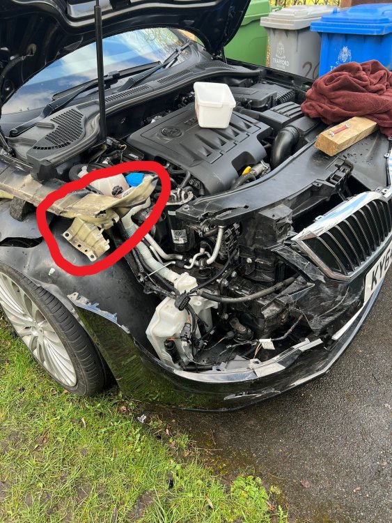

  5. Thanks for the swift response, I'm not familiar with TPS but you're right, I will need a lot of parts, I've been pretty methodical cataloguing part numbers where possible & separating the re-usable from the unrecognizable. I've found a supposedly complete front end of the correct year about 70 miles away (& thankfully have a big Luton van to transport it with) but the breaker isn't the best communicator (can't tell me if it's got parking sensors or headlamp washers) but I will persist!

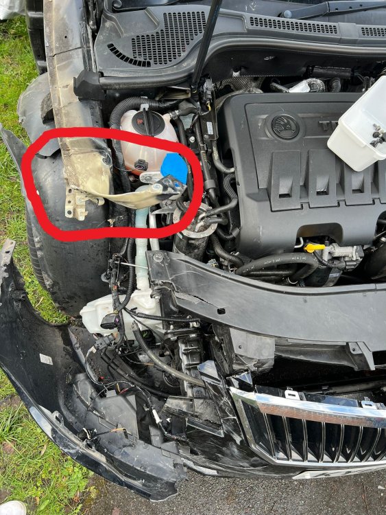

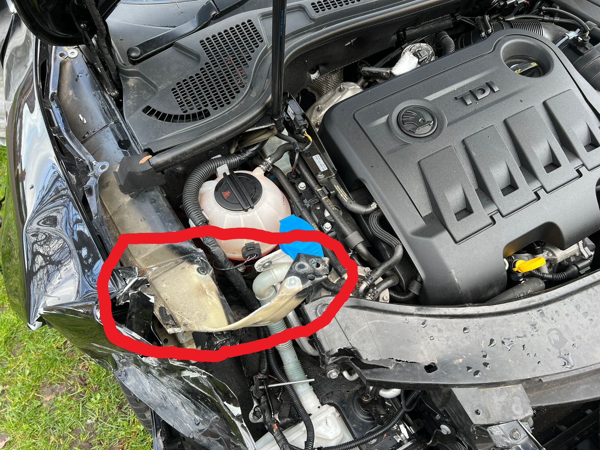

  6. My Son-in-Law has a 2014/5 Skoda Superb estate 2.0 diesel (Laurin & Klement) which has recently been 'modified' (understatement) by my daughter while driving on her TPO insurance! I've noted part numbers as I've removed parts needing replacement but have a problem with the os/f wing support which is badly deformed, the section is spot welded into/onto the shell, I'm trying to find a supplier for a repair section, with no success so far. the alternative will be to cut out a section from a donor at the breakers & weld it in, perhaps someone may know of a supplier?
