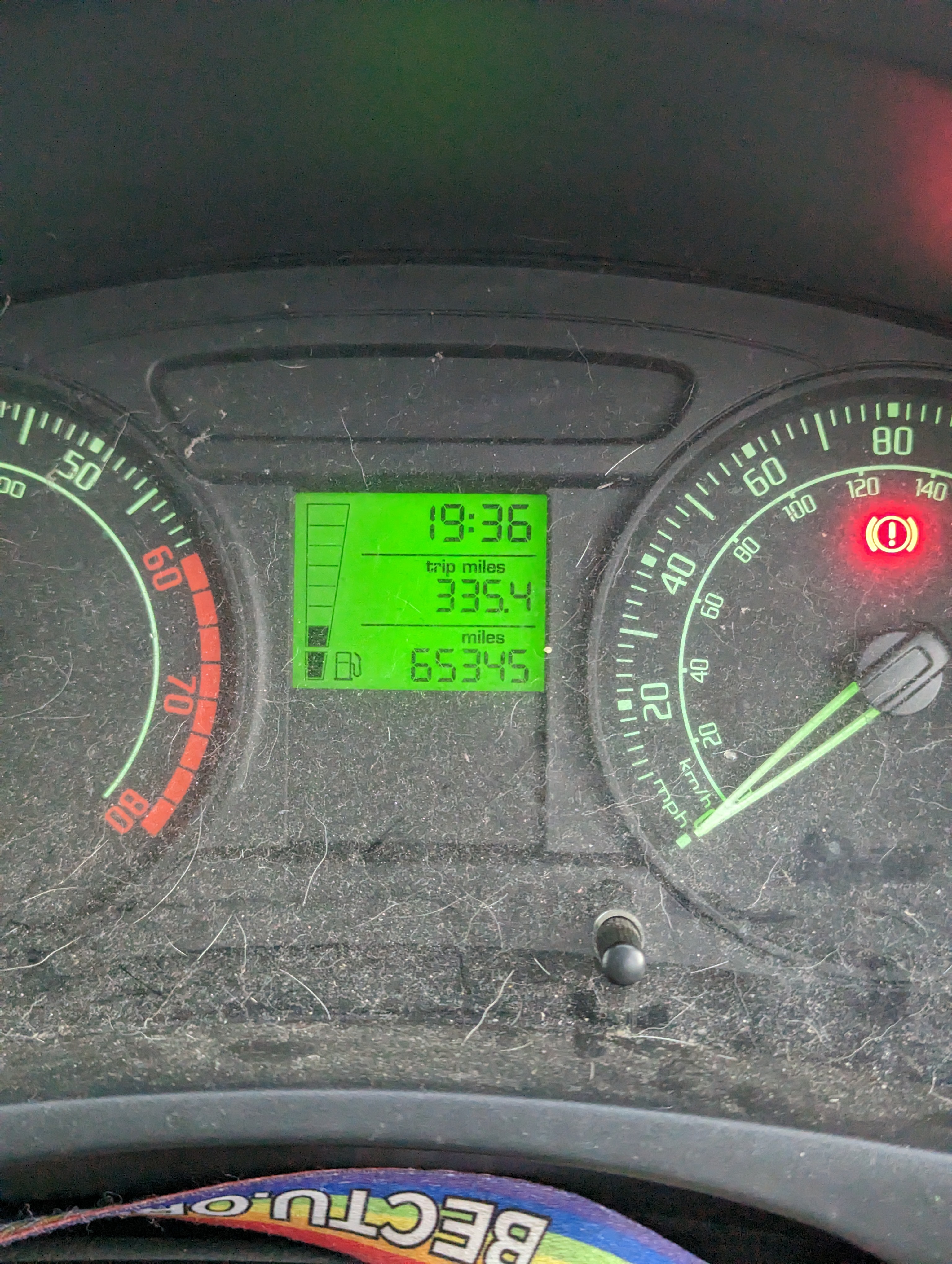

  2. Just came to post a little update. Not sure whether it was the spark plugs in the end or the bottle of redex and e5 I dumped in but I had a few poor MPG runs so dumped the redex in with some e5 and ran it from full to fuel light. Yesterday I filled the car up with e5 and drove to Cardiff and back with about 50 miles of City driving in Bristol Taunton, Bridgewater and Cardiff itself. I was completely shocked when I got past the 180 mile mark and the fuel gauge was still midway. Ended up going 335.4 miles before I decided to fill up, it was in the last notch before the light so still had a little way left. Fill up was 37.57 litres of E5 for a MPG of 40.58. 40.58 MPG! Compared to 20.4 MPG before. Excuse the dust/dirt, cleaning her was not a priority until now. Even though thats nearly double I will be having the car go through a full, yes full service (minus plugs) next week. Certainly over the moon with the improved MPG which has nearly doubled, which is also concerning, where did all that fuel used to go haha!

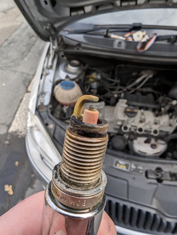

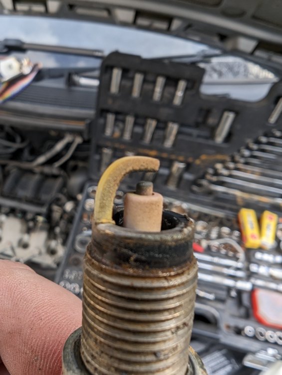

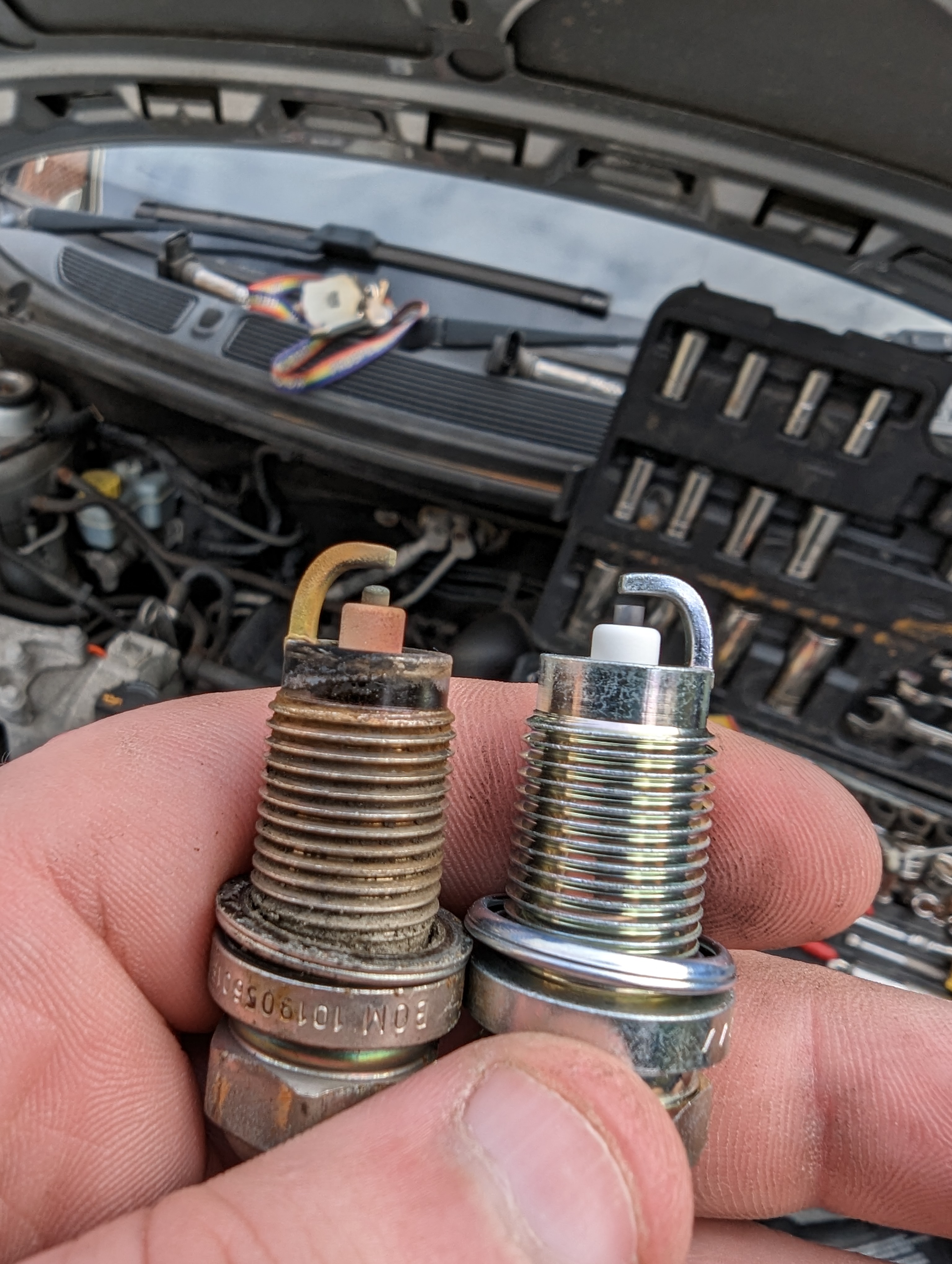

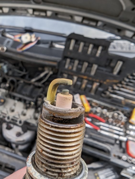

  9. I'm no expert, but I changed them. The gap on the old ones seemed about 3 times as much but I would have expected to feel the engine misfiring or something if the plugs were bad surely? Pictures attached for someone better than me to tell me if it was worth while or not! I'll monitor fuel economy.

  12. I drive according to others very conservatively, I'm always anticipating what's ahead and never close to cars in front etc. But understand what you mean. I tend to coast a lot which I'm not sure is either good or bad for MPG. I'm going to change spark plugs and clean the throttle body and black sensor on the back today, it's £3.50 a spark plug and like £4 for a carb cleaner so worth trying.
