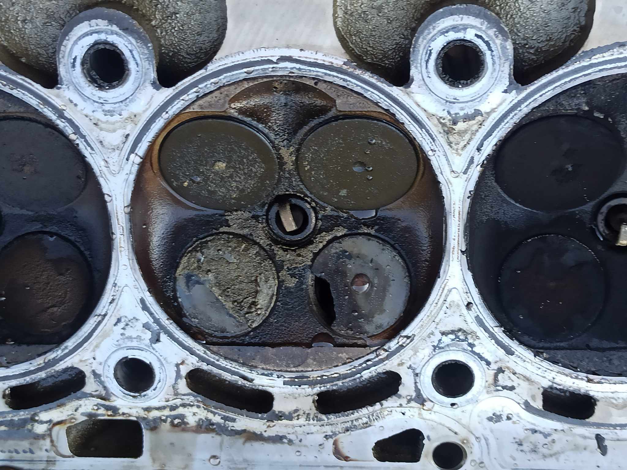

Sure I`ve bought the Kolbenschimt pistons and now waiting to be reassembled, also had the cylinder head reconditioned with 16 new valves etc. This was the incident which I had 😅 I have never seen something like this at first I thought one of the pistons died but not. The car has 200k km (124k miles) in it with the stock pistons I think it is not bad. But now it will be better I can`t wait.

Hello everyone! Last week i had an incident with my car (2010 Rs Fabia) at one time only 3 cylinders were working i stopped the car on the highway asked for help and took the car home. Started to disassemble the engine and turned out that the pistons are MAHLE 76L92. What do you think these are the ones built in by the factory or the previous owner changed them?
