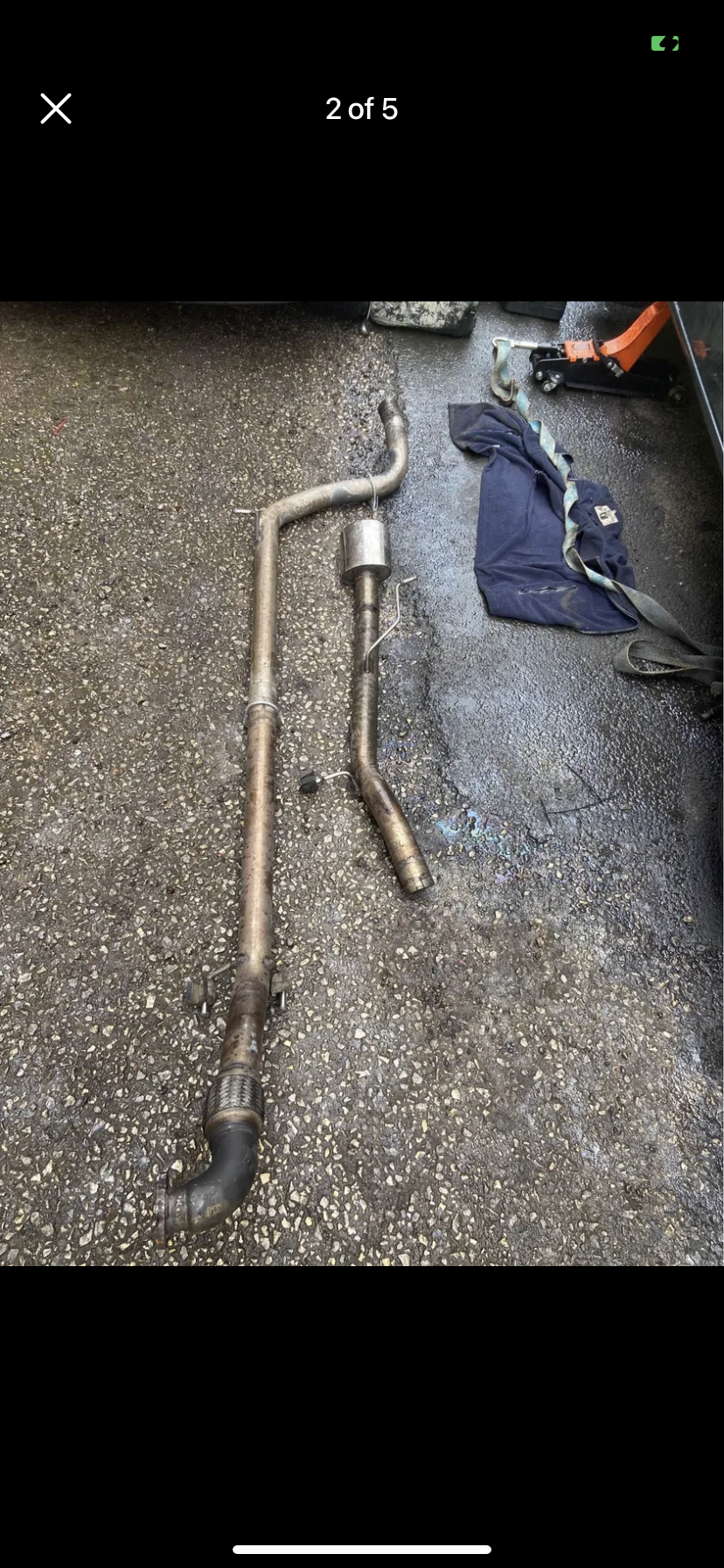

  7. Hi, I have a mk1 VRs and looking at buying an exhaust off an Ibiza pd100. I know the chassis are the same but I’m more thinking of the downpipe and whether that will fit. cheers. As for size, not sure If the pd100 runs less than the standard 130 2.25”. But this is not an issue as the exhaust is 2.5”.
