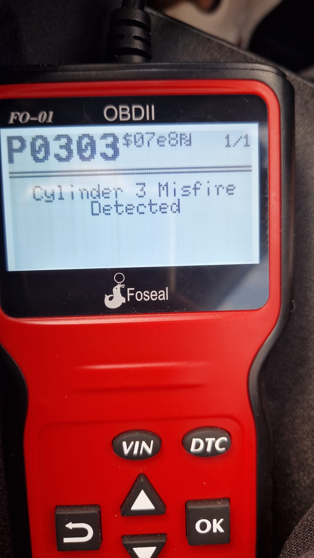

  3. car - 2015 Skoda Octavia VRS DSG Petrol Hi all, I'm after a bit of advice if i may ahead of taking my car down to Skoda to sort out an issue. So i bought my car in October 2021, (Then mileage - somehwere around 40k as i had the garage do the major DSG service before i bought the car). November 2021 - EPC light came on under heavy acceleration, felt like a misfire. when i took it to WhiteSkoda in Cardiff, the diagnostic did in fact show misfire on cylinder 2. (see image below) February 2022 - EPC light came on under heavy acceleration, felt like a misfire. when i took it to WhiteSkoda in Cardiff, the diagnostic did in fact show misfire cylinder 1. (see image below) now: PC light came on under heavy acceleration, felt like a misfire. i havent taken it to skoda yet but have an OBD2 port scanner/reader and it is showing misfire on cylinder 3. (see image below) given the frequency of these misfire issues: is this just a common issue on these cars, do i need all spark plugs and/or coil packs replacing? is this engine just on its say out, should i ask for any kind of compression test? how can i tell if it's a fueling vs spark isssue? should i ask them to take a look at the fuel injectors too? as i have an extended warranty (with some excess to pay unfortunately), is it worth getting any kind of premium/high performance spark plugs to cope with this? or would they void the warranty even if fitted by skoda? also are they even worth it? it is strange because aside from this issue the car runs like a dream. For context I work from home like 4 days a week so it isnt driven a lot other than to local shops/gum which is about 10 mins away. i mostly drive it slow like a granddad with some spirited driving, averaging about 30-32 mpg. oh yeah and current mileage is 55k any help/advice would be appreciated as i dont want to keep sinking money into a car i assumed was fairly reliable.
