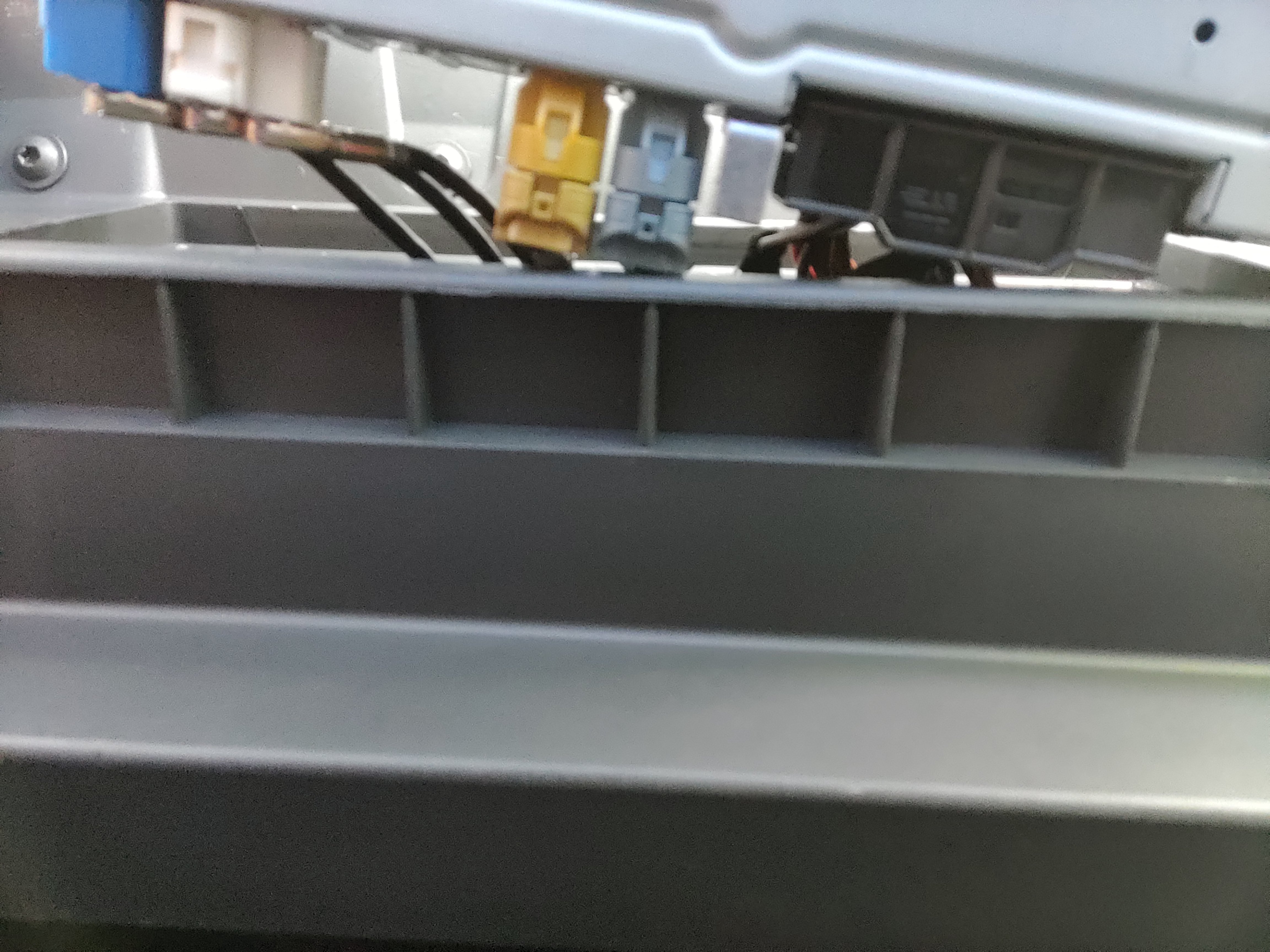

  13. I think some parts needed resoldered, unit volume wasn't working but was returned and back working now
  14. Update on 16 superb with no sound, thanks to pab I got in contact with his friend who fixed it, volume working again πŸ™‚
  15. Update...I got the unit out of glovebox, posted it today for repair, hopefully successful:)
