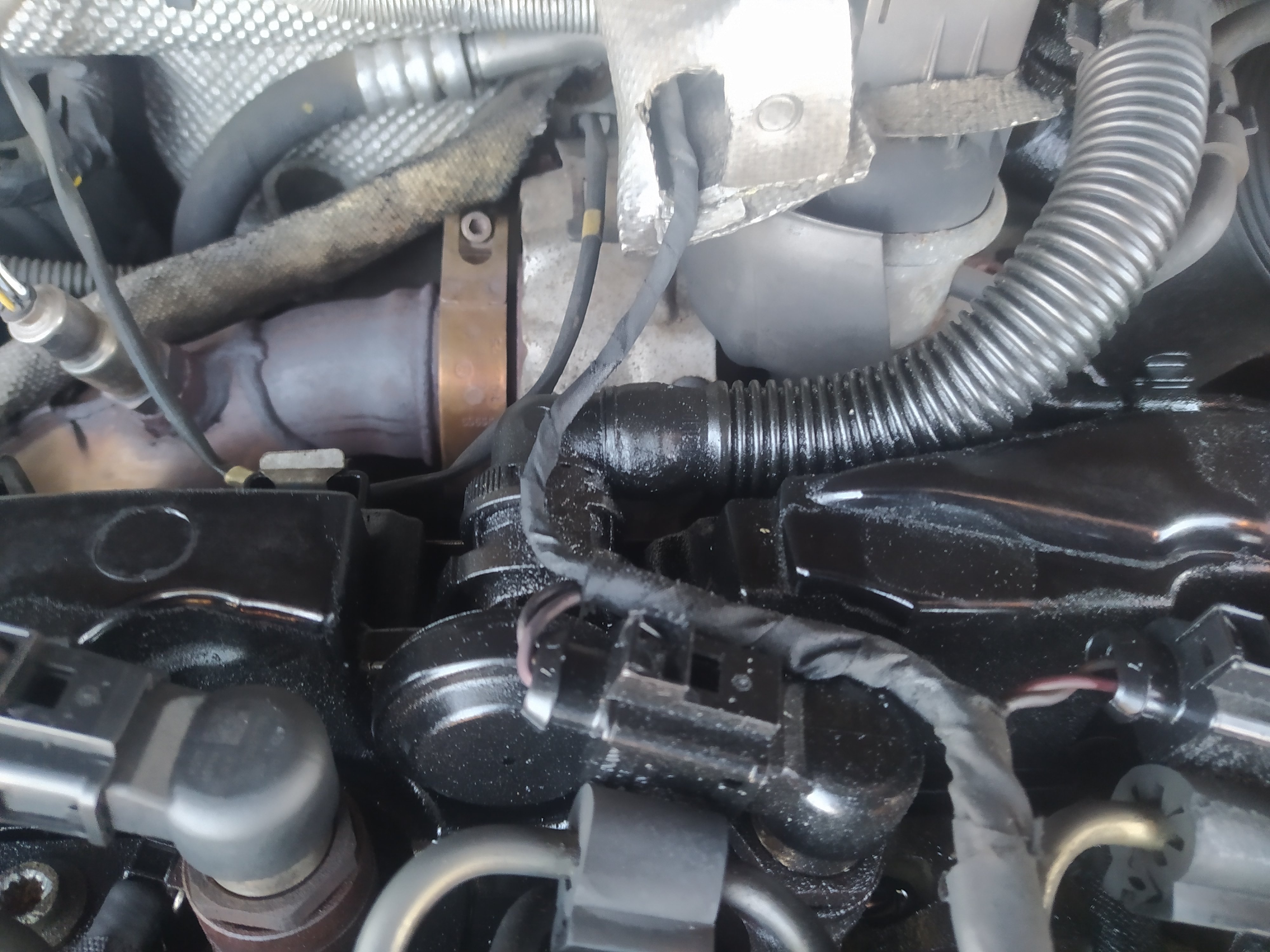

  2. Thanks for your reply, sepulchrave. There is no pressure at all regardless of position of cap. No pops either. When the engine is running the coolant flows into the tank..It stops when engine stops. I have an expansion tank coming tomorrow hopefully. Have you any idea what that item is in the middle of the photo? it has a convoluted hose attached to it.

  4. An update after a run. Did a 30 mile run, average speed 45 ish. Temps outside about freezing or below. Coolant topped to max beforehand. expansion tank level to halfway between max and min. Coolant bubbling in from small top hose. No pressure when I unscrewed cap. Return journey. Colder still outside. Same result except coolant had not gone down. Still no pressure escape. Took cover off engine. Very small escape of steam in middle of photo attached. Rad top hose warm, bottom hose cold. Any ideas what equipment is in the middle of the photo please?
