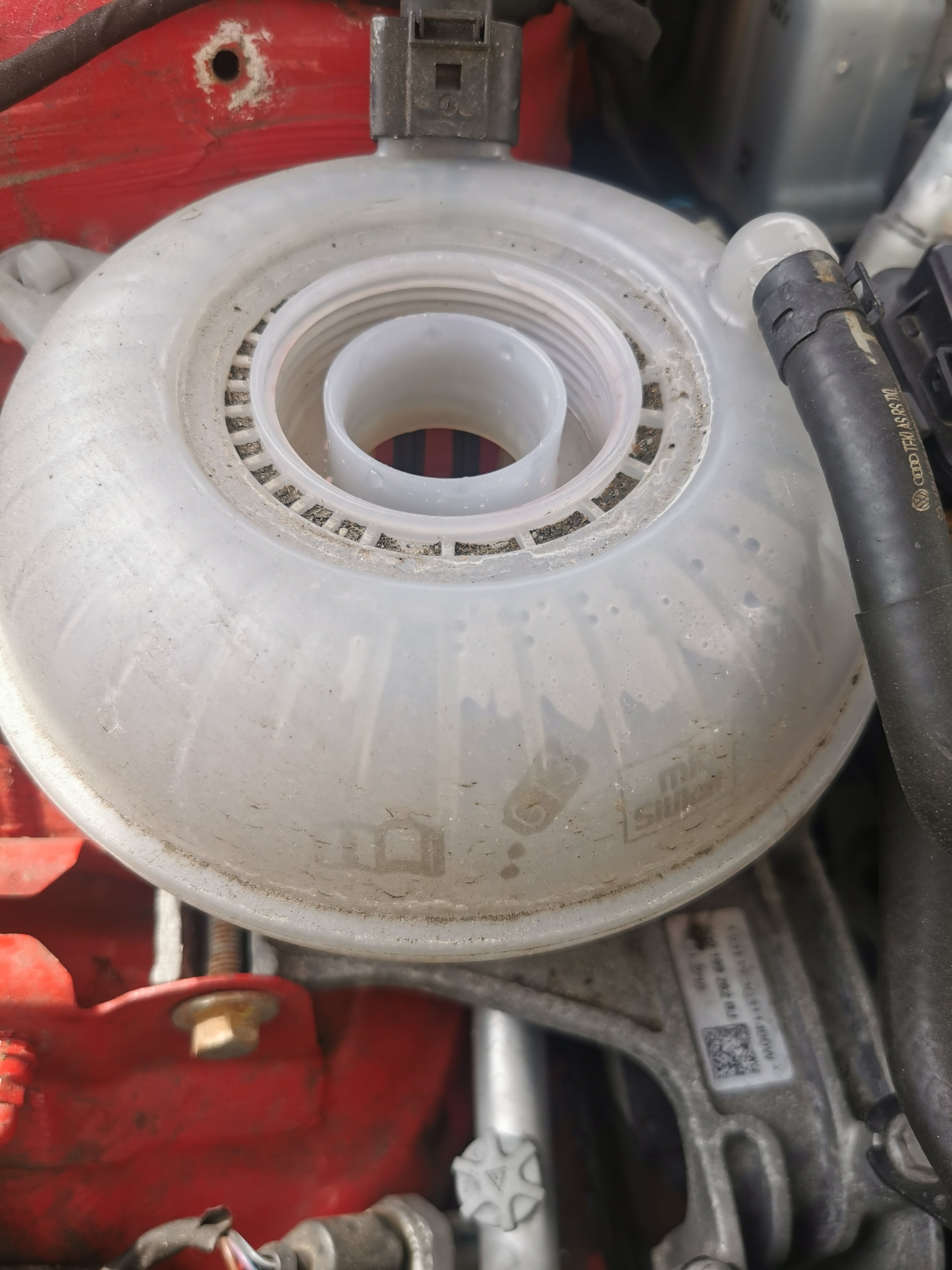

  4. Been meaning to get my heater sorted the past two years now, summer rolls around and it just seems unimportant. There is zero heat coming from the driver side and just a little from passenger I suspect the heater matrix is blocked, coolant tank looks ok and silicone doesnt appear split Can the matrix be flushed out without replacing and if it needs replaced how do i determine the correct part and i read a thread last year on different shapes of matrixes. Cant seem to find it

  11. Over the winter i noticed my driver side had no heat. It appeared the heater matrix was the problem. Now im not so sure. Ive now noticed I have an issue with the air con. The passenger does not have cold air, driver side does So basically, driver side no heat, good AC Passenger side, great heat but no AC

  14. I thought my issue was only related to driver side not getting hence, new matrix would fix it. Since its quite warm i didnt think it would be an issue but now i find passenger side is not cold enough, driver side is nice and cold So is the problen still the matrix, does it affect how cold the AC is?
