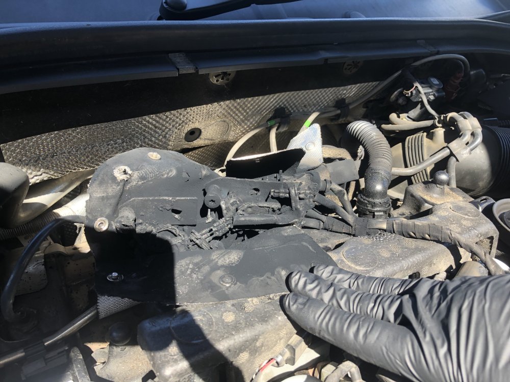

Pete Many thanks for your input on this. Photo as requested, have no idea what I am even looking at mech wise but 'it' or ''they even once lived in the foil pouch under the plastic engine cover...I'm assuming they are the said ex-sensors that threw the fault codes but you can tell me different. Sure have a cut off it anyway, opinion much appreciated mate. Thx

Hi all More motor woes and in need of a little advice please. Finally plucked up the courage to get my mechanic lift the engine cover and open the foil pouch to examine the exhaust pressure sensor and the DPF diff pressure sensor which were throwing fault codes and an engine light and limp mode on my newly acquired 250k mile '17 Mk3..needless to say the sight of 2 sensors and a wiring loom burnt to a crisp have left me with a very sinking feeling. Mechanics advice upon scanning and observing codes and said mech damage is that the DPF was very much blocked (you don't say!) and the XS heat and back pressure most likely did the damage. Just one question for you Smithys on here...should I have got the DPF dash light ('dots in the box') to indicate a fault/blockage as standard under the circumstances or is the lack of a dash light indicating same more common than imagined? Best regards and thanks in advance. J. 😉
