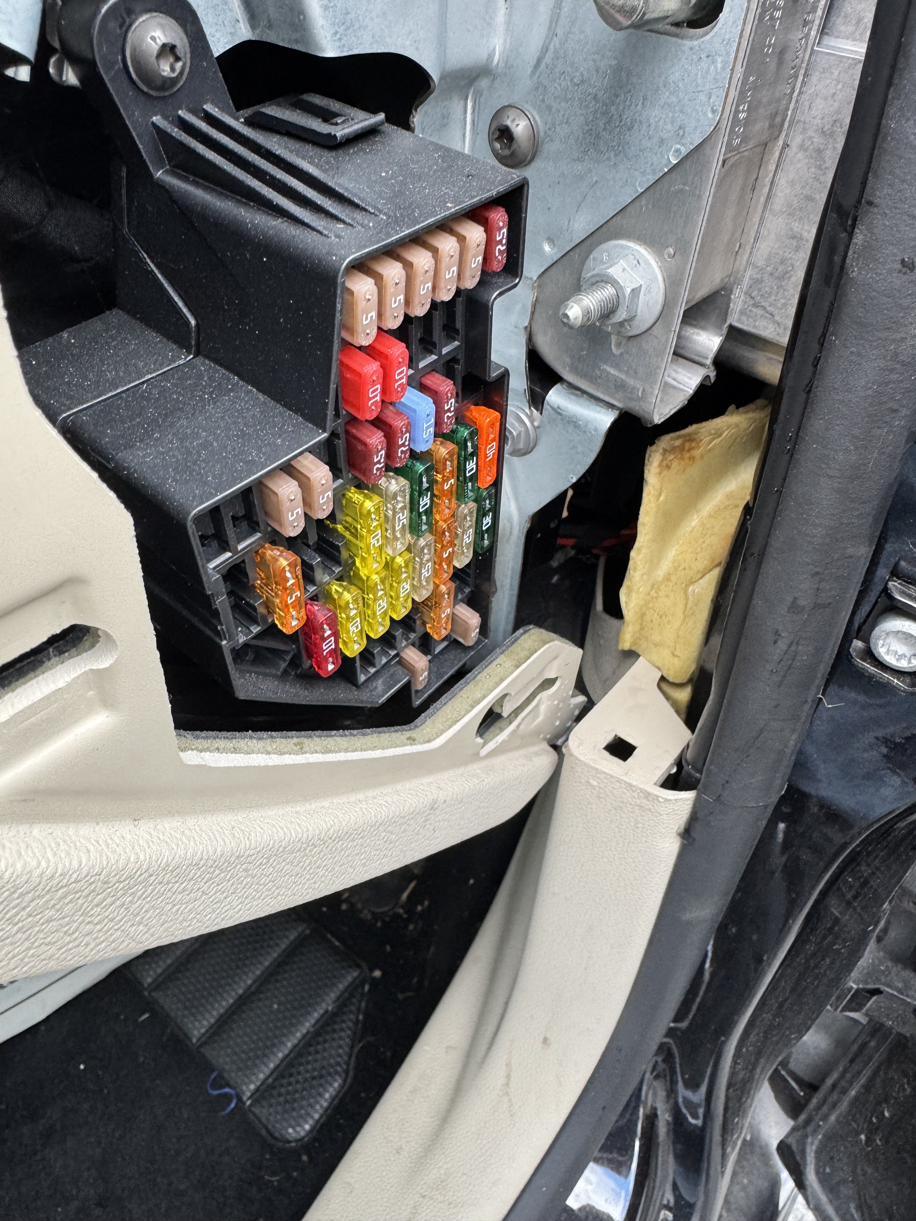

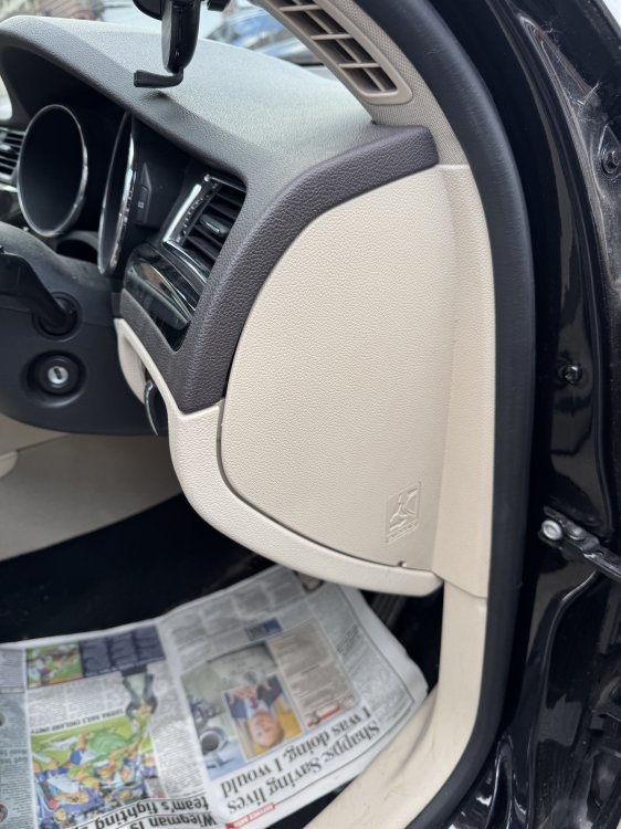

  3. Evening. I have a lovely 2015 estate. Yesterday, we had some SERIOUSLY heavy rain, a real good thunderstorm. Afterwards I got in the car and noticed water near the driver footwell. The door looks like it has 3 different seals and all three were dry. Further investigation tracked it higher to the area where the fuses are under the “Airbag” side cover. All seems dry in there, mild steel with zero rust. Did wonder if the drain holes near the wipers were blocked and they were to some extent. I’ve cleared that. Not windscreen wash either. We’ve had another equally heavy downpour today but no further ingress as far as I can tell. Anything to worry about or just keep an eye on it and put it down to freak weather?
