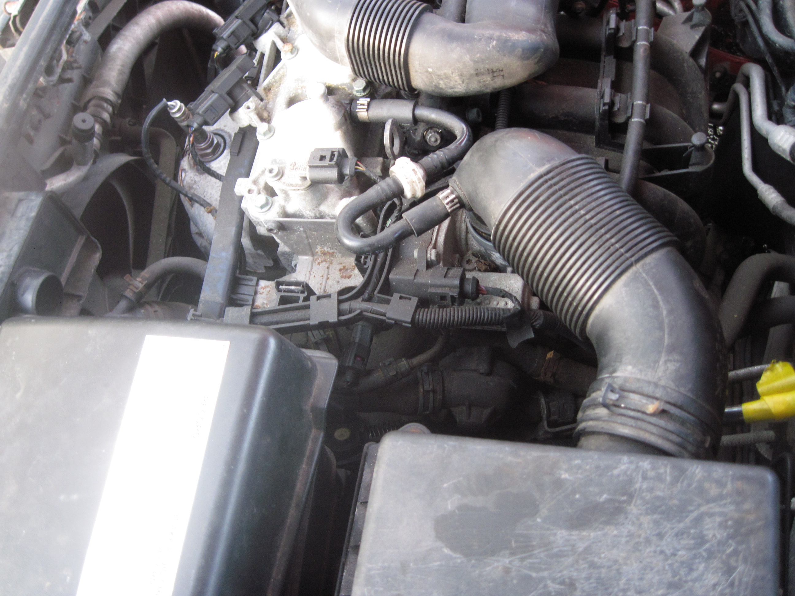

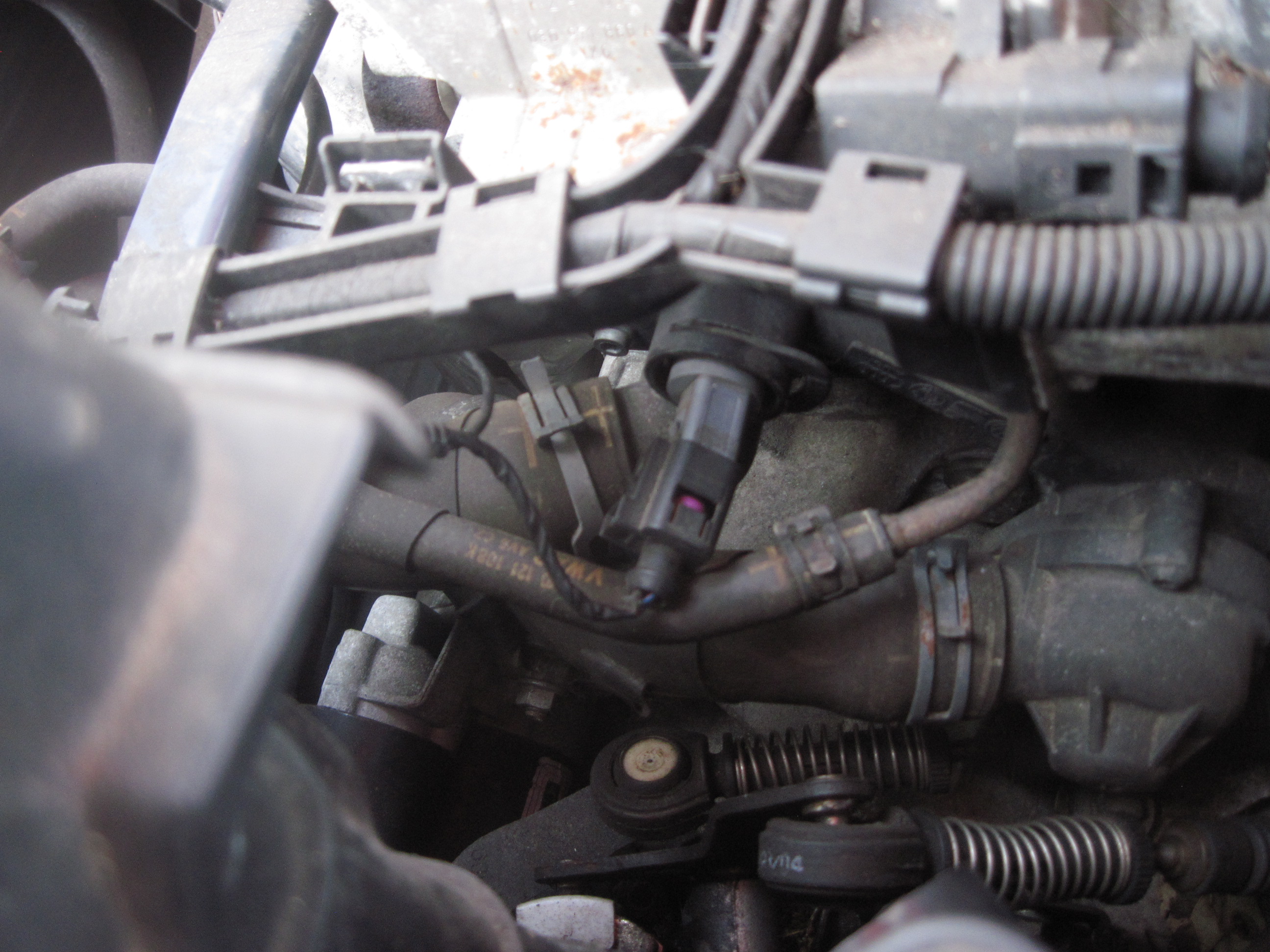

  3. Hello Pete thank you for the advice I have taken couple photos of what i think is the coolant temperature sensor the electrics partly unpluged so spot purplein the photos it was hidden partly from view with air intake hosing to the air filter removed I was going to unplug the coolant temperature sensor it so it does not give a false high temprature , (low resistance) as a temperary fix while i see if the P0301 is now fixed after plug change. The plug in one was sooty black (i have read over rich fuel air mix for some reason) rather than oil black if that makes adifference to the advice on the cylinder compression. thank you iain
