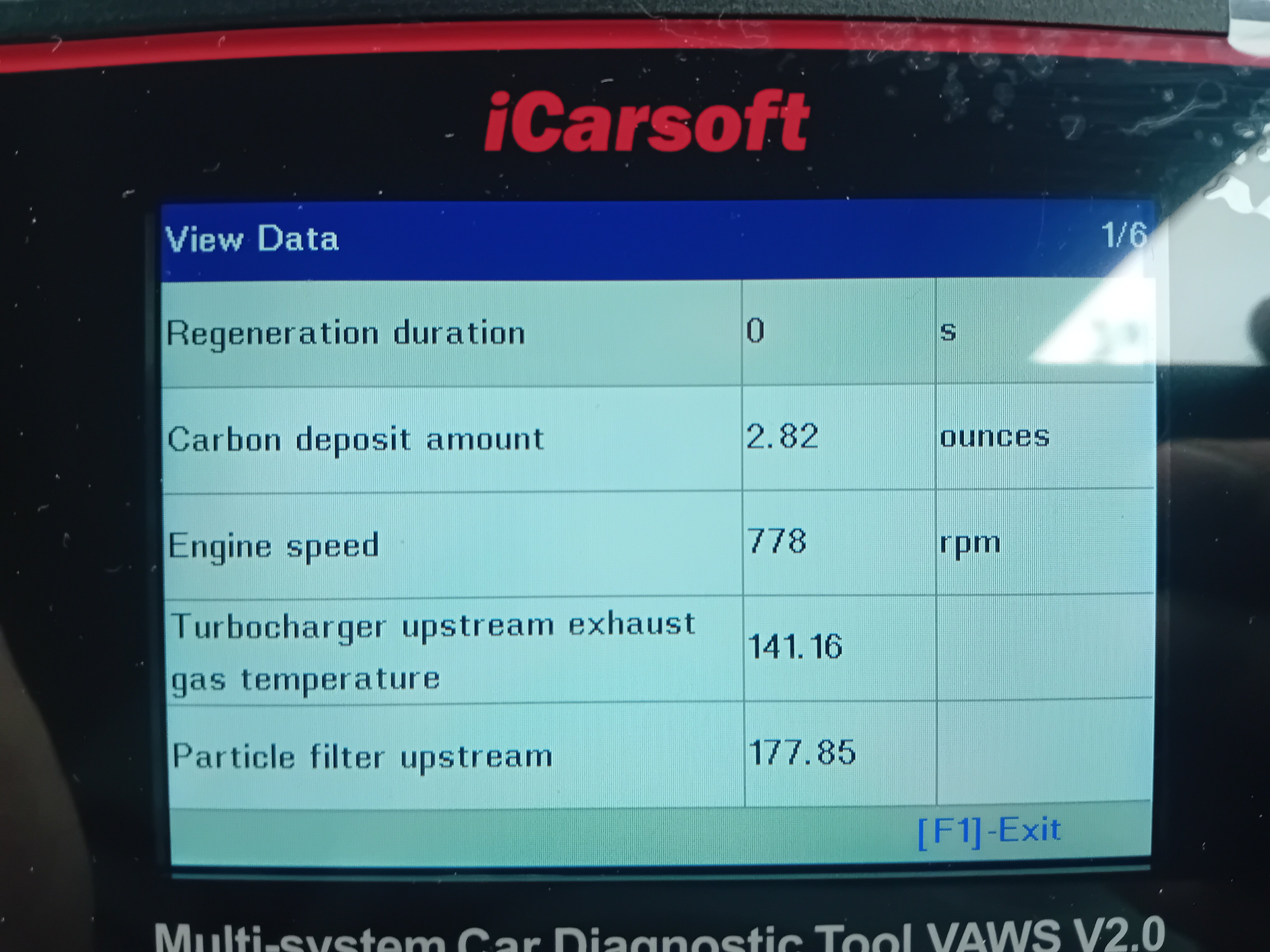

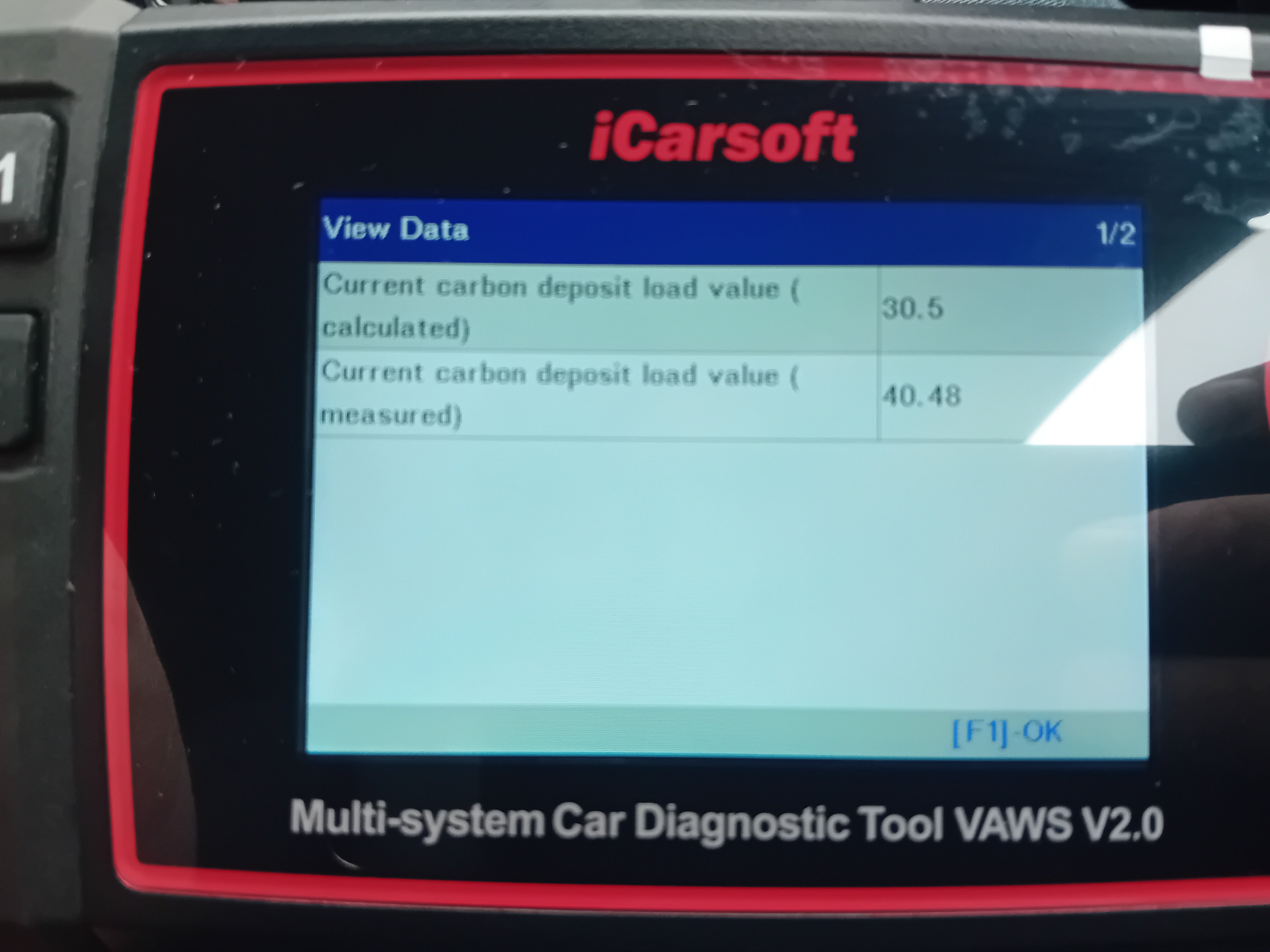

  2. Hi thanks for replying. I bought a code reader thinking it would help me out but obviously hasn't. I've spent the last 4 wks trying everything possible. I'm thinking of booking it in with skoda just to see if the ecu is out of date. But this scanner as the latest software on. But may not be the correct. I recoded the injectors that were on the injectors to think that would help but it sent it missing all over the place. I disconnected the battery and left it and then reconnected it and it seemed to have cured most of it. I bought a new exhaust temp sensor to see if that wasn't working but the soot levels still carry on building back up. I've put stuff down the sensor pipe to halp flush it out and it did get quite a bit out. Its like a guessing game. I tell the ecu its had a new dpf to cleare the glowplug light but leaves the dpf light on. I've been told to have the dpf smashed out and egr deleted. So god knows i'm thinking of buying a obdeleven or carista to actually see whats going on. I haven't had the injectors changed but when it went into the garage he said it might have 1 leaking as the soot level is building up when idling.

  4. Hi all. Had dpf code come on after dpf light came on then coil light. Had new egr 18months ago. The garage have regenerated dpf. Came home and then next day when into limp mode. I've been smelling fumes through the heater vent when stationary. Back to the garage he's tested all the sensors and regenerated again. He said the soot levels are creaping up when stationary. Any ideas? We are thinking it might be turbo related but a pig to get off and check. Any ideas welcome.
