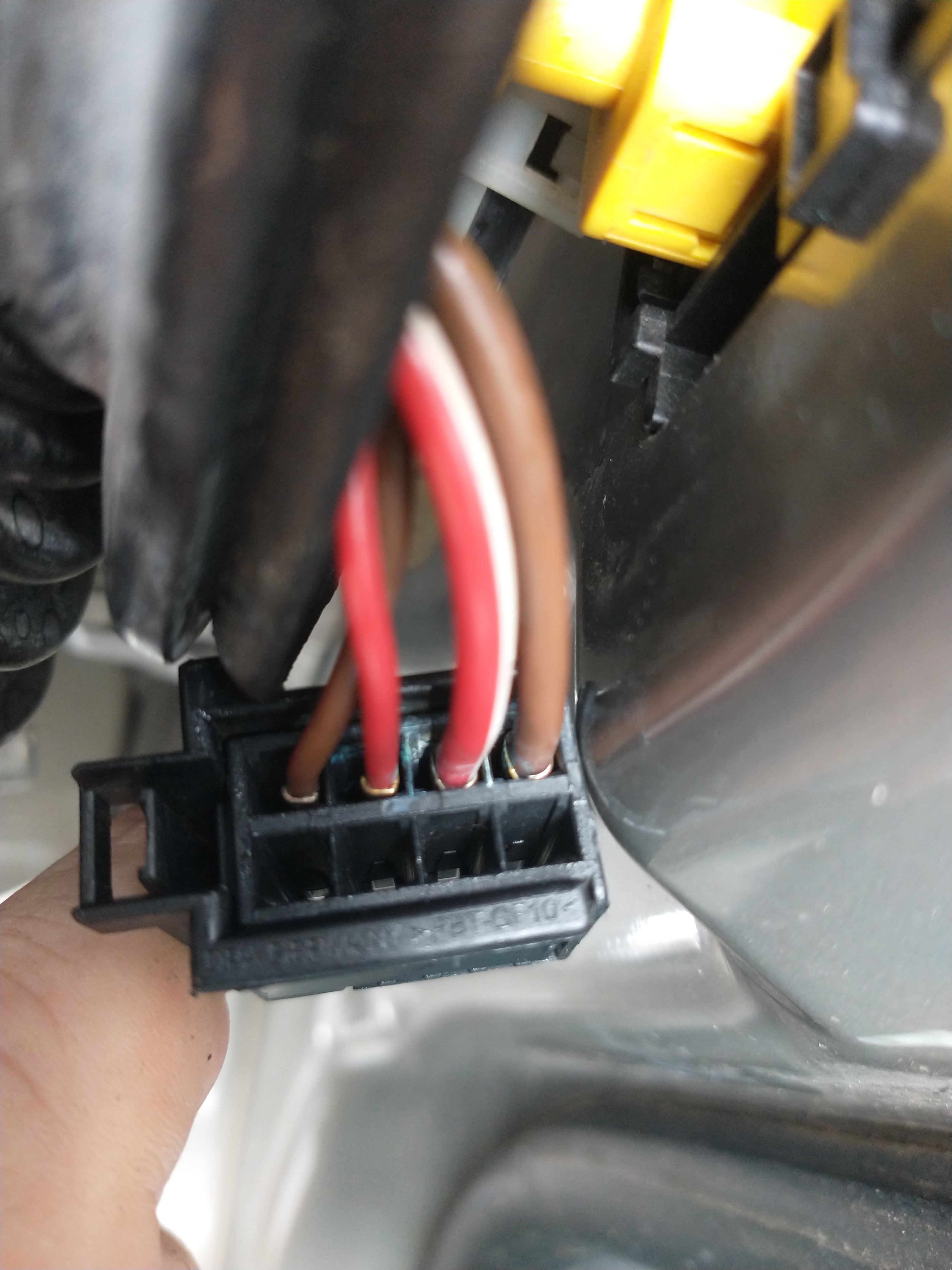

  3. Thanks Pik, The picture is from the in-between the pillar and door on the passenger side. I sprayed it with electrical cleaner and did my best to remove corrosion. The rivets on the metal cover are seemingly already drilled out as the window mech has been replaced by previous owner but they haven't put enough bolts in so it's semi lose and hanging. I'm starting to think this has lead to the connection to the lock to come undone. The issue I have is I'm a newbie to electrical and don't want to make it worse. If I take the few bolts of thet they replaced the rivets with and pull back the metal cover I really don't want the glass to fall out or disassemble itself. Do you happen to know if me taking a look would cause this? Also would you know any posts by previous members where the lock mech has lost power? I've tried googling and searching but I've come up short. Lastly do you happen to know the multi meter settings I need to check the power of the cables? I've tried YouTubeing it and I'm coming short? I would also like to say how much I value this help as I don't feel like I'm on my own headbutting the broken door on my car.

  5. I managed to take the outer plastic of the connection and i can see wire contacting the metal and gave it another spray. I've also noticed i can only open the door from the outside and not from the inside. I have a multi meter what settings would i need to test these wires and how would i set uit up? I want to see seemingly at what point do i lose power? Sorry for the spam its just driving me insane
  6. I found these to be corroded slightly. Can I remove these and clean them? Then put them back? If so how? Thanks
