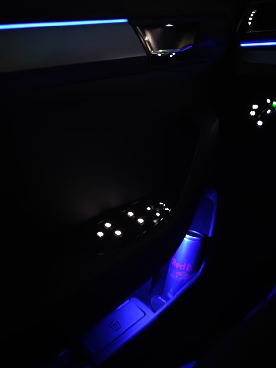

Hello igrozan, Can you provide me with more information on how you did extended ambilight ?- VCDS options on Superb III

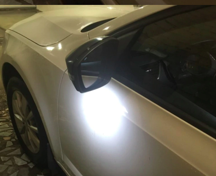

@Joco776 ok, if the car does not have a 360° camera. Can the lighting under the mirrors be activated when in reverse gear ?- VCDS options on Superb III

Hello, Has anyone tried coding the mirror puddle lights to turn on when going in reverse ? In other word code them to turn on/off in the same time as reverse lights.- VCDS options on Superb III
Hello, I activated the change of the ambient lighting in the different driving modes. I want to ask if it is possible to automatically change the color of the ambient lighting when the door is opened ?- VCDS options on Superb III
