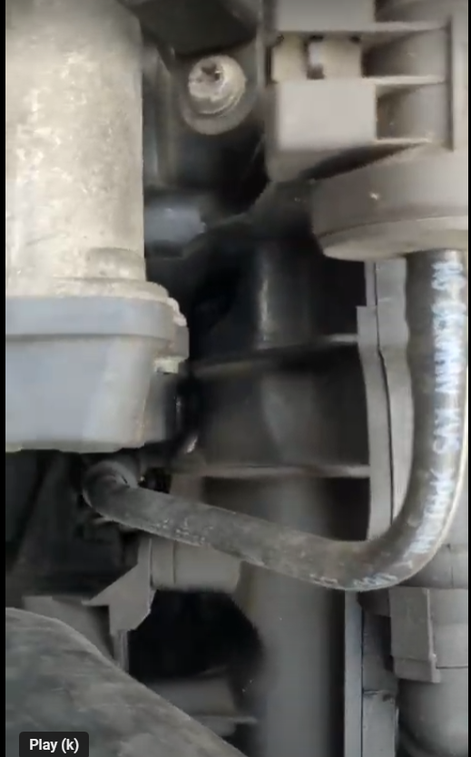

  2. Thanks, will probably give it a go then. I'm hoping I can figure it out but might aswell ask on here in case anyone is able to help with the leak? D According to the mechanics the leak was coming from somwhere behind the intake manifold. When the leak was at its worst I noticed little stream of water deep by the fuel line/injector (Sorry image is sideways!)

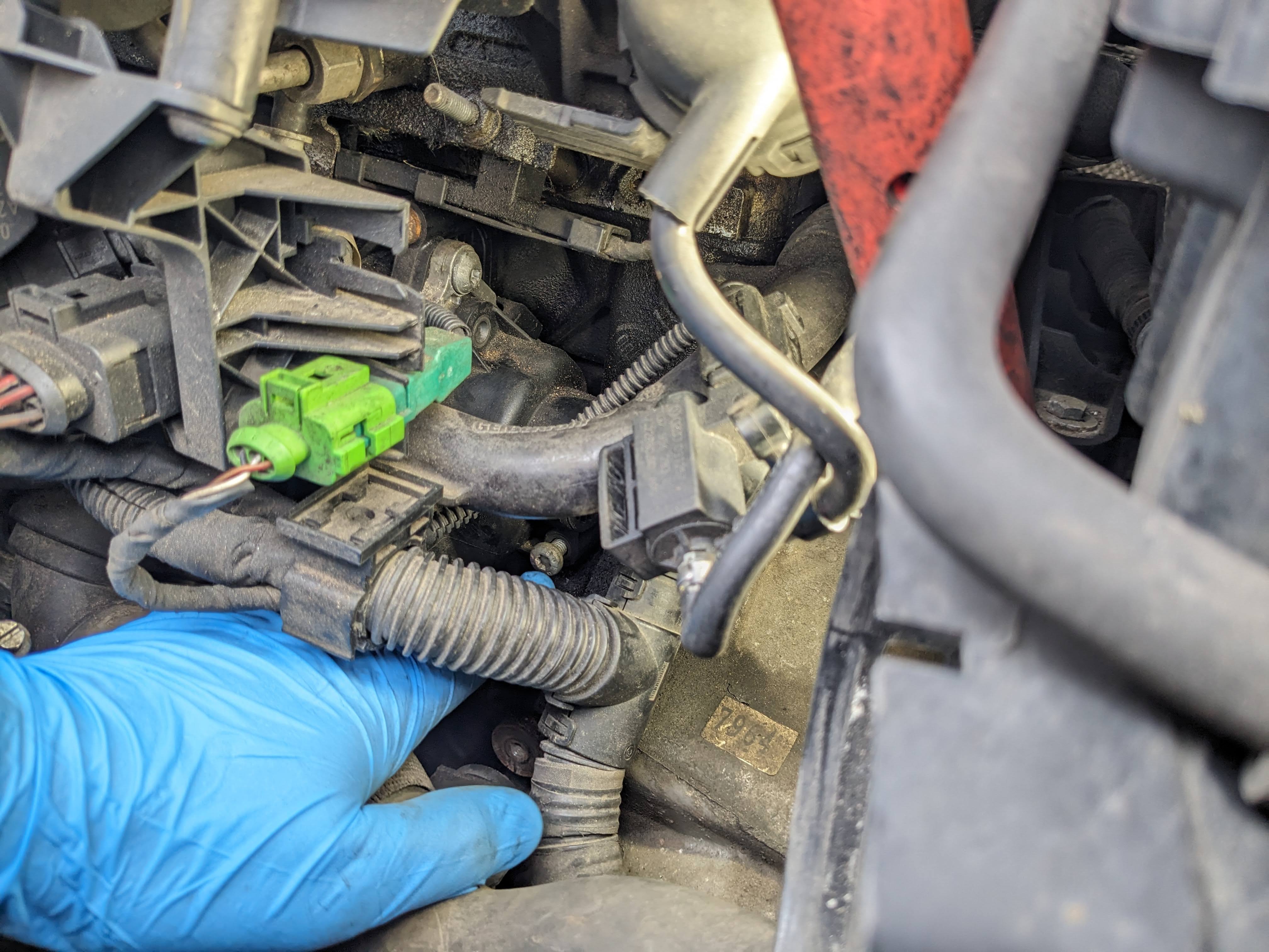

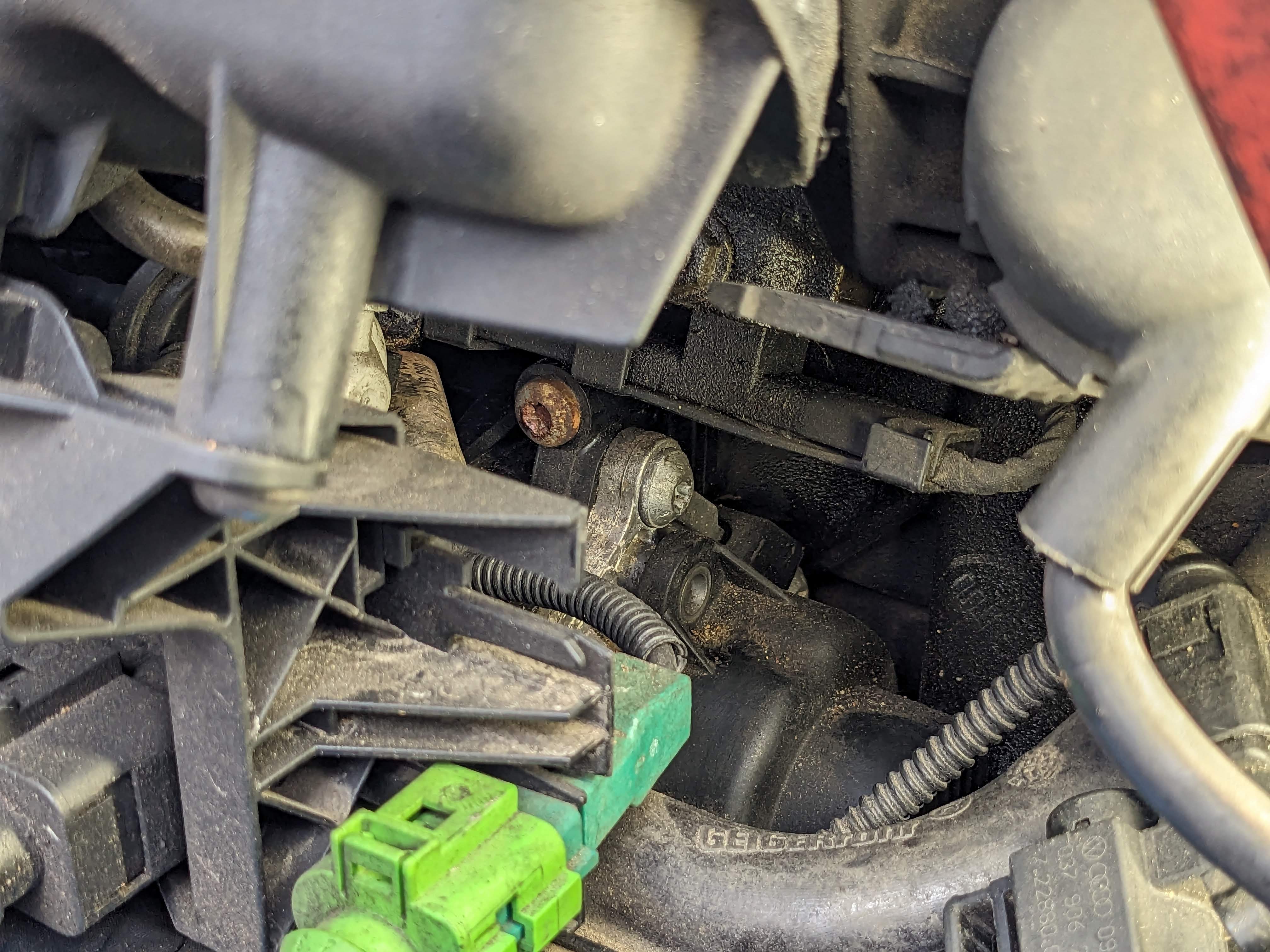

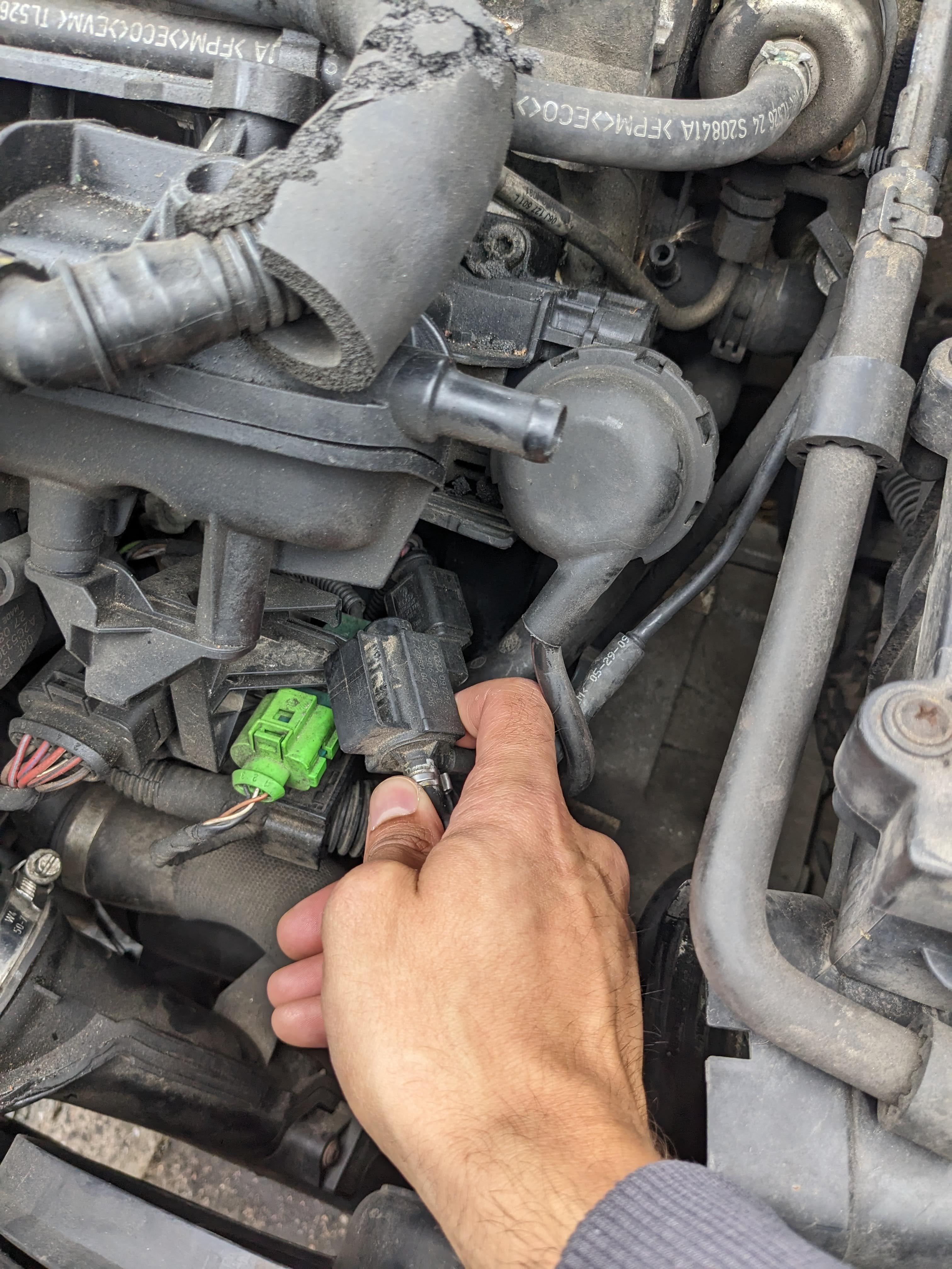

  4. Looking for advice on what to do next ... Garage did engine work, replacing valves, cams and timing chain at 119'000 miles which was carried out a while ago, in November 2022 by the previous owner Car is now on 128'000 and I had coolant leaking near the front of the engine. I had a mobile mechanic come to check things over as I was worried this could be the water pump, after inspecting they found the leak coming from a different connection, water pump is fine but they noticed parts around the intake manifold that had loose bolts or no fittings at all. They asked about work carried out on the car and I immediately thought about the engine job. I took some photos. In them you can see one missing bolt, one loose bolt, and a wiring connection hanging loose. They weren't able to fix the leak but said it was to do with the lose connections. I've since been adding water to the coolant every few miles to keep the coolant topped up as I've had to drive around as a matter of necessity, which the mechanics said would be fine for now to just replace with water. Added some coolant leak stopper stuff and it's helped massively. I'd like the garage who did the engine work to take the car back to sort these bits out ideally, but I'm sure it won't be as simple as that. Wonder if it's worth the hassle as I could probably sort these things out myself as I have some mechanical experience and the tools, but I'm worried I might end up opening up a can of worms and need a garage anwyay. Thanks for any help guys
