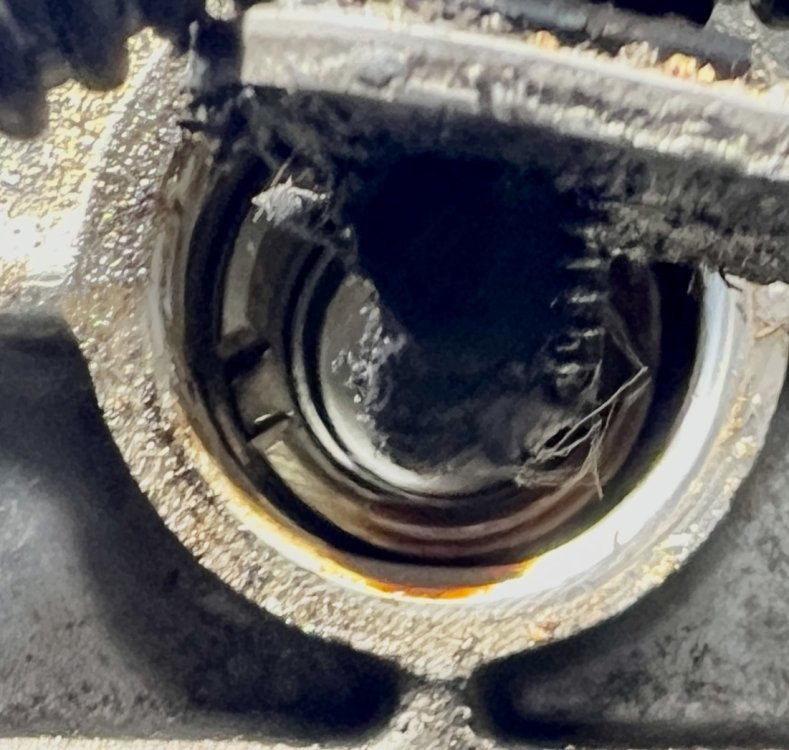

  4. UPDATE I've had the plugs out and checked TDC as suggested. The cams are both aligned with one another however at TDC they are diagonal (at approximately 7-2 o'clock) rather than dead horizontal (9-3 o'clock). See below (camera is level at TDC - apologies for the distracting bracket in the foreground) So this confirms the problem as you've all advised - timing chain has jumped on crank sprocket. I think it probably jumped a single sprocket a while ago which resulted in incomplete combustion, poor performance and overheating which killed the CAT ? Then this week after parking facing up steep hill and leaving in 1st gear its jumped again to the extent that it won't run. As this is an interference engine this will have probably damaged the valves. I've reviewed GREGSY's experience here: https://www.briskoda.net/forums/topic/497626-has-my-timing-chain-skipped-any-easy-way-to-check/ Given my car is outside on a steep hill and I have no workshop, this kind of repair is beyond me so I'm going to ring round some recomended garages tomorrow. I know in the past that you've advised this kind of fault is probably not worth reparing (2021) https://www.briskoda.net/forums/topic/498056-skoda-fabia-2003-12-htp-117000-miles-engine-turning-over-quickly-but-not-starting/ Given the current price of second hand cars and the fact I've had the car since new and it's otherwise sound would this still be your advice... ?? Thanks again for all your help in diagnosing this - at least now I know what's wrong despite the challenge of getting this fixed (and I've learned not to park facing uphill and leave in gear....!)
  5. Thanks Chimaera and Pete for advice. So Check TDC myself (and perhaps see if I can get a photo down plug hole to see if any damage). Then tow to garage to check diagnosis and put new timing kit on as its not worth not replacing if stripped down to reset timing. Then fingers crossed...?
