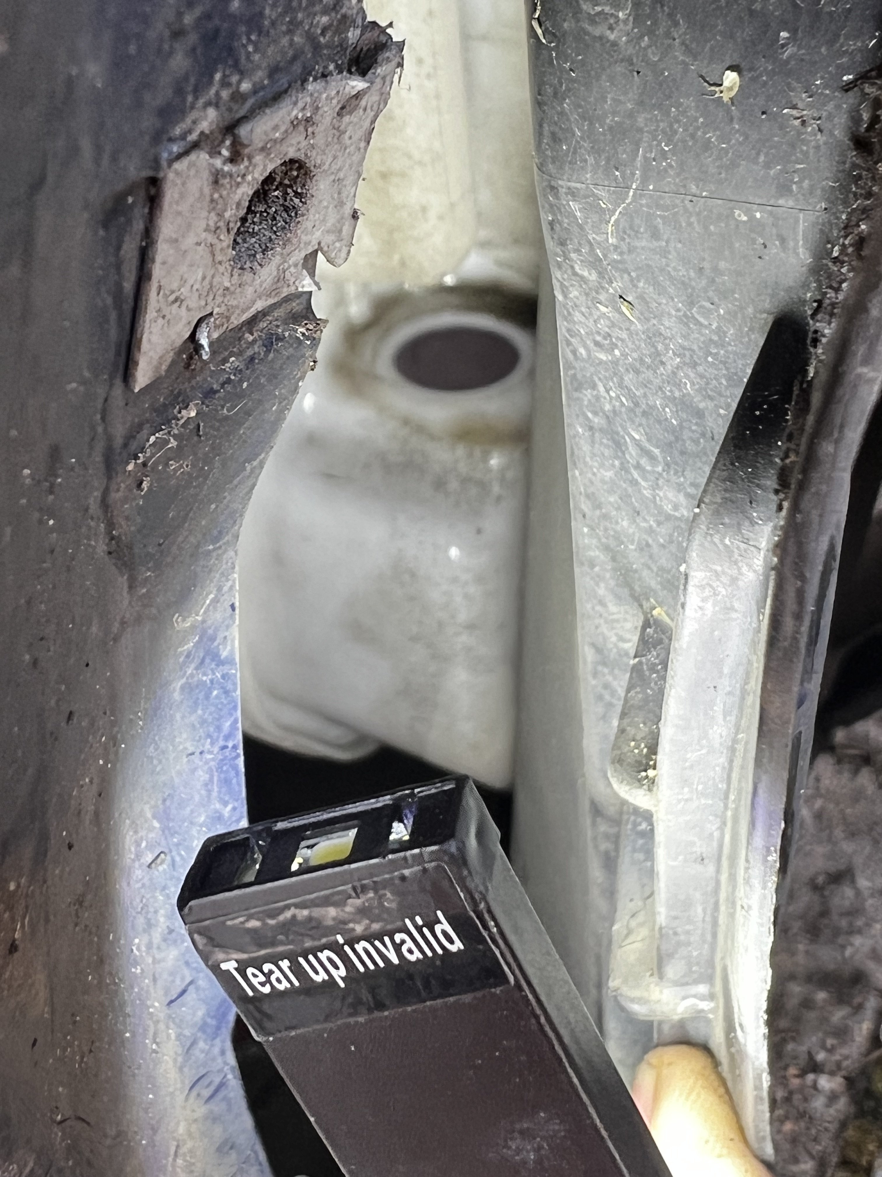

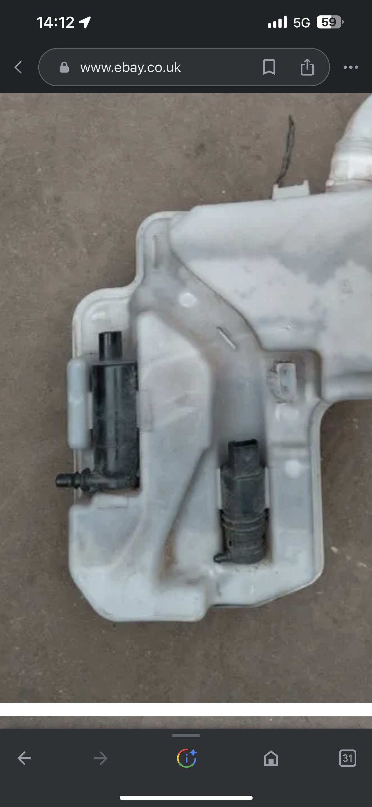

  1. Well yes, that is the clue, what pump are you referring to? The spray works so the pump should be in place, i just can’t figure what it is Nope, no headlight washers on the car
  2. Yes, it is, bottom left corner The pump works, the water sprays
  3. Hello, a couple of days ago i filled up the windscreen washer tank, and yestarday to my surprised the sensor indicated that it was empty. I decided to have a look at it myself and realised that i’m missing a piece but i really can’t identify what it is nor where it’s gone, i’ve attacked a picture of the hole where the part should go and a picture of what kind of part should be there. As the price of a new bottle seems quite high, and not needing a whole new bottle, i’d like some advice on what do you guys think it is and where can i find it. If any additional info is needed, please let me know. car is a skoda superb mk3 2016 1.6tdi 118hp hatchback
