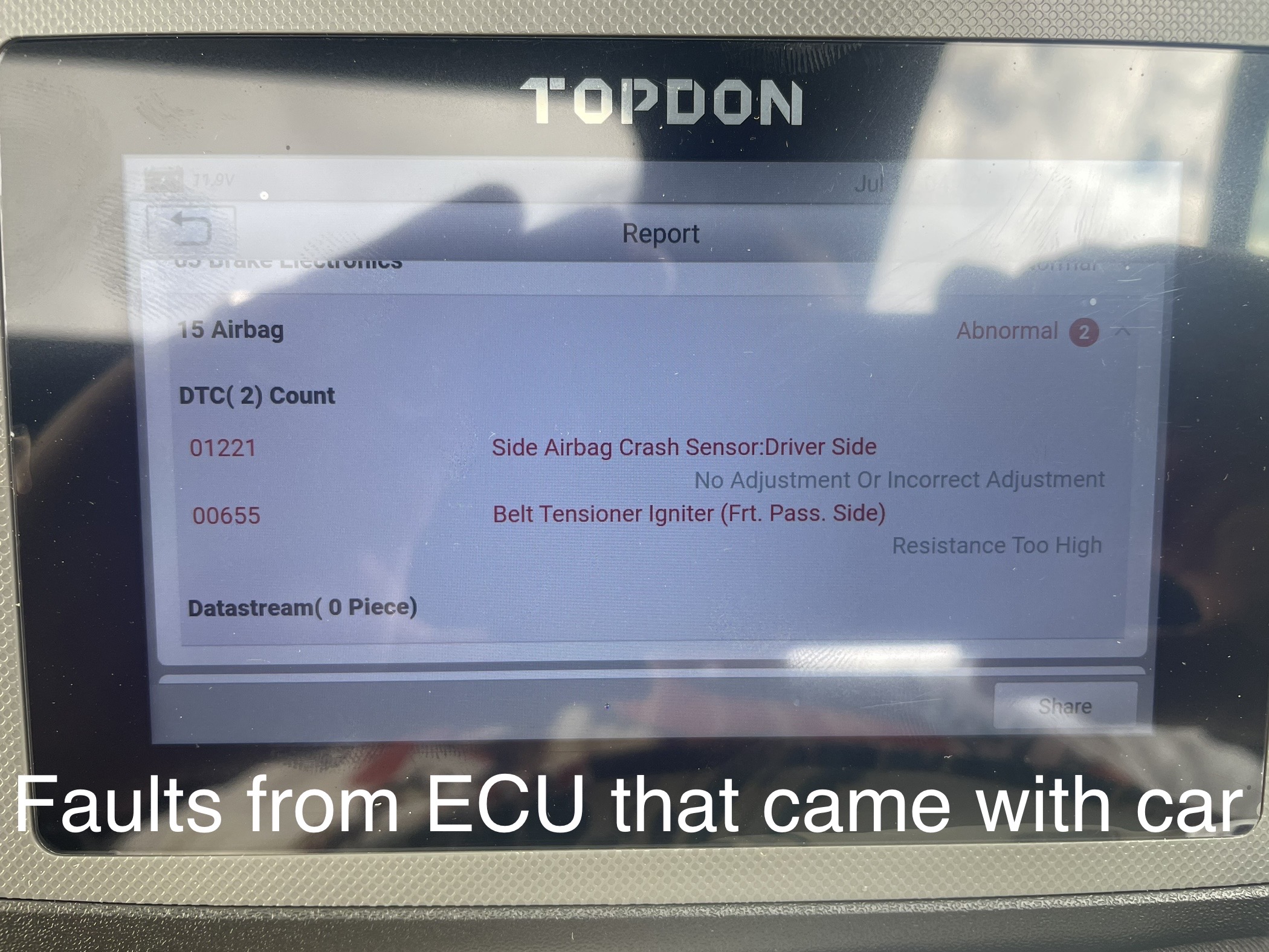

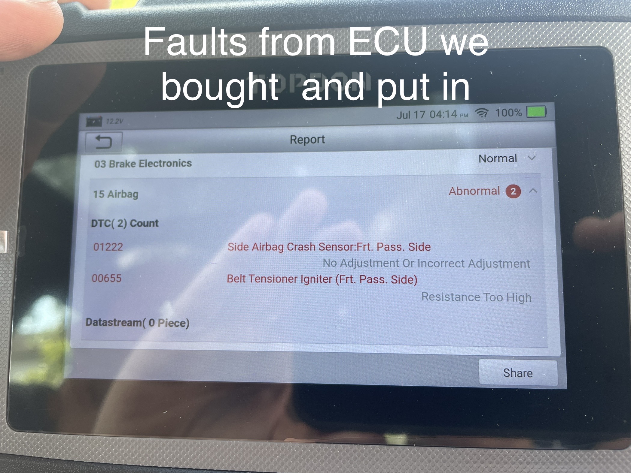

  1. Not that I’m aware of. Only had that car about 9 months. We’re going to have a look at cleaning the connectors and see if that does anything and try remedy the belt tensioner
  2. @Breezy_Petethank you. Airbag sensor is explain here in a previous post from my dad that I believe you helped with: this is the same problem we are still trying to deal with but will look for any corrosion
  3. Thank you, the ECU was exactly the same part number and index (08) as the original. Surely if the ECU was from a LHD car then the belt tensioner fault would would have swapped sides aswell? Re the corroded connections, do you mean the connector block to the ECU and/or the sensor? Would I be able to see the corrosion?
  4. OlllyC started following Sam745
