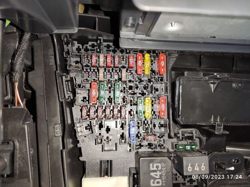

  14. Okay that makes sense, I was just worried about messing up my car electrics as I literally have no idea what I'm doing where electrics are concerned. I was confused by both fuses showing 12v on both sides but have now read I need to remove the fuse and test the socket with the multimeter. I will give it one more go tomorrow and remove original fuses as you said. Thankyou 👍
  15. Can someone please help me make sense of this? - 'They're absolutely directional. If you don't orient the fuse tap properly, you'll be pulling both circuits off only one fuse. To find the proper orientation, remove the original fuse from the vehicle fuse holder, and place the fuse for the new accessory in the fuse holder in the position parallel with the wire off the tap, and then re-insert the tap into the vehicle fuse box. Test with a DMM for voltage from the wire off the tap, and if you have ~+12V, you have it oriented correctly. If you don't have +12V, rotate the fuse holder in the fuse box, and then retest'. I've found the fuses I want to use and have fuse taps fitted to the dash cam cables and fuses installed correctly in the tap - what I don't understand is how to work out which way up the fuse tap goes on the fuse box.. The above paragraph I found after a lot of searching and is as close as I've got to solving it. I'm assuming a DMM is a Multimeter, which I have. But I can't understand the next bit where it says 'Test with a DMM for voltage from the wire off the tap' .... Which wire?? there is only one wire coming off the tap and it's plastic! so I'm pretty sure you can't use a multimeter to check voltage on plastic? I have only tested fuses on the metal part. It's really frustrating to not be able to use my hardwire set up because of one missing bit of info regarding which way up to put the Fuse tap in the fuse box. Both fuses I've picked to tap into read 12v on both ends. I can literally finish the job in seconds when I know which way up to install them.
  16. Well have installed the front Dash cam after many hours.. and have connected the ground okay, but not the Red Battery wire or the Yellow ACC. as It seems too much guesswork is involved.. but I think I'm close to making it work. I've decided I will connect the Parking mode wire now as the manual says it has 4 voltage cut off settings and can be configured on the dash cam to only work for short periods - which would suit me. So I've checked the 2 installed fuses I have in mind to use fuse taps on, with a multimeter and one is only reading 12+ volts with the ignition in accessory mode. The other is the interior lights fuse which is reading 12+ volts with ignition off, so continuous power from battery - so assume that's the one to connect the Red wire to. Only reason I didn't connect either fuse taps is back to the orientation issue again, and I've noticed that many others new to this are asking questions on Youtube etc are also stuck on this. Some videos try to explain it but I've watched them repeatedly and just can't grasp it - because I'm not an electrician probably. Even though it's a 50/50 guess at which way up to install the fuse tap, there's a good chance I will get both wrong. What's the worst that can happen to the car electrics if I insert the Taps the wrong way up?
  17. Ah good, that I understand - I originally wanted to use the Parking mode on my Dash cam but since read that can kill your battery - even with the low voltage protection, so only safe way is to have a separate power supply apparently - but that's another £400! So I think I'll just tape off the Red power wire then and connect Yellow and black only. I'll get some 5 amp fuses also then 👍 You have answered all my questions - many thanks! 👌
