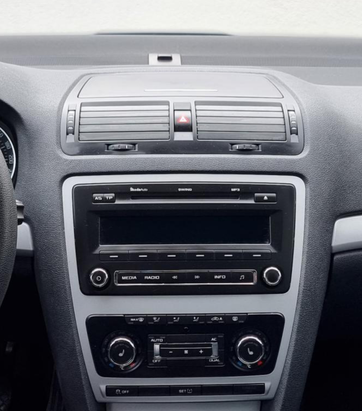

  3. Hey everyone, basically I'm looking at these videos of octavia's on YT, and I see that some has a touch screen, I have a 2011 Octavia but has this screen (in pic). I'm looking to fit one but idk if there will be issues compatibility wise, also is there a screen that would be a direct fit size wise?

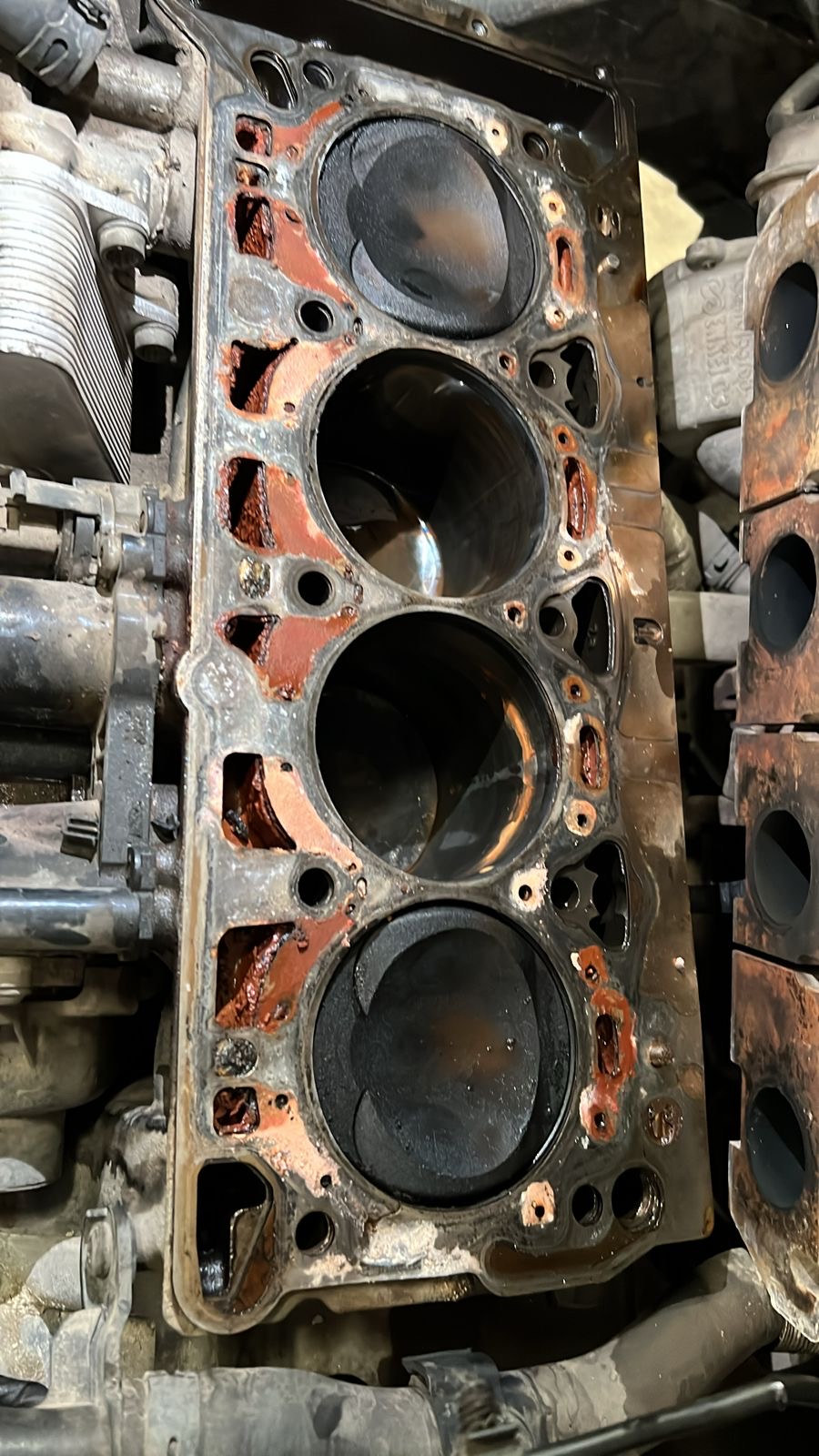

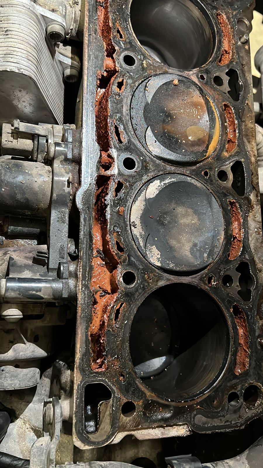

  5. I am having a hard time finding a donor engine, My engine code is CDAA and I can't seem to find one, Although I found plenty of Audi engines but with different codes like CDHA CDHB but they will be a pain to fit cause some little stuff is different.

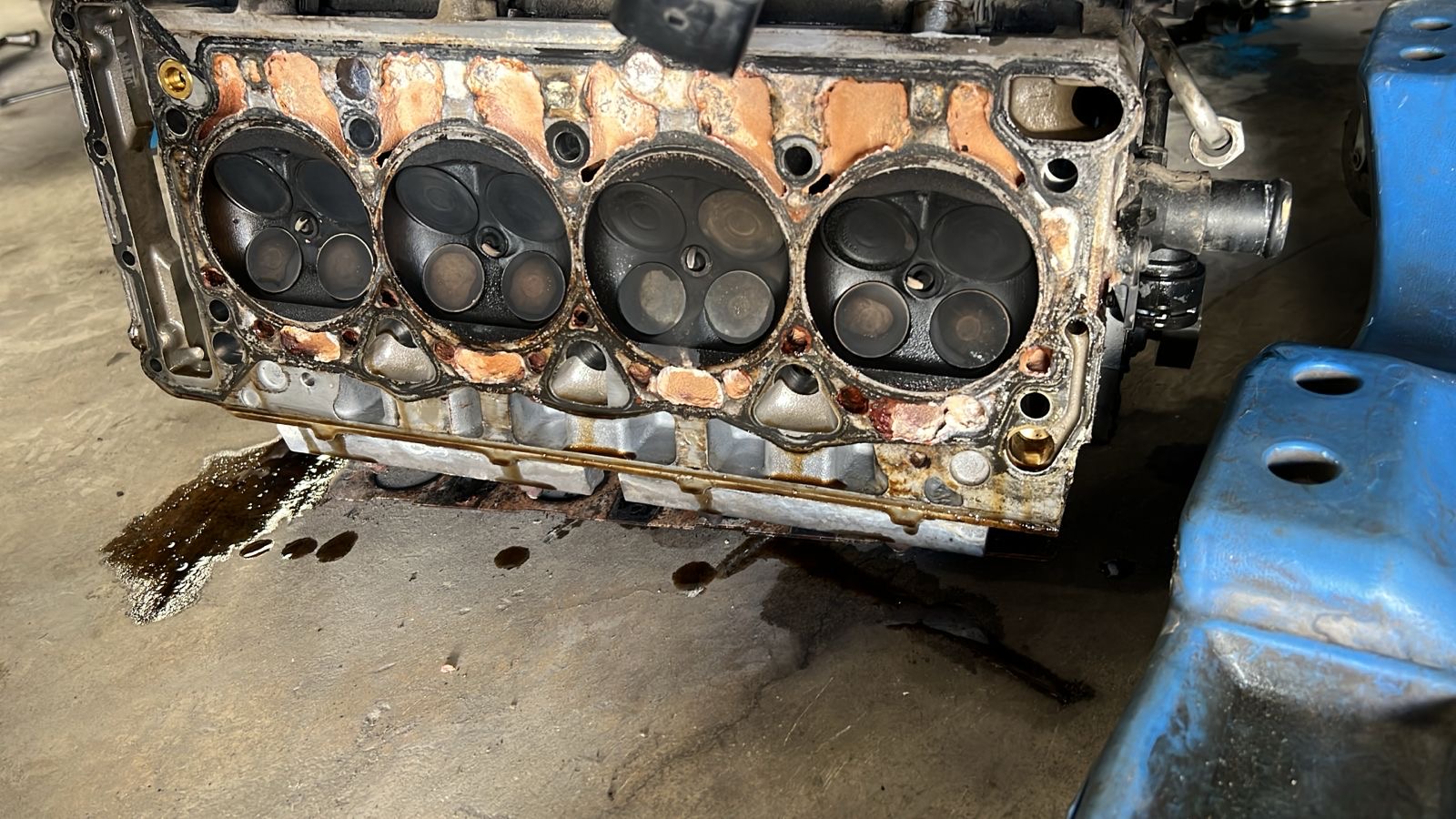

  6. Sorry for the late update, The damage is, but not limited to, The head from what I've been told is dead because of overheating, apparently the last week before I took it to the local garage the engine was running on almost no coolant because the water pump failed, also 2 valves shifted positions slightly. The water system is INFESTED with rust and it can't be fixed, the first owner of the car apparently used tap water as coolant since day 1 of buying it.
  7. Hello, So I bought this 1.8 tsi Octi 4 Months ago, Previous owner didn't take care of it that much, However, since I bought it I've been taking care of it, replacing a lot of parts for new ones and just regularly checking on the overall health of the car. but one thing I didn't check is the engine, Car only has 90k miles on it, no visible wear on the engine and no suspicious sounds either. Yesterday, EPC Light went off, hooked it up to a code reader and there was a Misfire in Cylinder #3, So I suspected it was either coils or spark plugs, switched them but the misfire is still in Cylinder #3, Then checked on the fuel injectors but they turned out fine. Today I took the engine apart and looked at the Damage, I'm in shock, should I fix it or just skip the hassle and buy a new engine?
