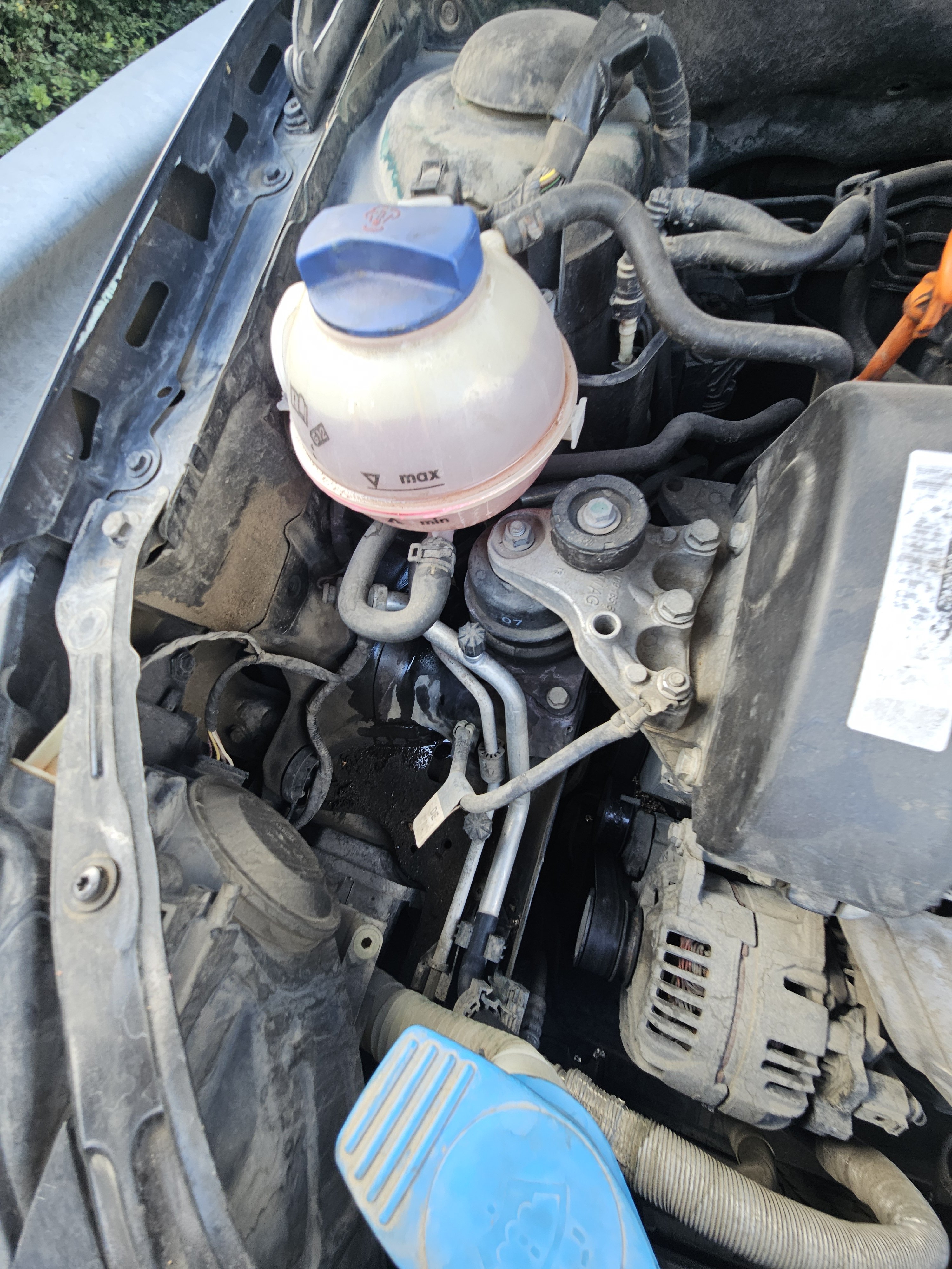

  8. I’m not near the car but here is where the level was. (Not when the engine is running)

  12. Now that you say this it seems that the speed gauge is also a little weird, it shows higher speed than the actual one (for example 30 instead of 45-50)
