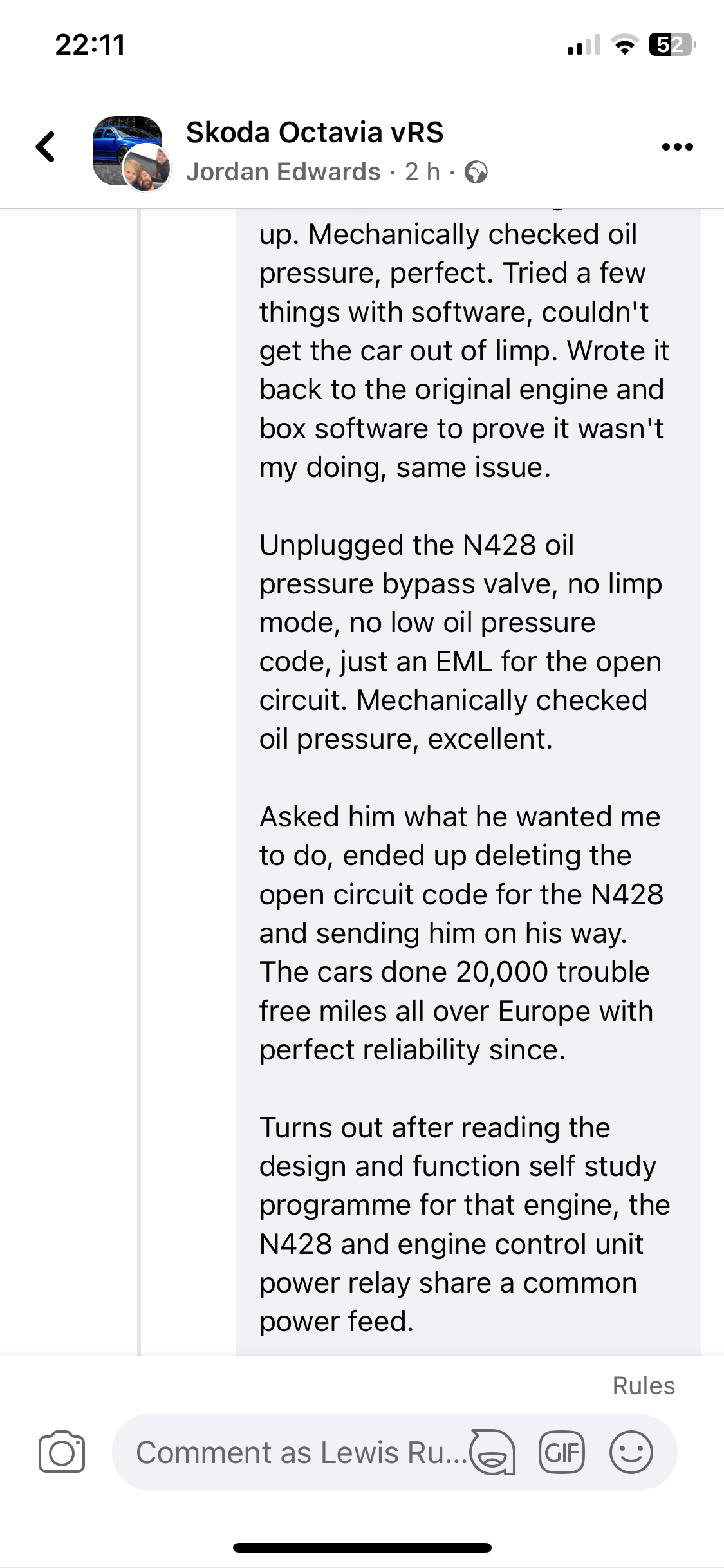

  1. The garage said it had been replaced before as it looks newer and had been replaced by a genuine part. The car is at 95,000 miles. @J.R. In regards to N428, I will try leaving it unplugged, and delete the error code myself, and see if there's any improvement. If there is, could be a pointer to that. I posted a thread above in which a mechanic said he unplugged it and re-coded it, and since then the car has done 20,000 miles problem free, so I deffo think it's worth a shot.

  8. Found this on Facebook, the original poster stated the issue I'd been having, tried changing sensors but no fix, this was one of the replies.
