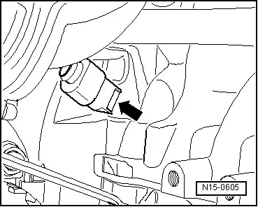

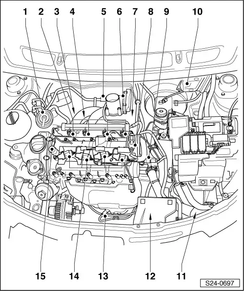

  6. So far I've collected this information: https://workshop-manuals.com/skoda/fabia-mk2/power_unit/1.6/77_kw_mpi_engine/mixture_preparation_system_electronic_inj.gas/fuel_injection_system/injection_and_ignition_system_overview_of_fitting_locations/ https://workshop-manuals.com/skoda/fabia-mk2/power_unit/1.6/77_kw_mpi_engine/mixture_preparation_system_electronic_inj.gas/fuel_injection_system/removing_and_installing_engine_speed_senderg28/ Where is that 7 arrow even pointing? I can't see anything that resembles the second two sketches, probably because it's behind some noise insulation. Again, where's that?
  7. Can you provide any more info? It's a CBZB engine. I'm currently scouring the net for details of the sensor's location, there has to be something somewhere, it's just not proving easy to find.
