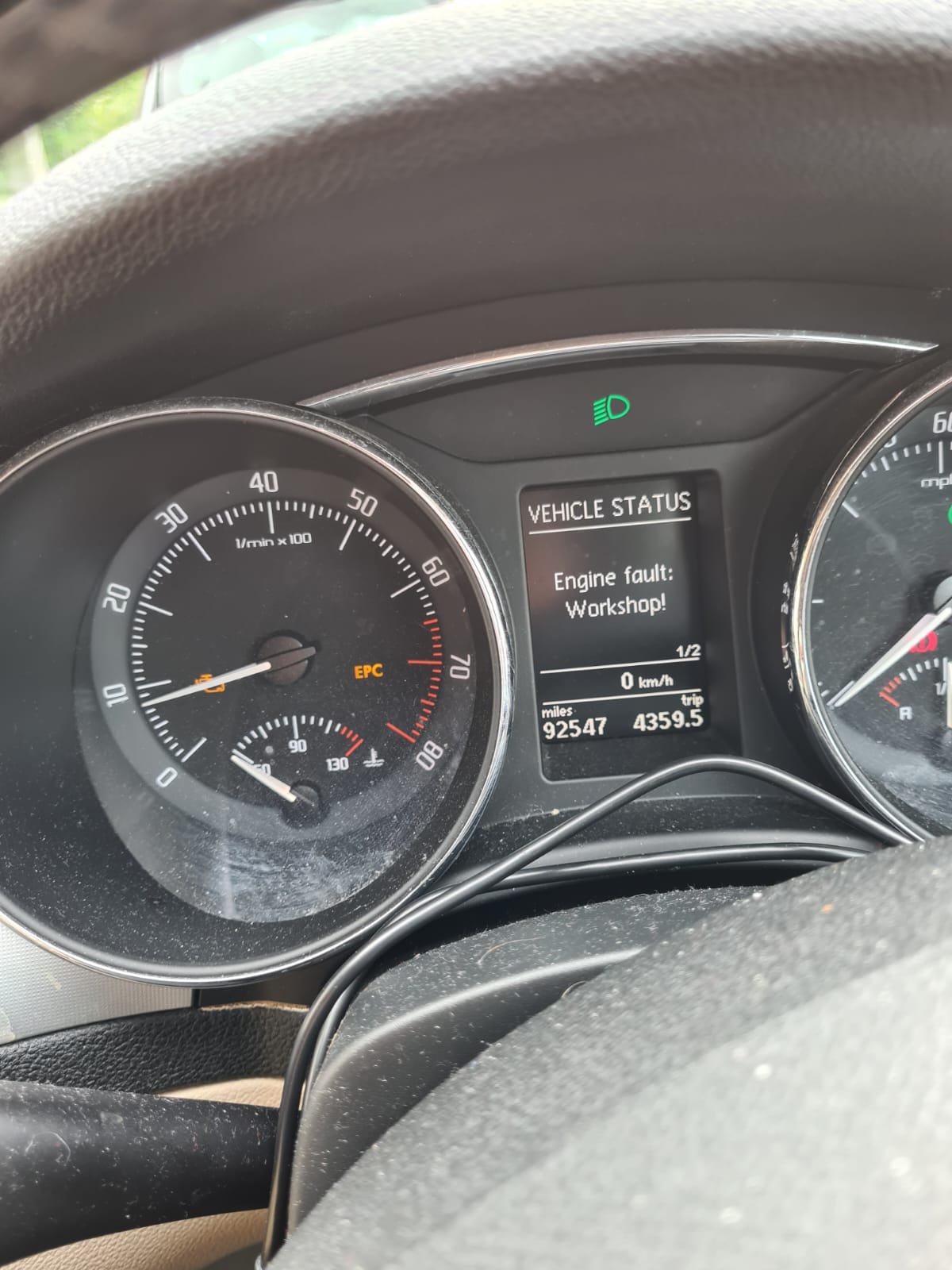

Hi all, Got an issue with my 2010 Skoda Superb 1.8 TSI (CDAB) and hoping someone might've had a similar issue or can offer some guidance. Started with a low oil warning a few weeks back – not ideal, but I topped it up and thought that’d be the end of it. But since then, whenever I put my foot down and it hits around 4000 RPM, the engine just falls flat on its face. Feels like all power is suddenly cut – it simply won’t pull. It doesn’t stall, just goes completely gutless. It’s consistent and repeatable under load. Only way I can deal with it is take the foot off the power, keep it under 4000 RPM and slowly build speed. After a couple of short test runs, the check engine light came on. Plugged in the scanner and pulled code: P2293 – Fuel Pressure Regulator 2 Performance. From what I can tell, that usually points to the high-pressure fuel pump struggling under load, likely not delivering enough pressure at the top end. No misfires or other codes, just that one. Feels like it’s fuel-starved, but only at higher revs. So far I've: Topped up oil (was a bit low, not dangerously). Monitored with a basic OBD reader. Checked for obvious fuel leaks – nothing visible. Read some forum threads on HPFP failure symptoms – sounds like a match. Other issues worth mentioning: There’s a bit of an oil leak around the engine – not pouring out but definitely losing oil. (I can't quantify how much, but it needs topped up fairly regularly. Hoping the garage can trace it. Something is rattling underneath – sounds like a loose heat shield or bracket. (I'm sure that is coincidental as it predates the issue) The car was recently serviced, including an automatic gearbox fluid change, so this isn’t a long-neglected motor. At this point, I’ve booked it into the garage, expecting they’ll confirm it’s the HPFP. Has anyone else had this specific issue? Is it usually the HPFP or could it be a sensor/fuel filter/regulator? Trying to avoid throwing parts at it if it turns out to be something daft. Cheers,

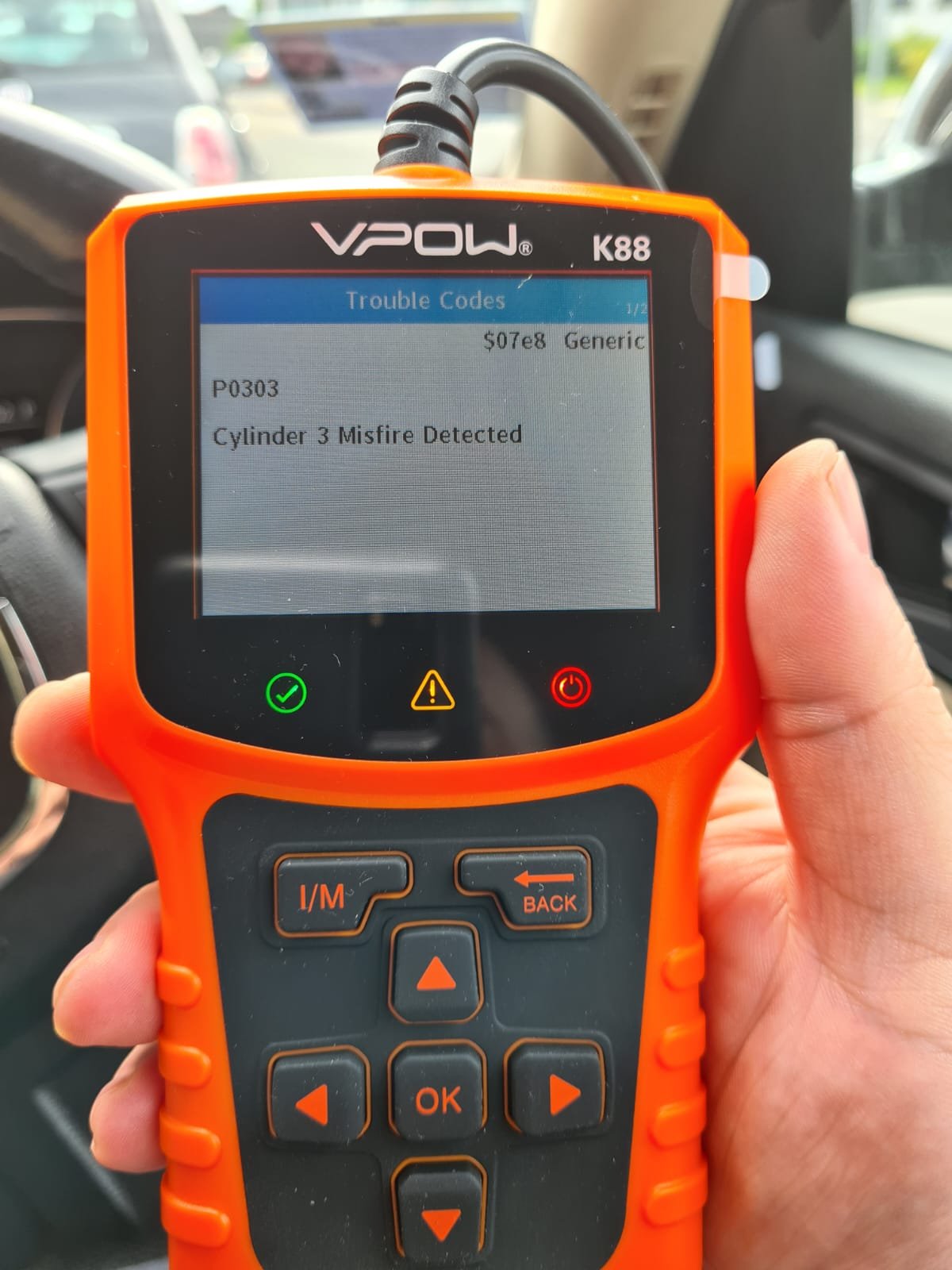

Okay, so within a month, the error came back again. Hi everyone, I wanted to provide an update on my ongoing issue with the cylinder 3 misfire on my 2011 Skoda Superb Mk2, 1.8 TSI DSG Elegance estate. After my last post on 15th July, I replaced all the spark plugs, and the ignition coil for cylinder 3 was also replaced. Unfortunately, the problem reoccurred around a week ago. This is now the third time the spark plug on cylinder 3 has blown since I bought the car in December last year. To address some of the suggestions: Compression Check: I haven't done a compression check yet, but I agree it might be a good next step to understand if there is a deeper issue with the engine. I'll make sure to have this done during the next garage visit. Oil Consumption: The car does consume a bit of oil, but it hasn't been that bad over the last few months. Given the recurring nature of the problem, I've decided to book the car in for a comprehensive diagnostic at a Skoda dealership. I'm hoping they can pinpoint the root cause and provide a long-term solution. If anyone has experienced a similar issue or has additional suggestions on what might be causing the repeated spark plug failures, I would greatly appreciate your input.
Cylinder 3 misfire Skoda Superb 1.8 TSI
So it was a combination of spark plug and ignition coil. Single cylinder. I saw the spark plug that came out and it was burnt out. These plugs were only six months old so maybe it was a dodgy plug, or maybe indicative of a larger issue. I'll know in time. This is the second spark plug issue I've had in six months. I don't know if it was the same cylinder last time. So I'll keep am eye on it and see if it reoccurs, if it does it might signify a larger issue. I'm writing this to help anyone else who might be searching for answers getting a similar issue.
