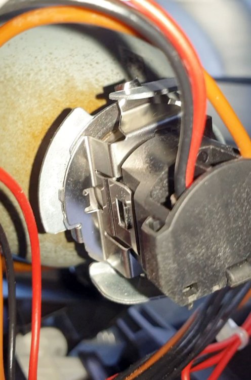

Today I learned... ... My Fabia has TWO off-side rear side light bulbs!!! 😒 Having nothing better to do today (well, nothing vitally important, anyway) I decided to check all the connectors to see if there were any loose wires or corrosion on the pins etc that might be causing extra resistance, since each light cluster was showing a working bulb. Thankfully I started on off-side rear, because, after removing the light cluster and separating the connector, I used a multimeter to check continuity. I looked at the different colours going to the bulbs and saw one that had black and brown wires, which I checked and they were OK. Then I happened to notice that there was another bulb with black and brown wires. I took that one out and, lo and behold, the bulb was blown!! I have no idea why I didn't spot this before when I was checking them, the only thing I can think of is that, having checked one (which was OK), I simply didn't consider the fact that there might be another one. Anyway, I replaced the blown bulb and, Huzzah!, I stopped getting the faulty light warning. So if anyone ever has this issue again and finds this thread, check BOTH bulbs...! 😳

Well that was quick and painless, thankfully! 👍 It turned out that, when the Turbo Actuator arm was replaced a couple of years ago (before I got the car) the housing hadn't been put back quite right, so it was rubbing on the arm and it had caused enough friction to register as a fault. A couple of minutes with a screwdriver and pliers and it was moving freely again Whilst having my own OBD reader might have told me the problem, I wouldn't have known where to look, so that's £60 well spent.
