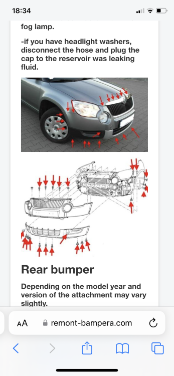

  3. Hi everyone, after 4 years owning my yeti, some nice soul has bumped my front passenger corner, I have sourced a new headlamp, I started to take the bumper off, all underneath wheel arch liner screws, I am now a bit stuck! I’ve looked at a diagram and there seems to be torque screws under the headlamp. Or am I looking wrong? Am I best taking the car a garage to fit the light or is it easier than it looks? Any help would be most appreciated. Thanks
