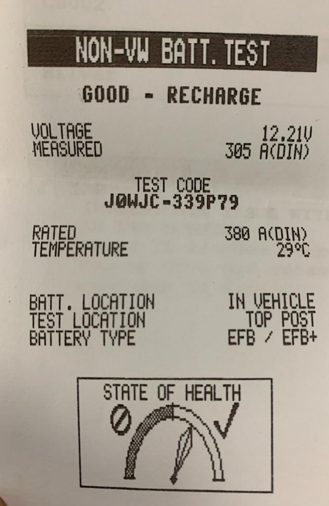

  1. UPDATE : There is a Corrosion found at the grounding wire which comes out from the Engine. When cleared out the Corrosion it works well they're saying. Could anyone please help me to find out is that can be a real reason ? Does this make sense ? Thanks in Advance.
  2. Yeah. I have just checked on the terminal. It's 02/14
  3. Thank you for your response. I did a battery check with Skoda couple of weeks back for some other reason and this is the result. They said the battery condition is good. It's 9 year old battery if I am not wrong.. Could you please let me know Shall I conclude that the battery isn't bad at the moment ?
