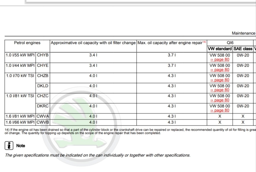

  9. I always change Oil/Filter every year regardless of mileage (I'm always under 10,000), so in this case best option for me is 502/505? What is the detriment of using long life oils on short intervals? (ie, is 508/509 and 504/507 not worth touching in future?)
  10. Nah prior to 2021 it shows 504/502 both as potential options. So what actually changed between these years? Was the change in reccomendation just to meet fuel efficiency?
  11. My copy of the manual only says after MY 2021 508. Made a mistake when i said 2020 Mine is a mk3 from 2021
  12. I tend to change every year regardless of mileage (always well under 10,000) I have always used 508 as its the only listed one in the manual for my 1.0mpi after M/Y 2020. Is this not best practice? I'm trying to prolongue these engines as long as I can
  13. Hey thanks for the response. I have only really been using 508 the last few years as that's what it says in the service manual for M/Y 2020 onwards with no alternative like the previous years. Would you say its still better to use the previous 504 or 502 standards? Edit: to add context, it's 1.0mpi engines we have
