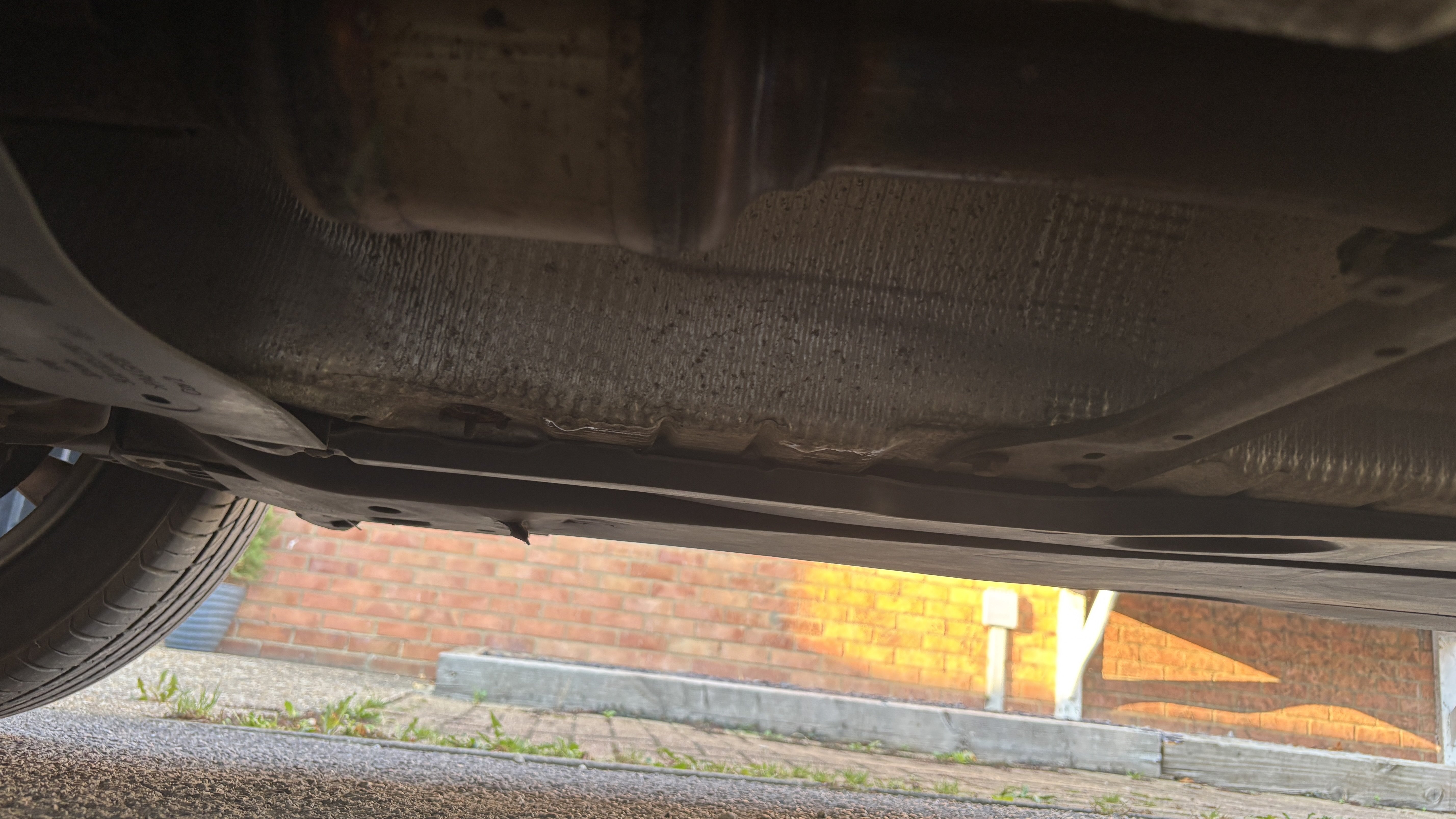

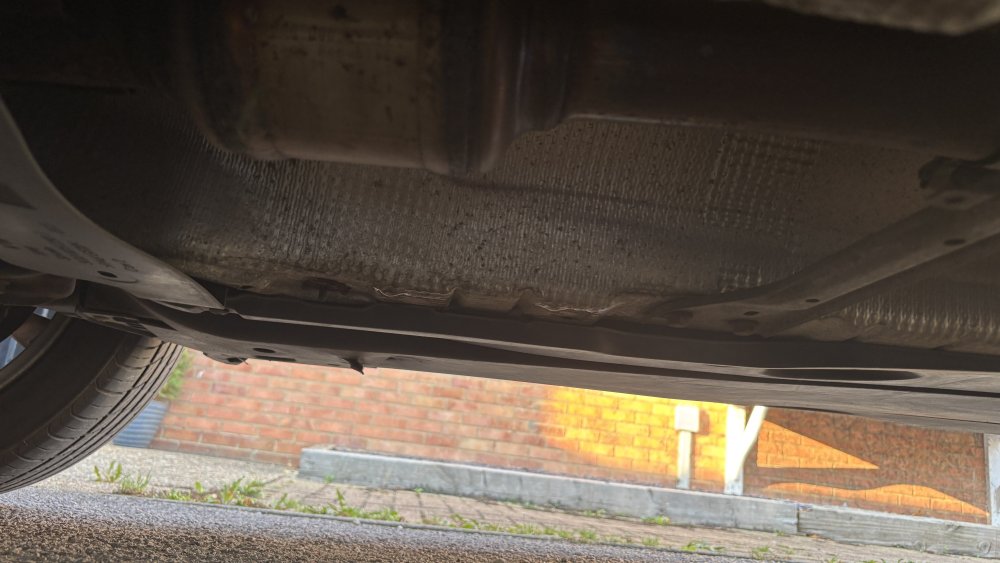

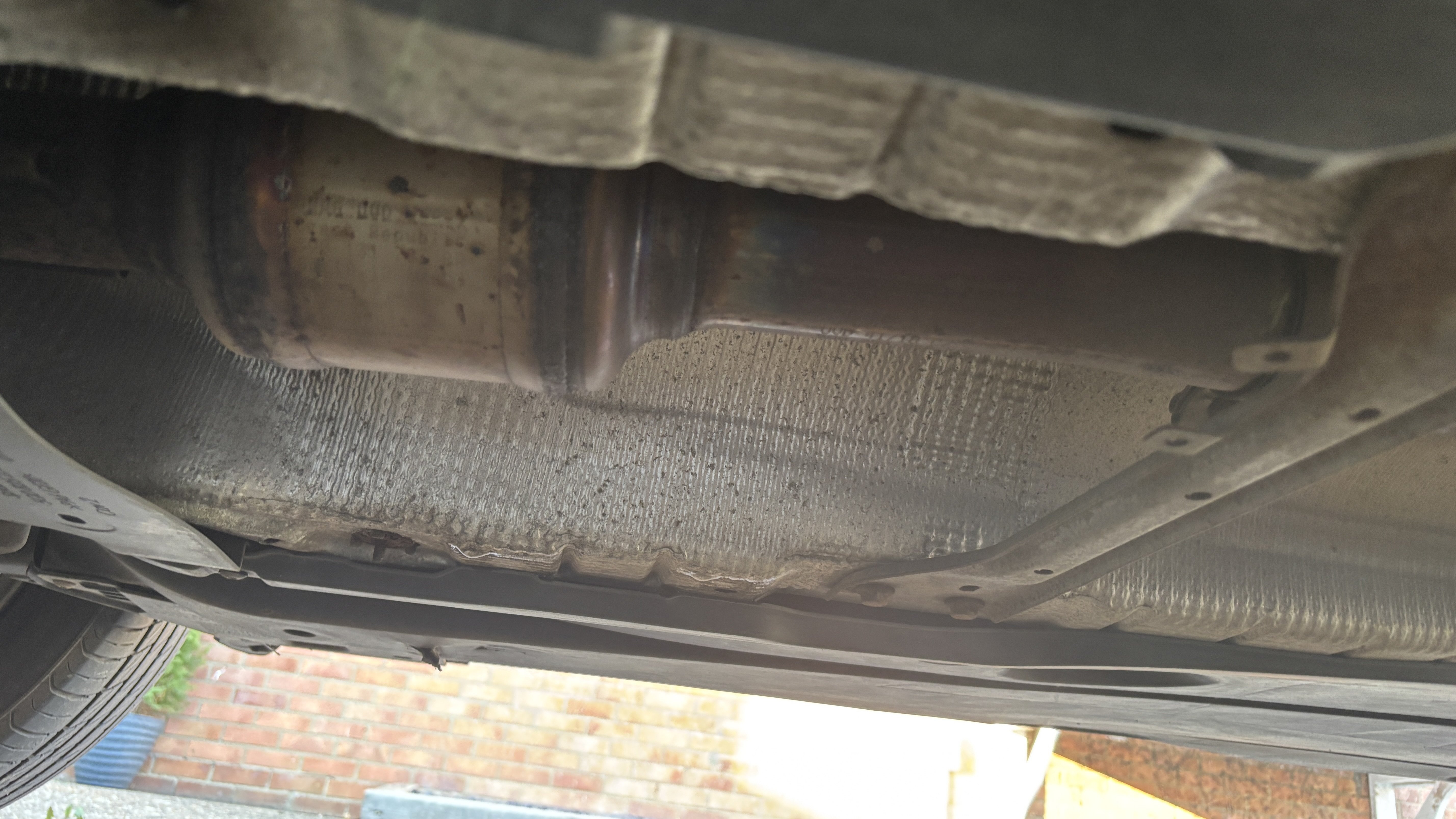

Leak under car
Oh thanks Mick, that kinda makes sense.Aircon condensation would make sense
Leak under car
Hey all, wondering anyone can help.I have started noticing a pool of liquid under where the car is parked daily. i tried to have a look under the car and I can see drops dropping down off a grey bit of the underside of the car but not sure what this is. i am not sure its oil because i have noticed this for while so would think we would have noticed a low oil warning by now. if you zoom in below you can see the droplets forming on the grey bit. any thoughts ?
