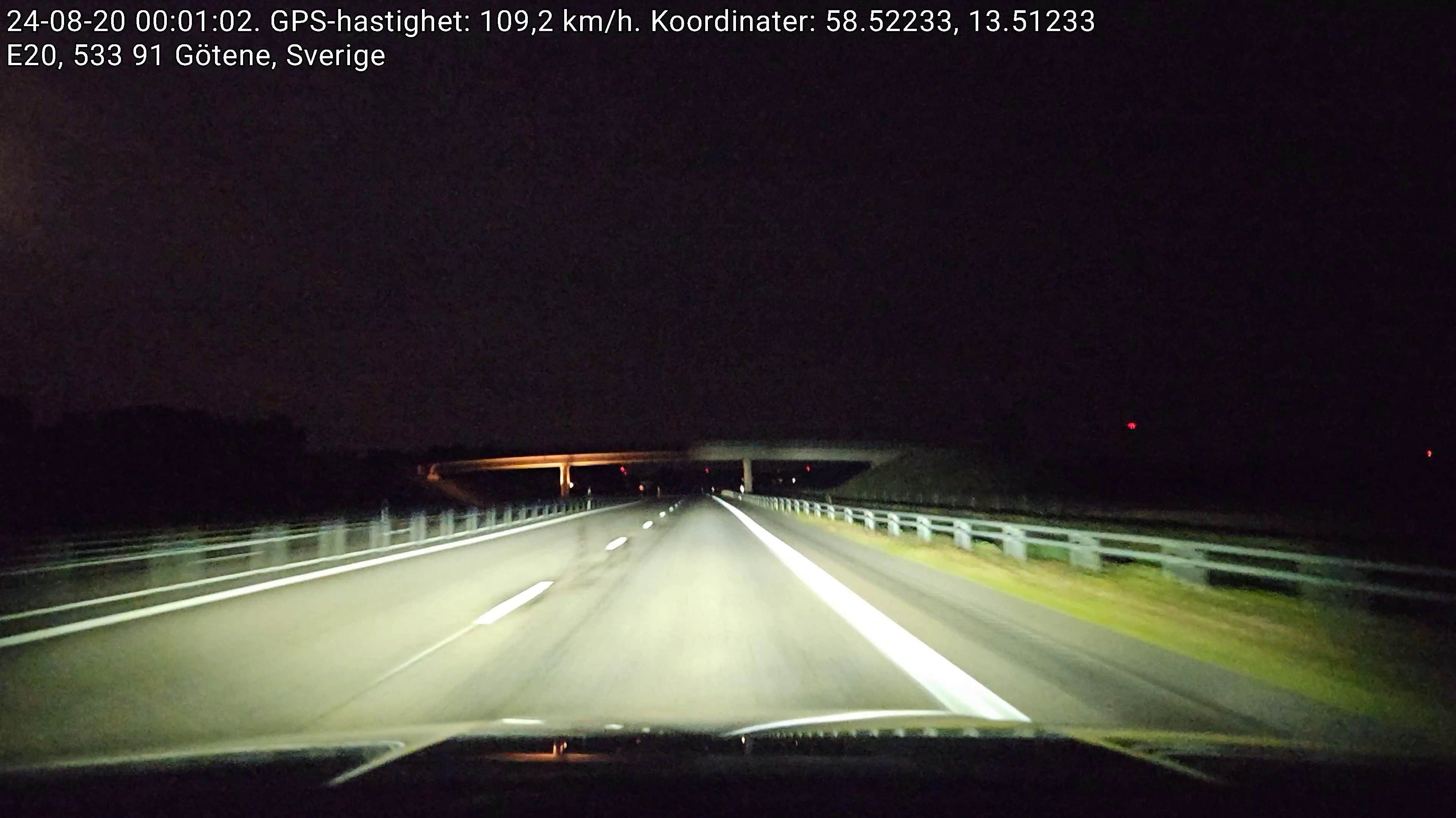

  1. Yeah, i can understand that. But the 1+2 roads i cannot. I dont see the connection between full beam and the cornering lights. And just to be clear: Without dynamic cornering lights active: 1 lane= Full beam. 2 lanes= Full beam With dynamic cornering lights active ; 1 lane= Full beam 2 lanes= left side of full beam off and the moment it becomes 1 lane it turns back on. (It´s off for the entire duration it´s 2 lanes)
  2. Hi, I have a Octavia from 2021 with the dynamic light assist. On highways it shuts off the full beam on the left side of the road (From sweden so right side traffic) and the left side stays off for the remainder off the highway. Does not matter if i have drive on an empty road. And if i have the Dynamic cornering lights active and drive on a 2-1 road on the side with 2 lanes it also shuts of the left full beam. But if i drive on the other side with 1 lane it works. If the dynamic cornering lights is not active i have full beam on both sides. I´m told by a skoda dealer that it´s the way it should work, Can other Octavia drivers confirm? A few youtube clips showing the problem. Bad quality tho. Entering motorway: https://youtu.be/6uTvE6MSr5A?si=okjhsax2ZhMwHW2N 2-1 road goes from 1 to 2 lanes: https://youtu.be/Pfd7AJR-B-A?si=bopjeTL5dGd7q-Ex And this is how it looks:
