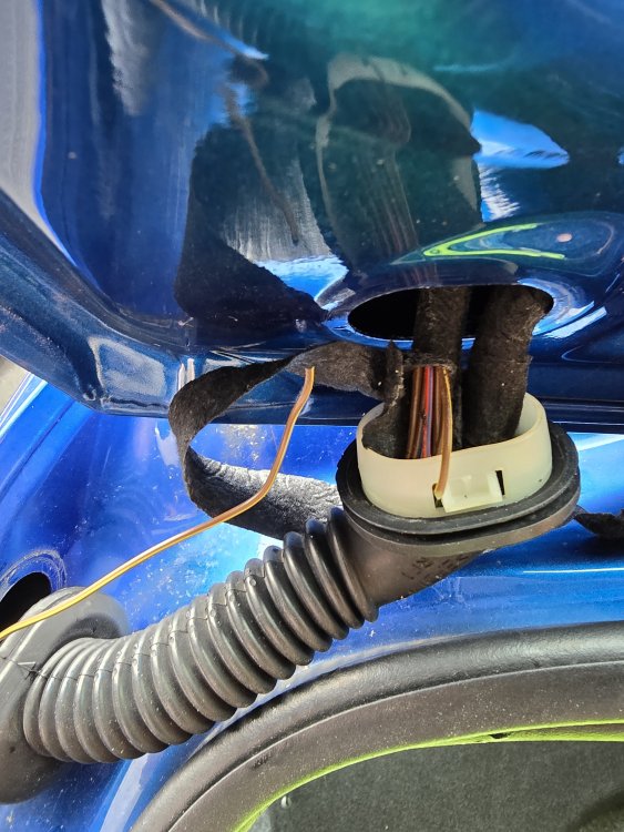

  1. You keep mentioning 'locking' in both your post which is perhaps where your getting confused. It's unlocking the vehicle and double unlocking with the remote key. Good news is that I've fixed the issue. The problem was caused due to a break in the brown/yellow signal wire between the button and the control unit J519. The actual break was within the left side rubber tubing between door and chassis. A new strip of wire, a bit of solder, some heat shrink tubing and all is good as new. Thanks for your advice nta16. I hope this helps someone in the future with similar issues.
