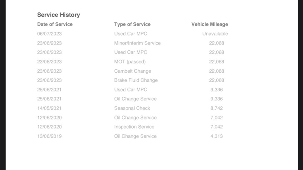

  4. @toot Indeed I agree, 3 MPCs seem a bit confusing for two keepers. But a lookup of last v5c issue date shows Aug 2021 and the original registration as Jun 2018. These dates also align with the vwfs service plan history on the vehicle. They perhaps did an MPC twice in a span of 2 months in 2023. Will clarify the reason with the dealer - Richmond Motor Group in Southampton I did read about the recent change in guideline for cam belt. So not sure if i should consider myself lucky or not. I do hope the cam belt change was a proper one.

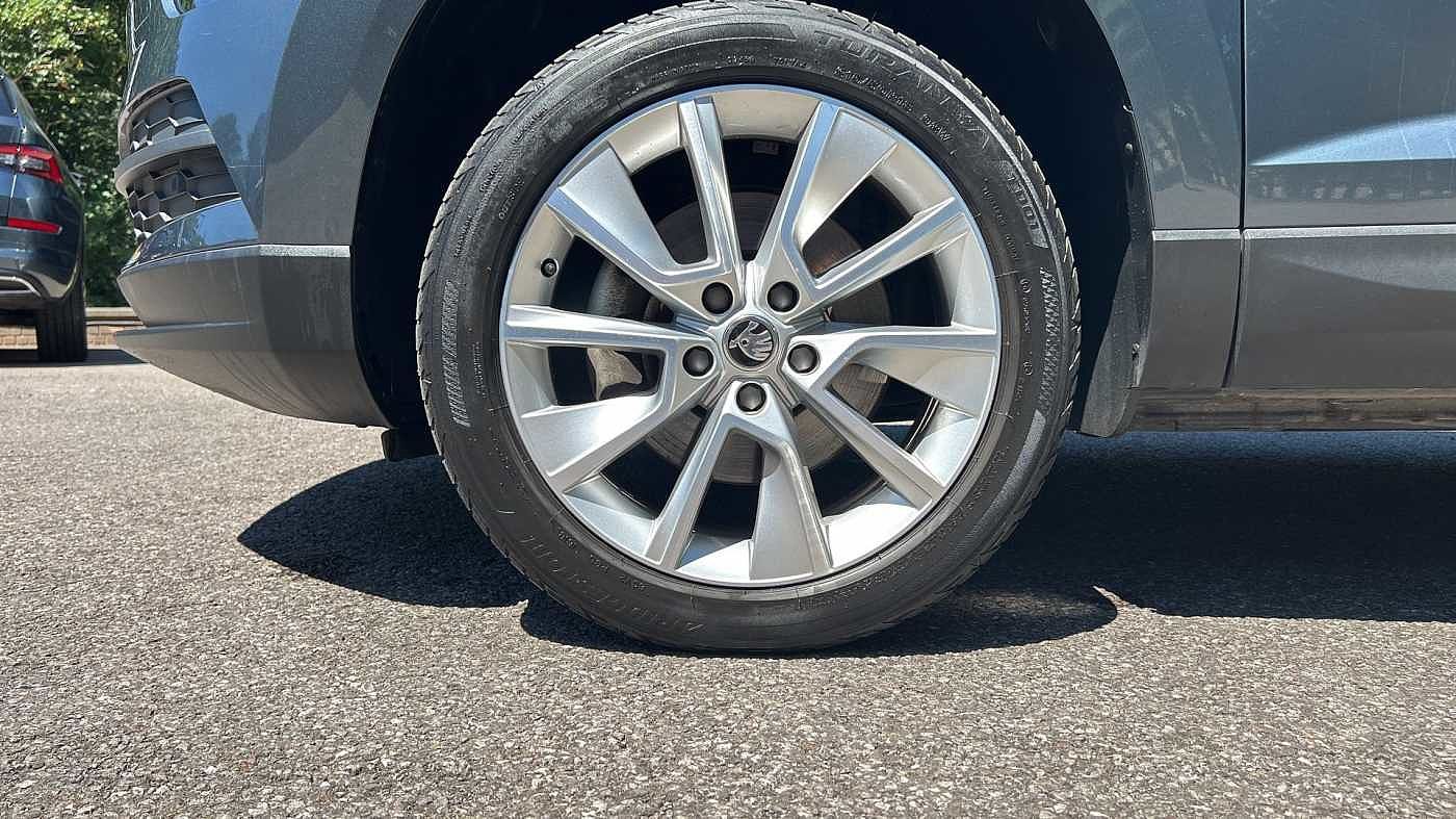

  6. Interiors looked well maintained and not too aged. To be honest haven’t really focused on pedal rubbers , but will do it next . Will watchout for the condition of break pads and tyres depth. How do I verify the condition of the discs ? Sorry not too familiar on this ☹️ thanks ever so much for your suggestions.

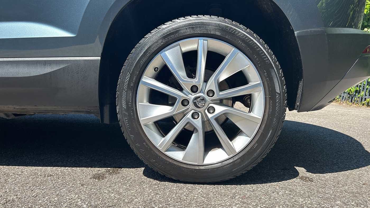

  8. Thanks @skomaz They come with Bridgestone Turanza T001 (seems okayish ) . Will check further for breakpads indeed. Anything specific to lookout for with breaks/tyres?
  9. Hello there ! New to forum here. Wanted help from experts regarding an approved used karoq purchase which I am about to make. model : 2018 karoq 1.5 TSI SE L DSG mileage - 22.5k i can see the car has had a cambelt service and break fluid change. No transmission or engine oil changes done recently mentioned as per service history. Shouldn’t I insist this be done too due to the 5 year age ? Any other must-do before the deal? Service history attached.
