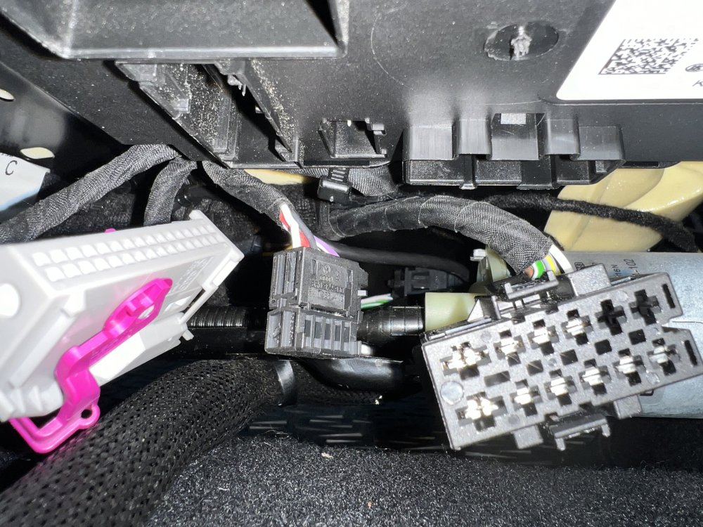

  1. No luck. Wire was fine. Back to square one. Defeated
  2. Thank you think I found it. white wire looks damaged. Will pull the seat out over weekend and repair and see how that goes. Hopefully after wire repair module chances automatically to 36.

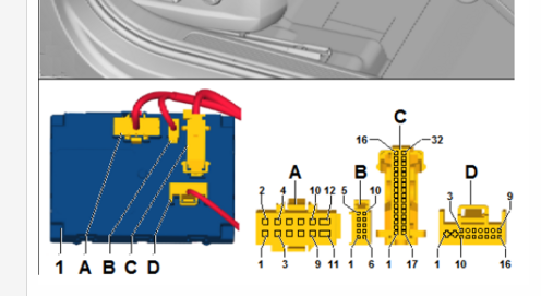

  3. Hi ApertureS thanks for your post, ok will look at the wiring. Is it that ground pin that determines if its a 06 or 36 ? Do you have anymore info on that? Also when how do i run the basic settings and renenabling the memory? I havent changed anything yet from a coding perspective just read the codes. Carlo Do you know what connector has the grounding pin?
  4. Hi ApertureS thanks for your post, ok will look at the wiring. Is it that ground pin that determines if its a 06 or 36 ? Do you have anymore info on that? Also when how do i run the basic settings and renenabling the memory? I havent changed anything yet from a coding perspective just read the codes. Carlo
  5. Hi everyone, i have a problem that im trying to figure out but its kicking my azz. I recently purchased a 2016 (MY17) Skoda Octavia VRS wagon. Love the car.. But I'm having issues with the memory seats. for some reason the the presets don't work. I do know how to use them i also have a golf exactly the same. I notice that after the scan i should have found a module 36 Seat Mem Drvr but instead if found the 06 front passenger seats? I do note that there is not presets on the front passenger seat? 06. Front passenger seat Application data identification: 0201 Manufacturer spare part number: 5Q0959760B Manufacturer ECU software version: 0020 System supplier identifier: Kostal ECU manufacturing date (ASCII): 001 ECU serial number: Y0006PFU14281 Manufacturer ECU hardware number: 5Q0959760B System supplier ECU hardware number: 10121326 System supplier ECU hardware version: H08 System supplier ECU software number: 10121326 System supplier ECU software version: APPL: 0020, FBL: 0010 System name: Sitzmemory Calibration repair shop code or equipment serial number: 000000000000 Calibration date (ASCII): 000101 ODX file id: EV_SeatMemorPasseSide HW ver.: H08 ASAM ver.: 002021 ECU manufacturing date (HEX): 303031 Programming date (HEX): 3551303935393736304220 Calibration date (HEX): 000101 Long Coding: 001000000000000001A481808080000000008181000000F400 When i go into the infotament system and select seats i get the message function not available Here is my thinking! some how has the ECU changed to from an 36 to 06 think it has a passenger seat memory function? how do i fix this can i simply change the long code on the module to Coding: 00 14 00 00 00 00 05 00 01 82 80 80 80 80 00 00 00 00 81 81 00 00 00 D4 00 I did also scan for issues and did find some gateway codes? Car Scanner ELM OBD2 Version: 1.101.0/1.101.0/iOS DTC report Connection profile: Skoda OBD-II / EOBD 1.0L-2.0L TSI/TFSI CAN-UDS + AT/DSG (PQ26, MQB, MLB, MSB, etc.)Date: 10/31/2023 7:01:37 AM VIN: TMBKE9NE8H0044455 ============================ OBD-II No DTC found. ============================ 19. CAN Gateway19. CAN Gateway DTCs: 3 ---------------------------- 131660 [0x02024C] U020800: Lost Communication With “Seat Control Module A” Timeout_Node_0x4C_DiagAdress_36_SitzMem_FS U020800: Lost Communication With “Seat Control Module A” Timeout_Node_0x4C_DiagAdress_36 Status bits: 1 Priority: 2 Frequency: 1 Unlearning index: 1 Odometer: 96176 km Date, time: 2023.10.29 13:51:33 Status: Test failed, Confirmed ---------------------------- 66304 [0x010300] U112400: Data bus, Additional installations detected Data_Bus_Commponent_List_detected Status bits: 1 Priority: 2 Frequency: 33 Unlearning index: 2 Odometer: 96176 km Date, time: 2023.10.29 13:51:33 Status: Test failed, Confirmed ---------------------------- 8531970 [0x823002] Archive (inactive) U140600: Static current, too high Electric_current_Upper_Limit_Value_Exceeded Status: Confirmed ============================ 09. Onboard supply control unit09. Onboard supply control unit DTCs: 1 ---------------------------- 06410 [0x00190A] Archive (inactive) B12D115: Right turn signal light bulb, Open circuit/short circuit to B Blinkleuchte rechts Seite-Unterbrechung / Kurzschluß nach Plus Status: Confirmed ============================ 06. Front passenger seat06. Front passenger seat DTCs: 4 ---------------------------- 9654868 [0x935254] B135254: Lumbar support fore/aft adjustment motor, No basic setting Motor für Lordosenlängsverstellung - keine oder falsche Grundeinstellung/Adaption Status bits: 1 Priority: 4 Frequency: 1 Unlearning index: 1 Odometer: 96176 km Date, time: 2023.10.29 13:51:25 Status: Test failed, Confirmed ---------------------------- 9654612 [0x935154] B135154: Lumbar support height adjustment motor, No basic setting Motor für Lordosenhöhenverstellung - keine oder falsche Grundeinstellung/Adaption Status bits: 1 Priority: 4 Frequency: 1 Unlearning index: 1 Odometer: 96176 km Date, time: 2023.10.29 13:51:25 Status: Test failed, Confirmed ---------------------------- 10489856 [0xA01000] B201000: No basic setting keine oder falsche Grundeinstellung/Adaption Status bits: 1 Priority: 7 Frequency: 1 Unlearning index: 1 Odometer: 96176 km Date, time: 2023.10.29 13:51:25 Status: Test failed, Confirmed ---------------------------- 9556265 [0x91D129] B11D129: Coding pin, Implausible signal Codierpin unplausibles Signal Status bits: 1 Priority: 4 Frequency: 1 Unlearning index: 1 Odometer: 96176 km Date, time: 2023.10.29 15:27:45 Status: Test failed, Confirmed ============================ 08. Heater and climate No DTC found. ============================ 17. Dashboard17. Dashboard DTCs: 1 ---------------------------- 16777020 [0xFFFF3C] Archive (inactive) U111000: Function restriction due to communication interruption BAP_TEL_0x28 keine Kommunikation U105400: Information electronics control module 1, No Communication TEL_0x28 communication error bap_error_timeout heartbeat Status: Confirmed ============================ 42. Driver door electronic equipment No DTC found. Is this related I really need someone who an translate this for me. Thank you in advance Carlo
