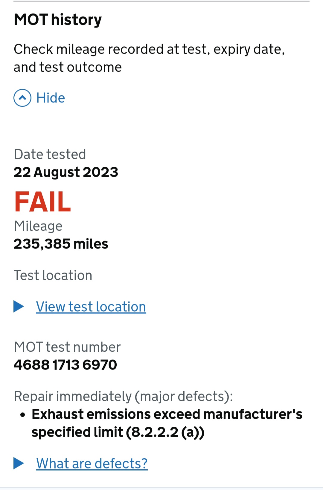

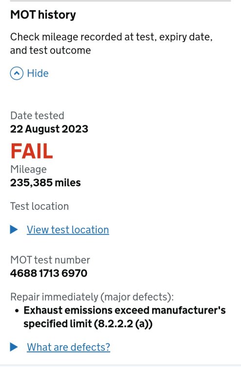

  10. This was what the car failed it's MoT on. Once boost came on, the car was belching out black smoke and after cleaning the dpf, egr and all pipework, it puts out the small amount of smoke as you can see in the short video posted. I don't personally have access to VCDS, so I'm trying to get the things done that I can do myself. Cleaning out the turbo should have been on my list, as I cleaned all pipework feeding it from the egr and it was full of solidified gunk. Sadly, I forgot and it now being mentioned will have me doing it later.
