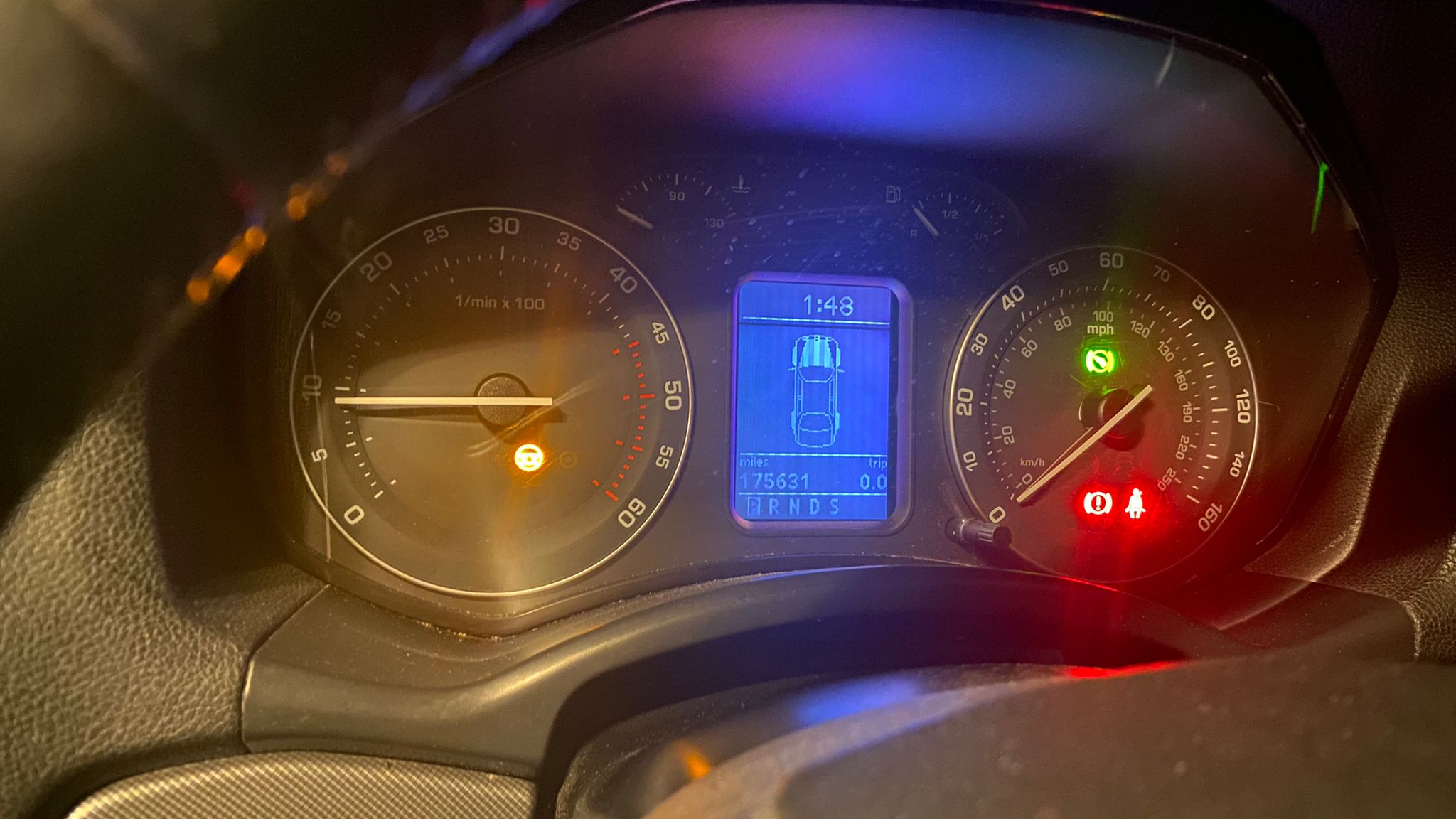

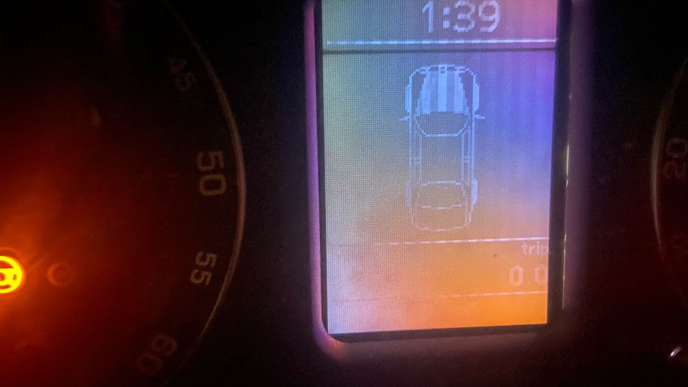

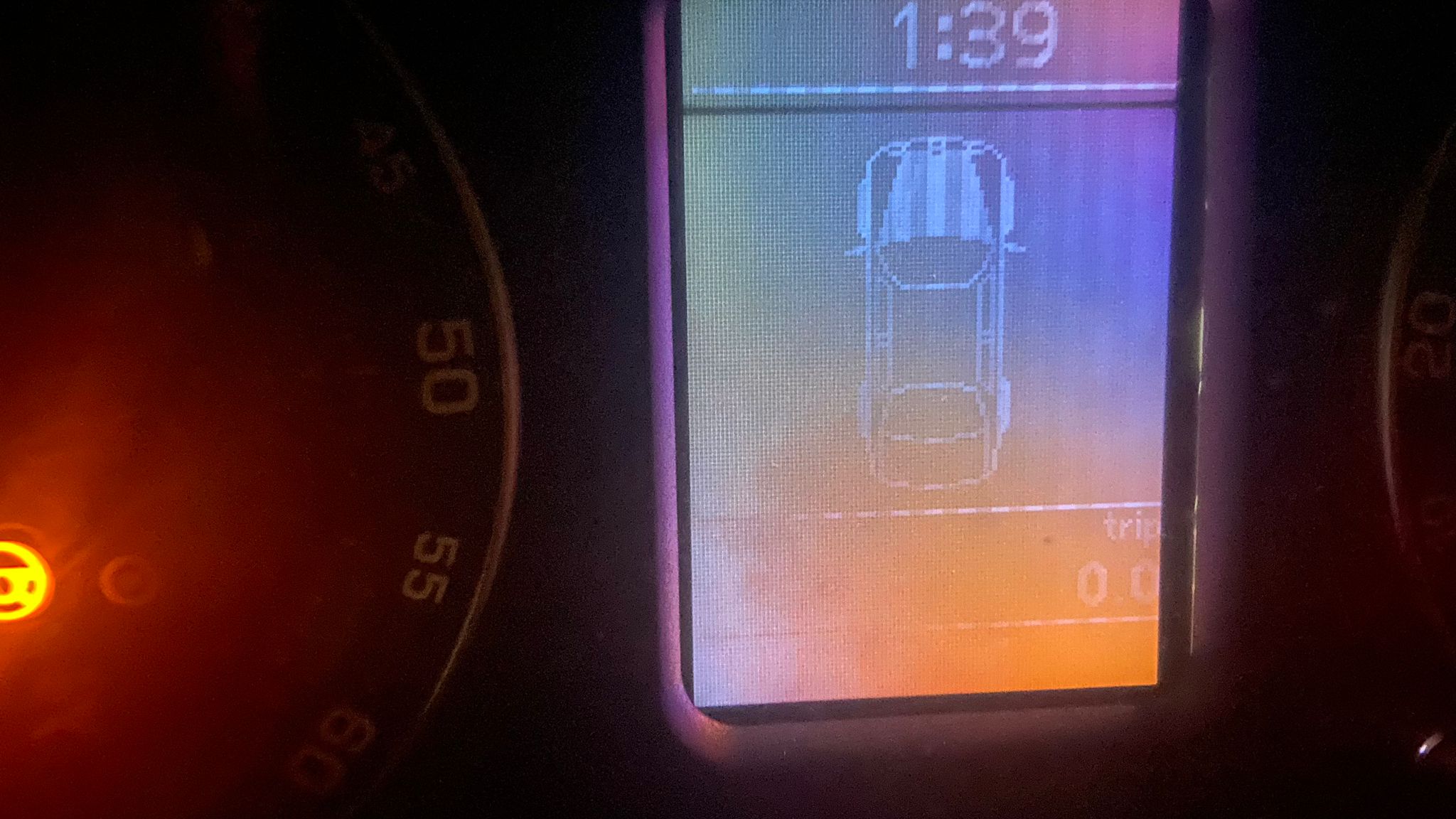

  1. Thanks, I got a {12V/6Amp Car Battery Charger, Smart Fully Automatic Battery Charger with Pulse repair function} online, disconnected my car battery and charged it in the house while on repair mode for 24 hrs. I put it back to the car, The display was dark at first, but it slowly got clearer over time. It helped to reset the connection and resolve the problem, some settings were lost on the car, and it just light up a steering error when I reconnected the battery.

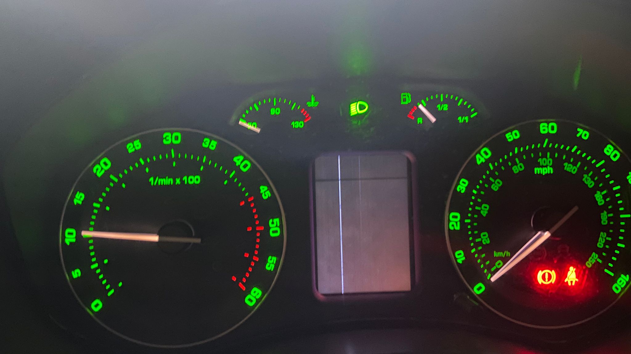

  2. Problem with my SKODA OCTAVIA LCD display, i have not used the car for some time, today, I turned the ignition on and the screen was black with one line, i tried turning the ignition on and off , that didn't solve it. Disconnected battery also for 1hr, that didn't solve it either, no settings were lost on the car, and it just light up a steering error when I reconnected the battery, and now it got more white lines . Does anyone else have this problem and any possible solution?

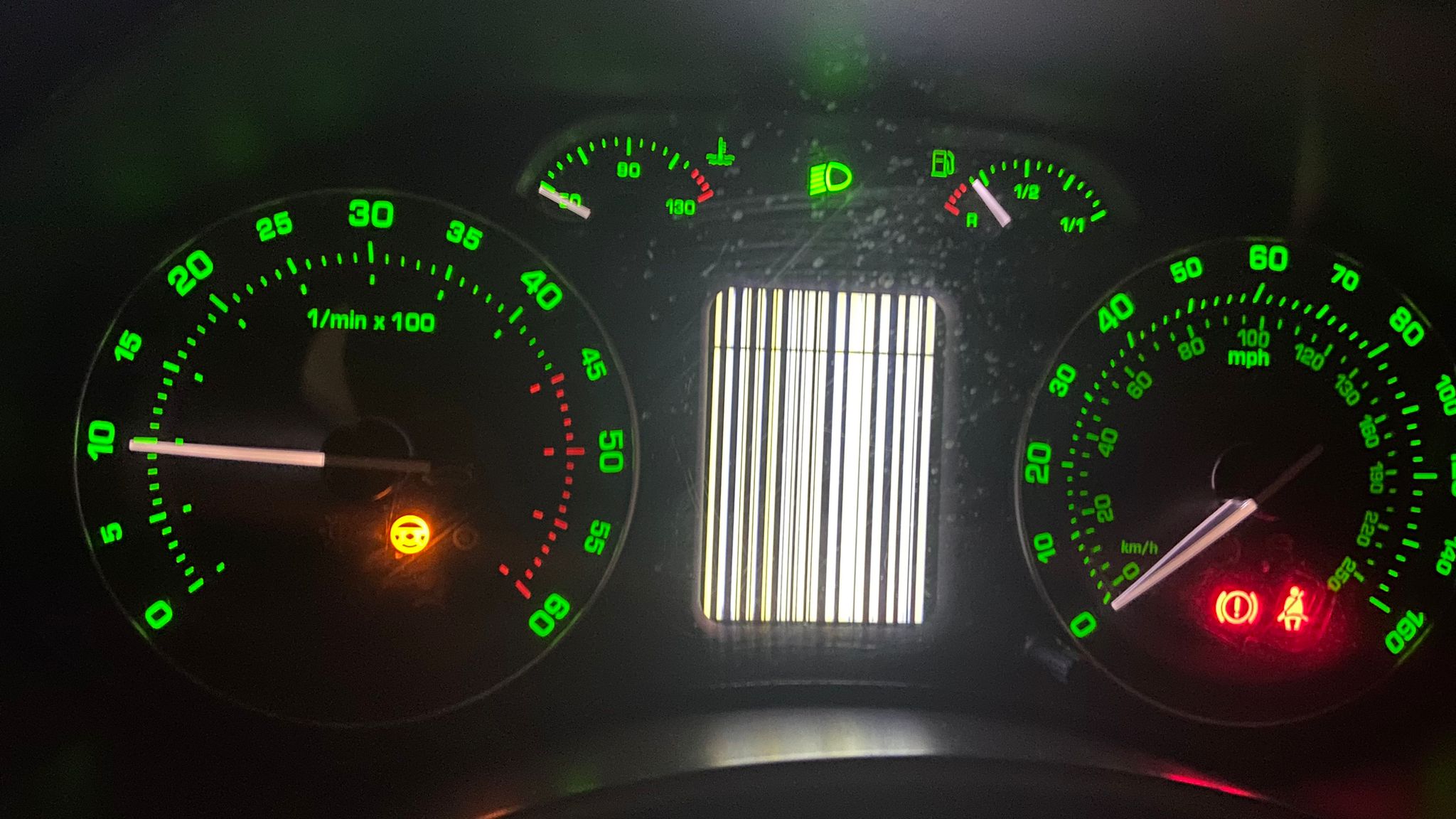

  3. Same problem with my LCD display, tried turning the ignition on and off , that didn't solve it. Disconnected battery also for 1hr, that didn't solve it either, no settings were lost on the car, and it just light up a steering error when I reconnected the battery, and now it looks more white lines . Does anyone else have this problem and any possible solution?
