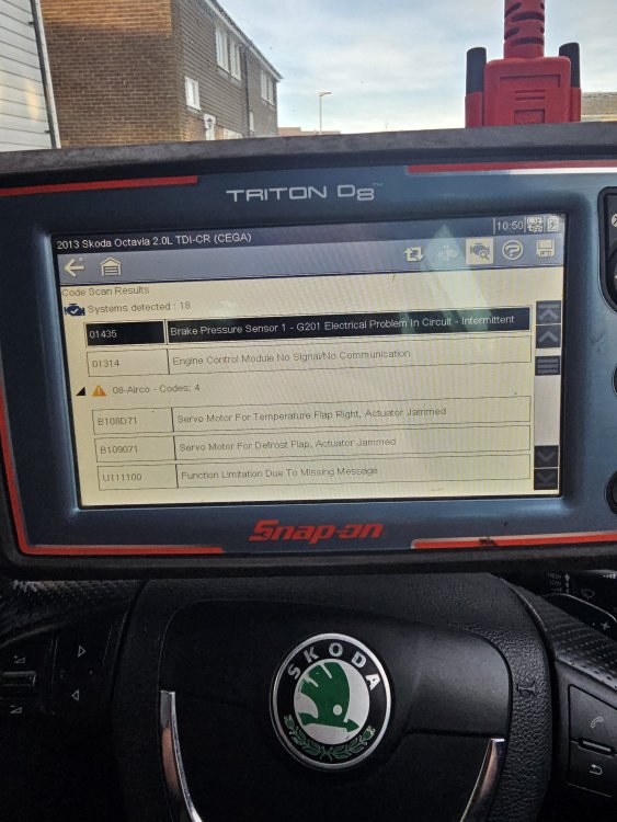

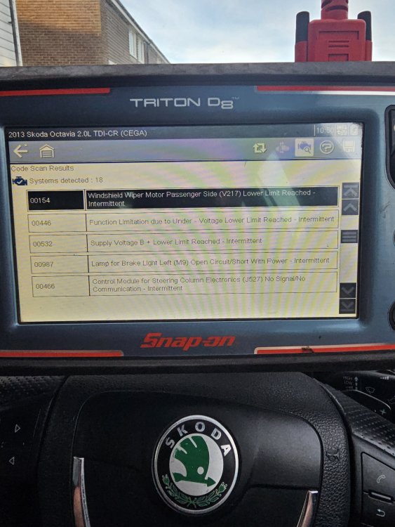

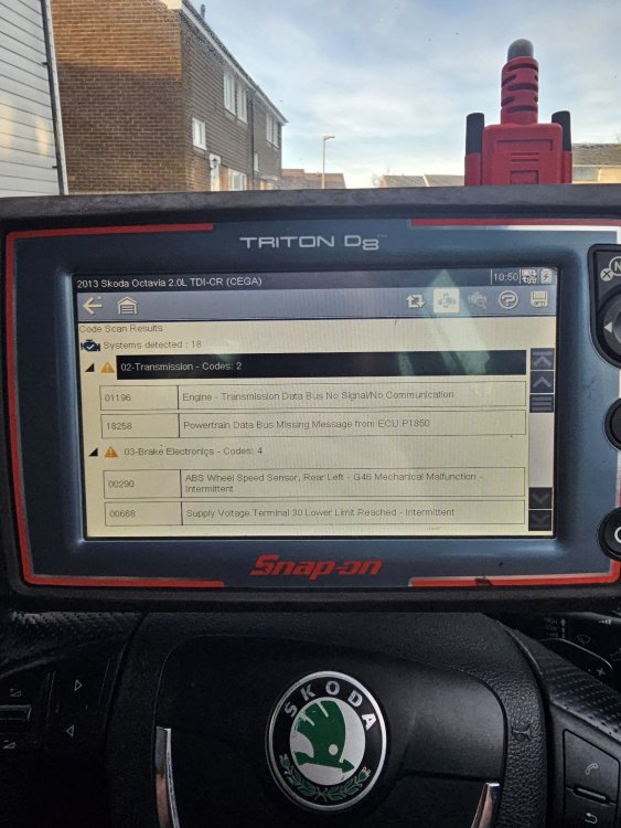

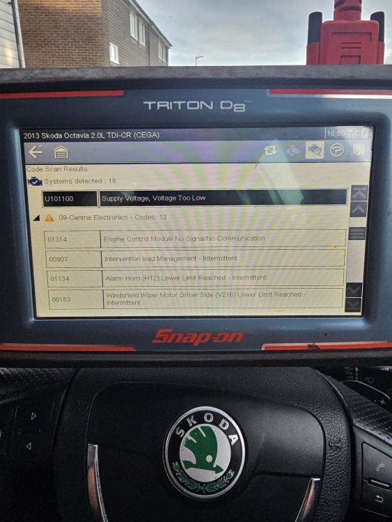

  2. Hi I'm new to this forum recently got a 2013 skoda octavia vrs estate automatic has got a electrical issue need some help or advice car broke down other day and wouldn't start got it back home got diagnostic on and took photos of faults which I will attach. Also check fuse box in engine bay the fuel pump relay was clicking continuously fan running whilst ignition off . Inspected fuse box and removed to of fuse box to reveal some corrosion on connectors what are your thoughts any advice would be really appreciated as would like to get back on the road lol
