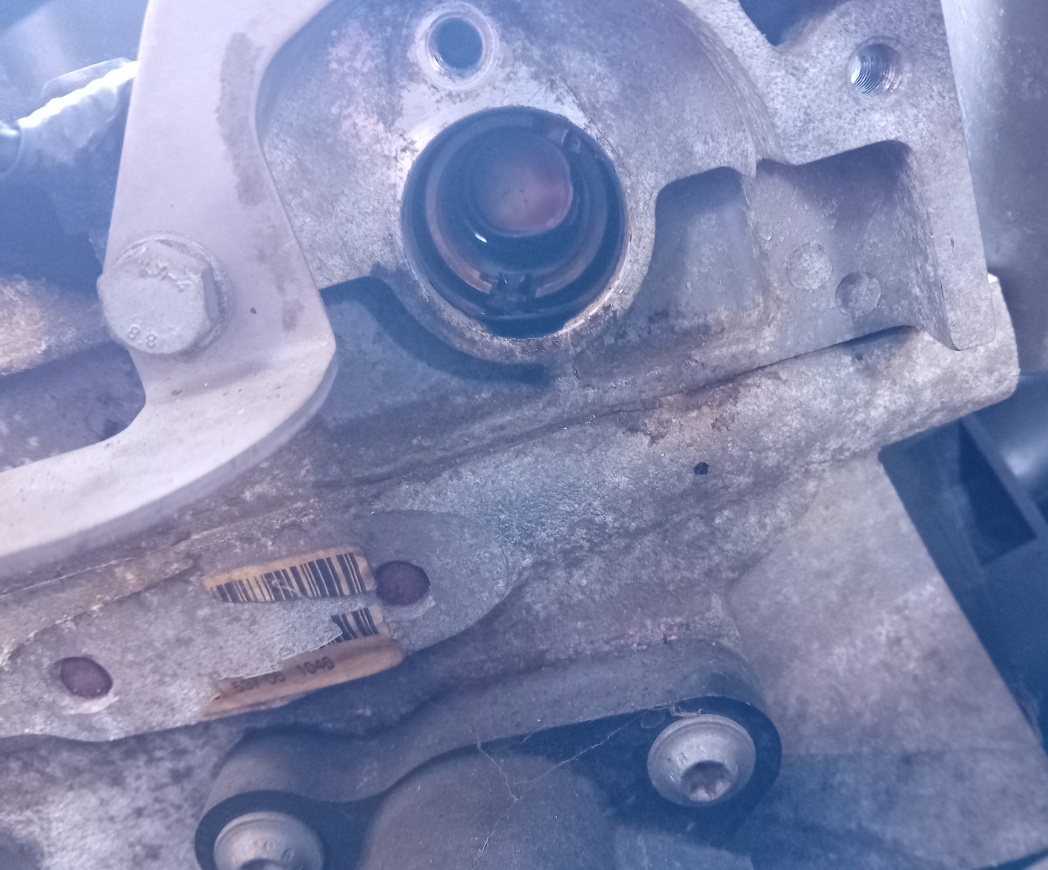

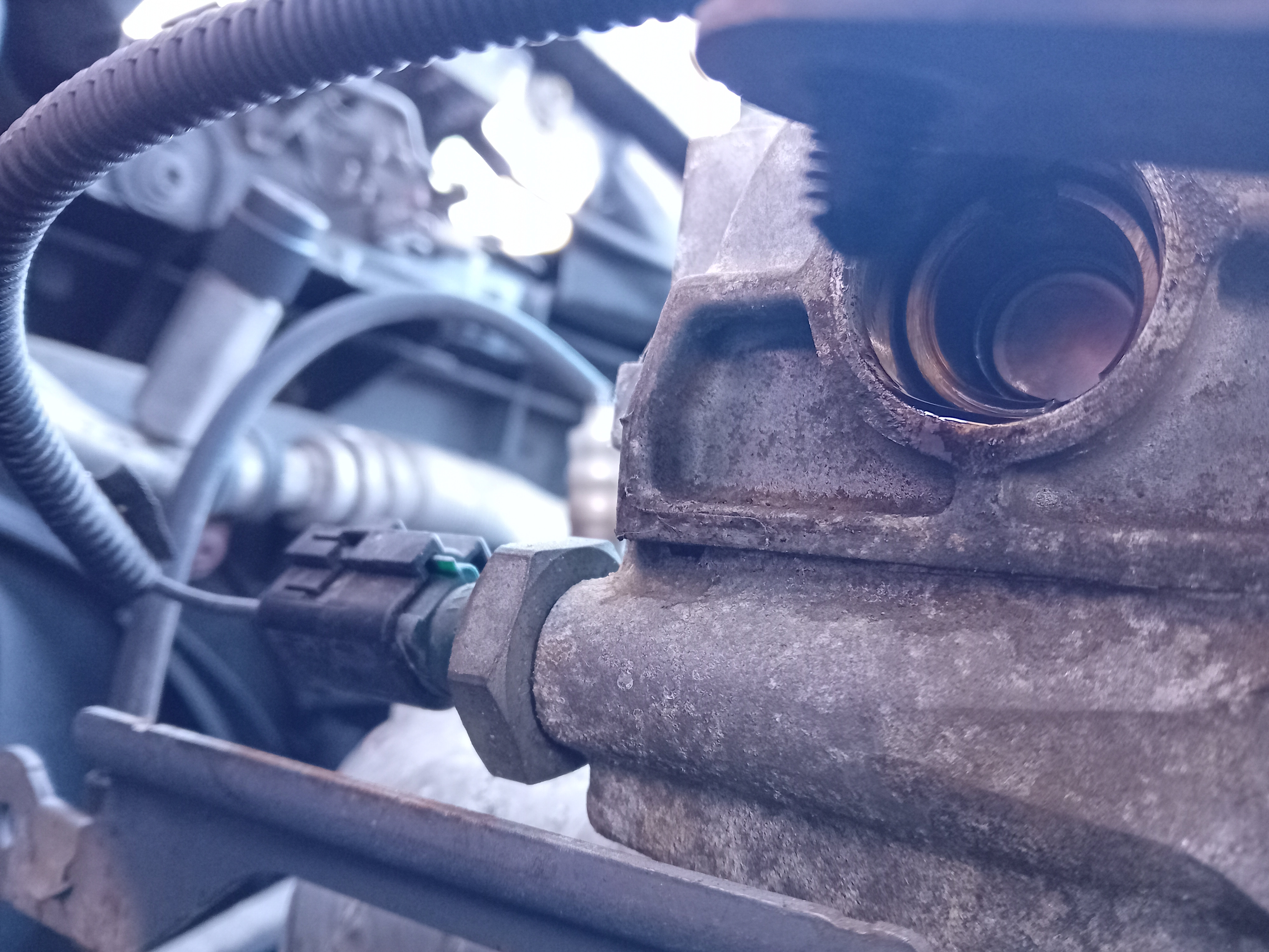

  6. So they should always be parallel with one another even if not at TDC? Thats the left one (best photo angle I could get) And thats the right one Very much not parallel with one another
  7. Crikey I wasnt expecting such detail thank you I might as well buy a full timing kit then and replace the whole lot while Im at it Ill use that parallel test at the weekend just to be certain of things because it would be gutting to take that cover off and find that somehow everythings fine
