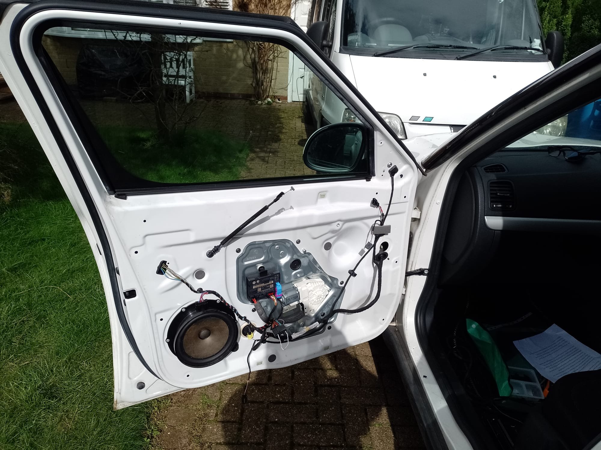

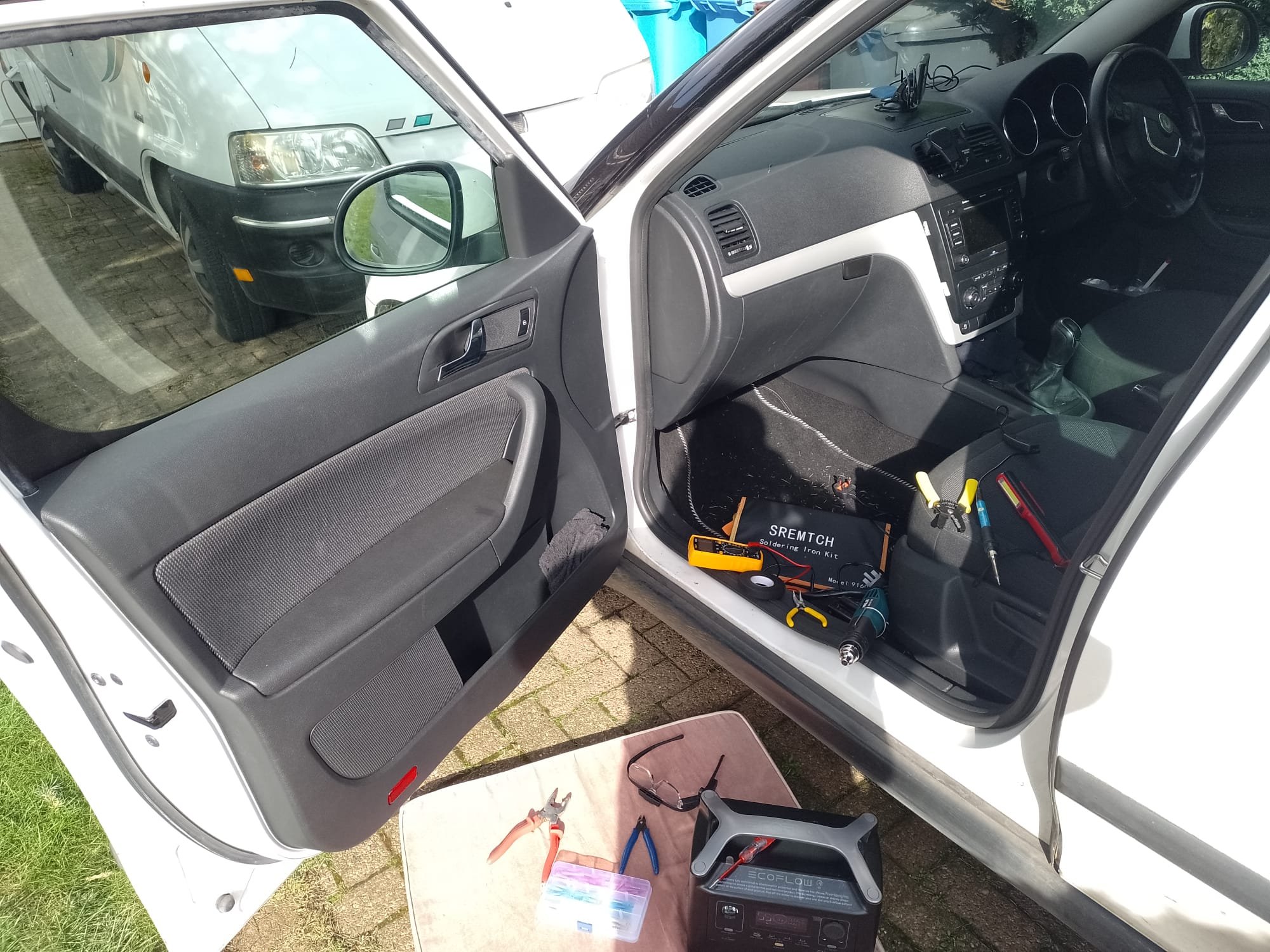

BOOM!!!....😃.....followed the above instructions - and after numerous click and groans with the initial setup (12v to grey/yellow and to blue) ...I reversed the sequence as suggested - 12v to the common green/yellow and 0v to the other two and Boom! ...the door popped open...as did my jaw! ) .....was finally able to access the cursed door loom and sure enough - two small snapped wires ....heck of a job repairing them as only had about 40mm of wire to play with but just about had enough to extend / solder and heatshrink .......doors (front and rear) now locking/unlocking...windows working...adjustable mirror and mirror indicator all good 👍 To say I'm pleased is an understatement ....first posted about this in December and its been doing my nut in all winter - no-one appeared to have ever had the same problem - or if they had there was no record of it and any forums/ youtube videos / facebook groups despite months of searching......... MOT due later this week so had resigned myself to automatic failure and hefty auto sparks bill .....last chance saloon - and it worked! Can't thank you enough Pete......absolute legend mate.....several virtual pints coming your way! 👊 🍻 Cheers!

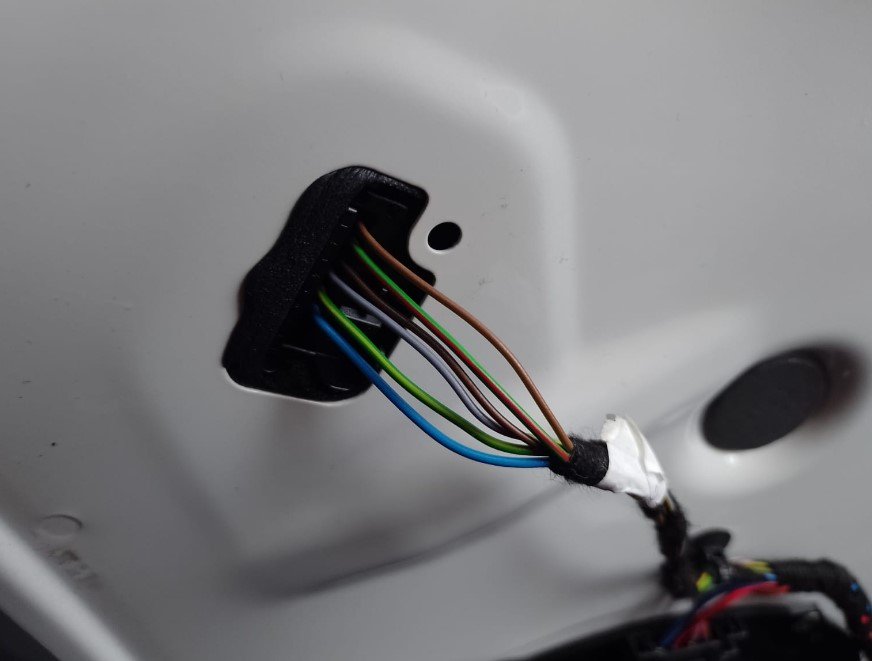

Yep (hopefully!)....unplug 20-way connector.....link thick brown to the common green/yellow......and thick red/yellow to the blue - and then the grey/yellow....- and then reverse that sequence if required......fingers crossed!

Preliminary test shows power to the thick red/yellow - and the thick brown earth also seems ok! ...surprised me as I assumed one/both of these would be damaged or broken in the door loom?.........the wires in the 20-way connector correspond with your description Pete - so that was reassuring! - only problem is how do I access the ends of them to test or apply voltage to them?......they are tucked up and under in the multiplug....am I missing something?.....apart from common sense! )

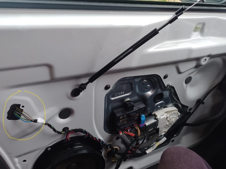

Unfortunately disconnecting the battery didn't work for me mate.............I have however managed to get the door card off (with the passenger set still in situ!) ....again I have very little 12v electrical knowledge but would it be possible to run a temp wire directly from the battery just to get the door to unlock?......if so which wire should I be running it to?...(see pics)....is the thick red/yellow the main feed? (im assuming the main feed is broken).... cheers
