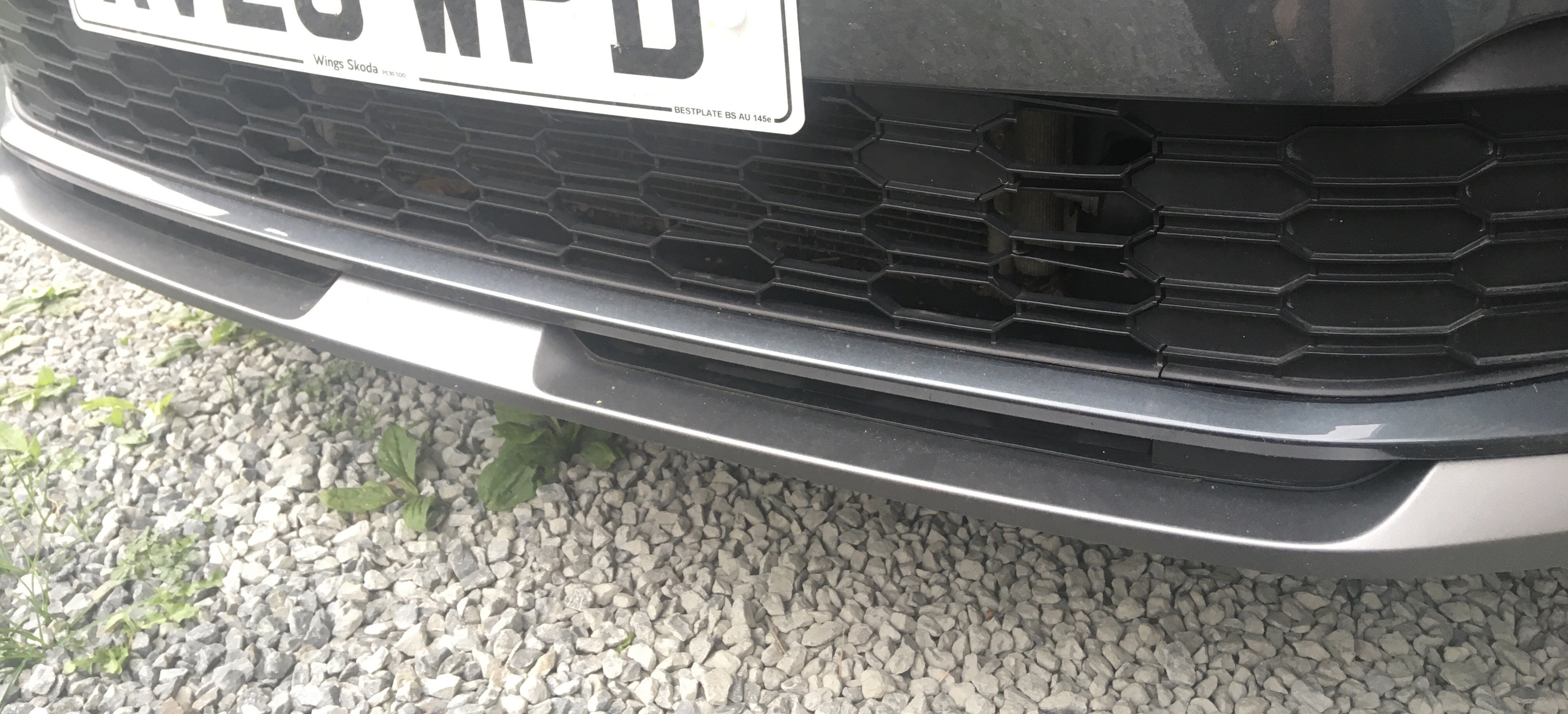

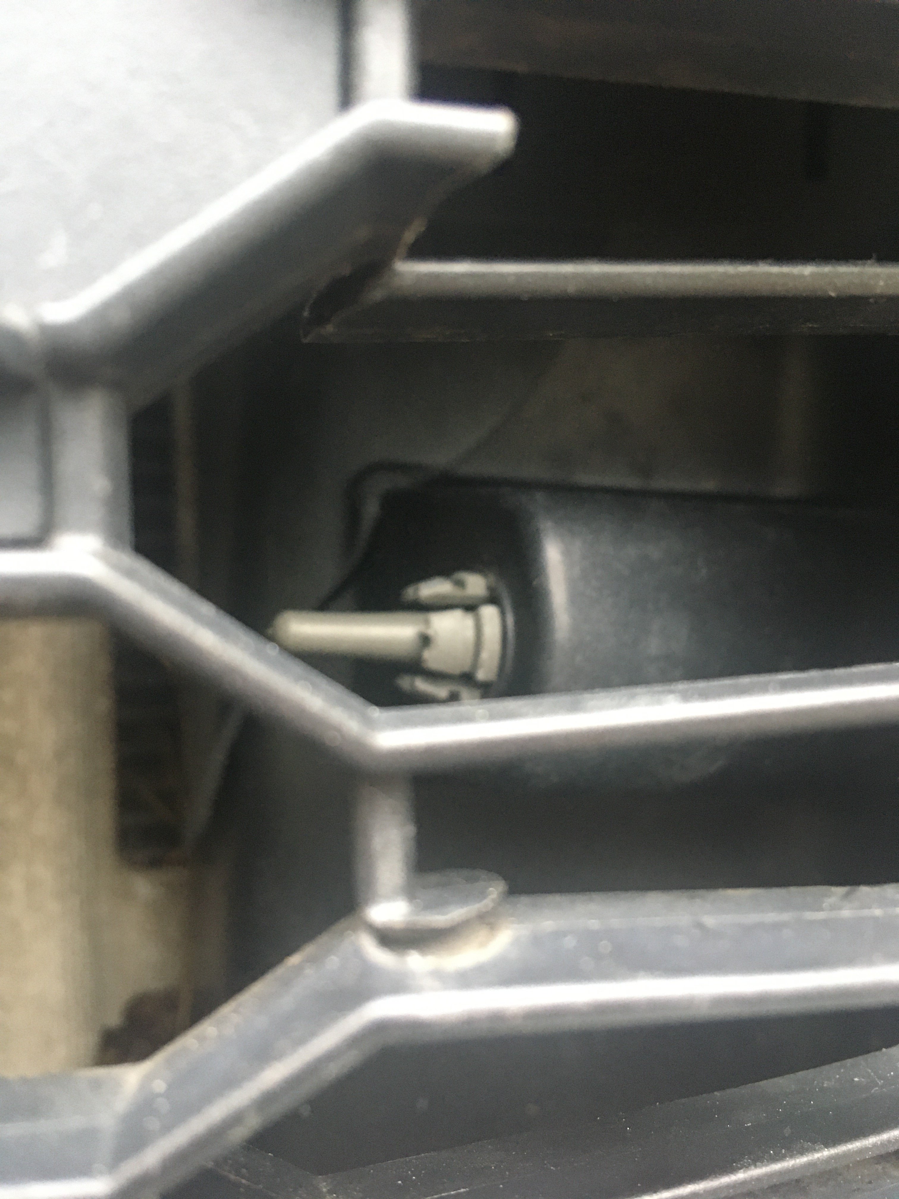

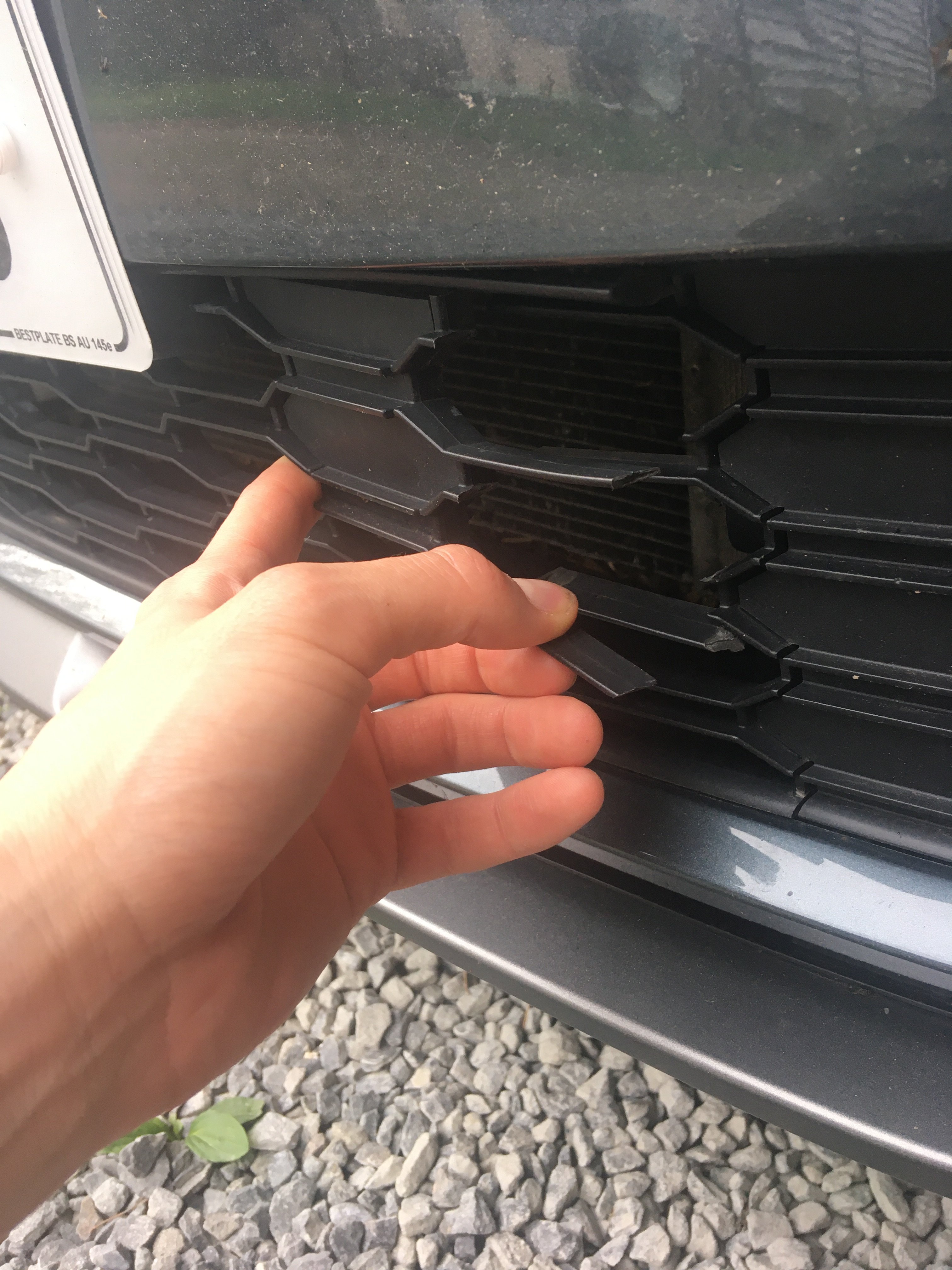

Help identifying lower bumper grill part
Hi, Annoyingly, someone has damaged and cracked the lower bumper mesh on my 2020 Skoda Kamiq and another plastic component behind it. As far as I can see, aside from the meshing the bumper doesn't appear damaged, but there is something cracked behind it as well. Can anyone help me with where to source the meshing/lower grill and what the broken housing through behind the lower grill is?
