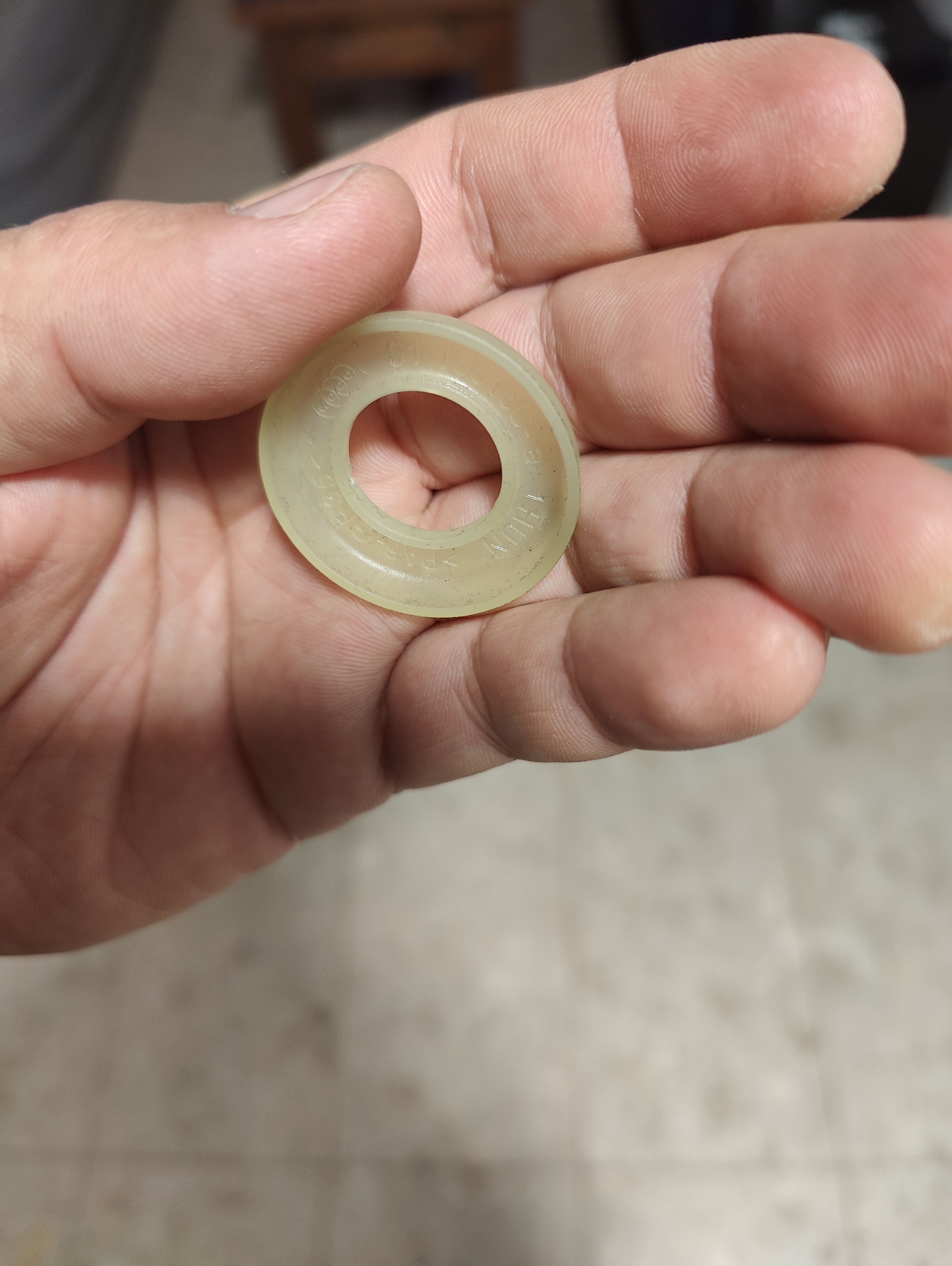

  8. I removed the plastic part that sits between the rubber and the spring in pcv head cover and its much better now. I've added a picture of the plastic part I'm talking about. The plastic probably too thick and spring is too short. When using it without the plastic part, its much better. Try this method and let me know
  9. In the authorized garage they wait for check engine light but there is none. Don't know what to do next cause they changed the pcv 3 times already and still same problem.
  10. Do you still feel suction on each of the two holes of the PCV head and have a "vacuum cleaner sound"?
  11. Thank You for the information! I'll keep you updated if I find anything about this issue. They changed 3 pcv's and still same noise. My brother has the exact same engine and his pcv is very quiet, no air vacuum from the pcv holes. But, the suction in the oil cap and the dip stick is still there. I don't have any idea why mine making the exact noise as yours in your very first video.
